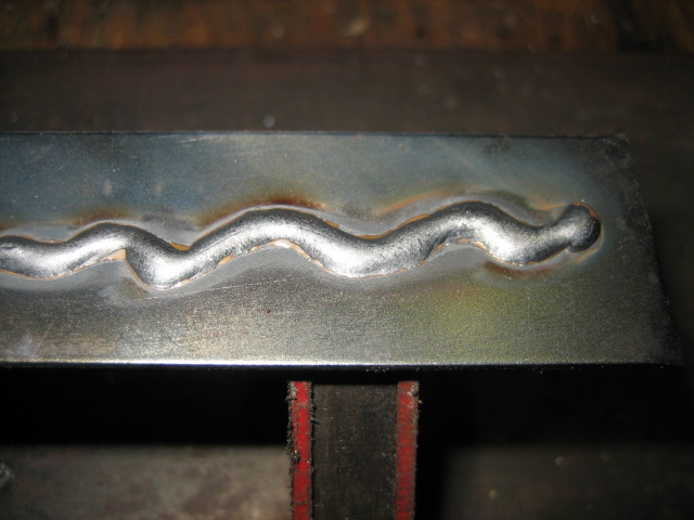

    Some of my early Dillon (a.k.a. Henrob etc.) work. 0,8mm steel, used filler where I had to, just fused the edges together where I had a tight enough fit - the center seam looks like no filler was used. I had a few hours of practice before I did this, no previous welding experience (unless you count five fluxcore spot welds).

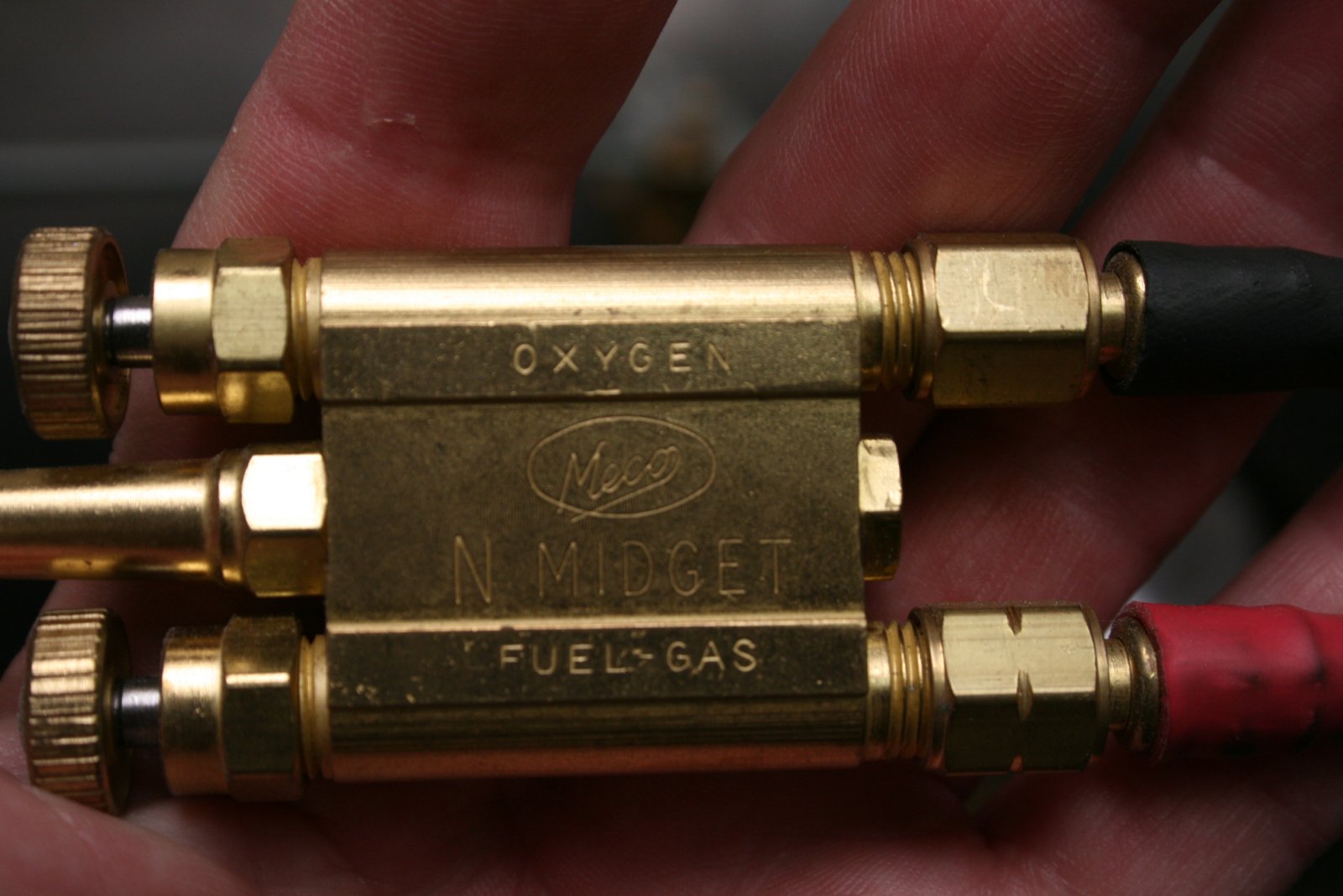

  7. ironrodder
    Joined: Jan 29, 2007
    Posts: 204
    ironrodder
    Found my Cobra last summer. Forgot I had it. Since I got the Meco Midget it's all I use on sheet metal. I could never get use to the Cobra. Just isn't comfortable to me. To each his own I guess.
