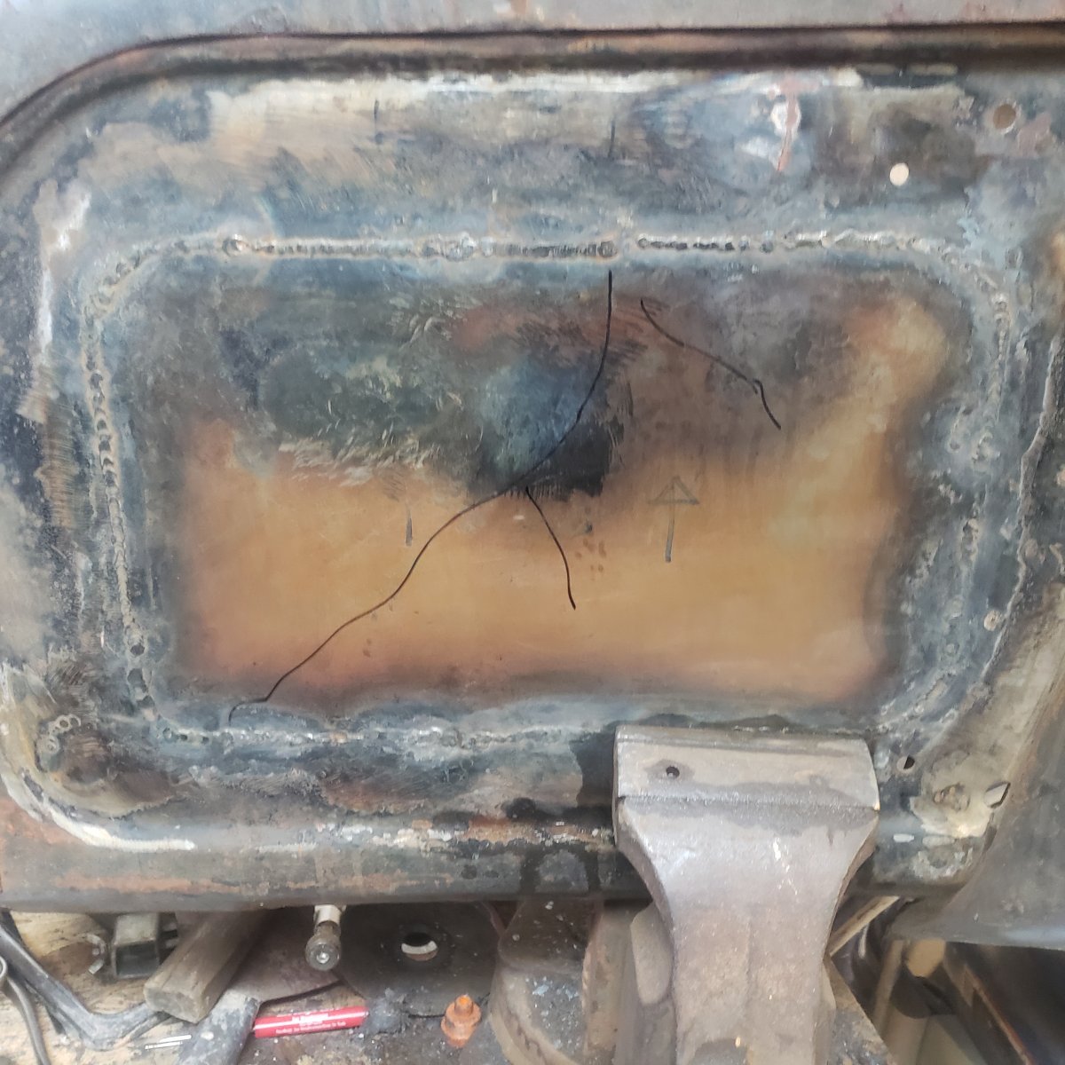

    curious how many still gas weld? i was told by a friend that if i wanted to learn to weld, buy a tank set up and practice. little did i realize, he meant practice, practice, practice, practice, practice.
    i am feeling confident enough to share my latest practice panel i finished up tonight. i have some more hammering to do as it has warped a little and i need to chase it out of the panel. i am not bragging and expecting weld**** to post it up on their fb page, but i am excited to see the lost art still going and challenging

    Your welds look good to me!

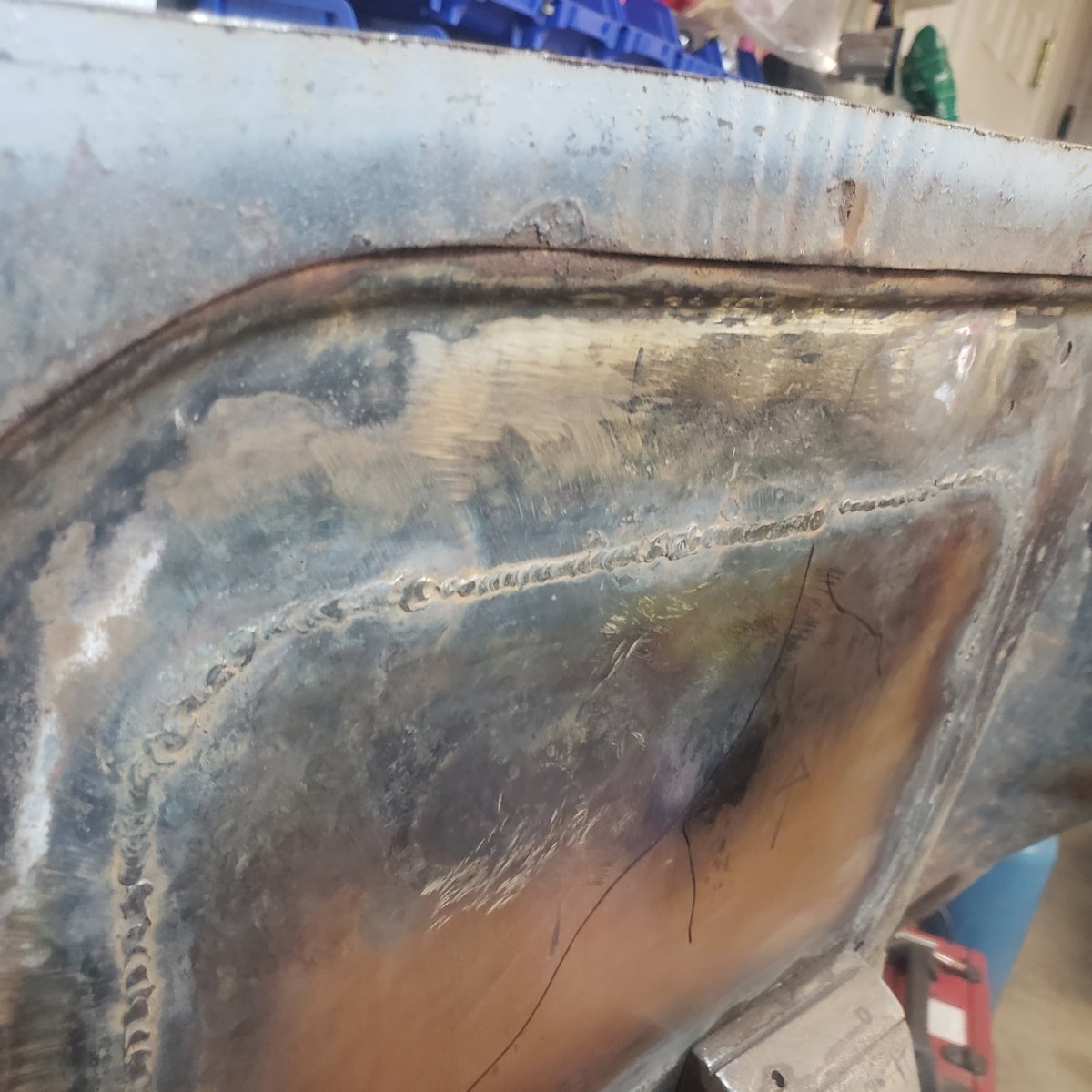

    heres some more gas welding ive done

    your welds look good and it’s another skill you have under your belt.

    i must admit it has taken a while to get my weld to look like this. lots of trial and error. many disappointing attempts were made prior. there were times of discouragement that had me wanting to take my truck to a shop and have someone else deal with it. practice and more practice have gotten me here. thank you everyone for the encouragement.
