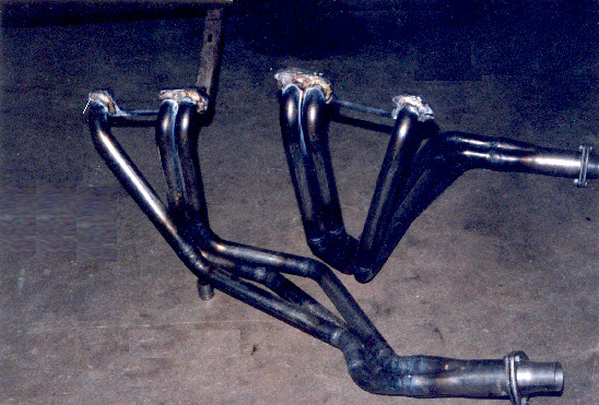

    Built these headers with gas.
    1-p1March_Meet_sunday_tim_166.jpg 7-25-2013 6-47-58 AM.jpg headers.jpg pontiac_3..JPG

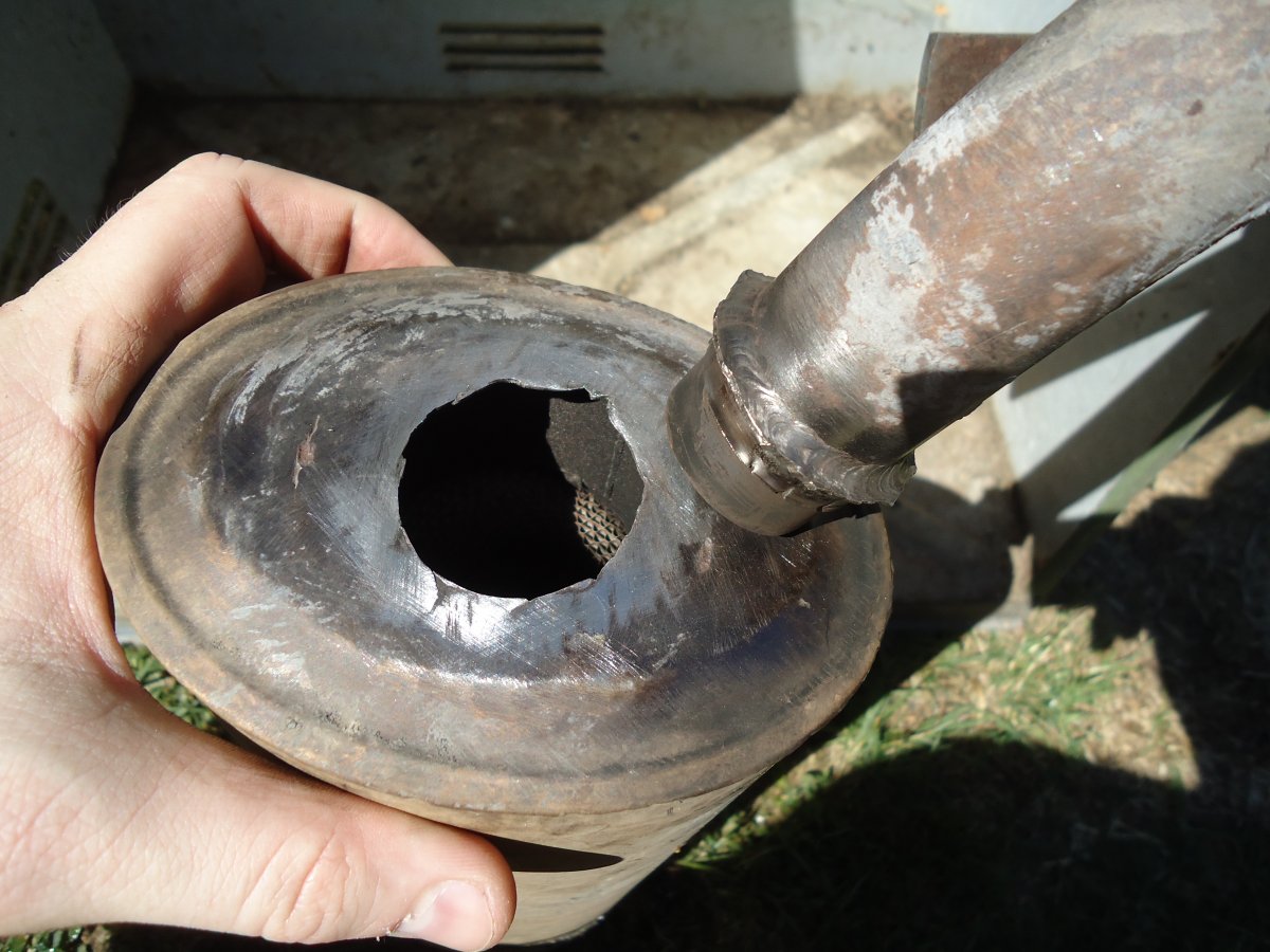

    Not sure those were a good idea, the stainless TIG wire worked so much better. Pic of a stainless muffler included, before and after repair (but w/o the reinforcements I added).
    Speaking of creative choices of filler "wire", old piston rings are made of high grade cast iron, and works excellent as filler for O/A welding cast iron. Here's a test I made on a s**** moped cylinder probably 8 years ago or so, I knocked off an ear on the intake flange and built it back up using piston rings out of a Briggs & Stratton lawnmower engine.
    I'm thinking that HAMBers may want to weld busted cast iron more often than they want to weld stainless, so it might be a more useful tip than the spokes.
