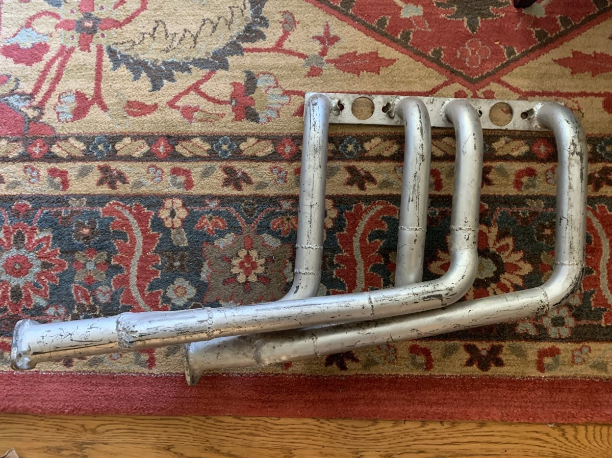

    This is a very neat thread. I've only used O/A for a little bit of brazing, but I can see how it would work well for welding too. Beyond that, I don't really have anything to add. This is the header that I'll be running on my Model A roadster. It's all gas welded, and it's clear that somebody put some time and effort into it back in the day. IMG_0810.jpg

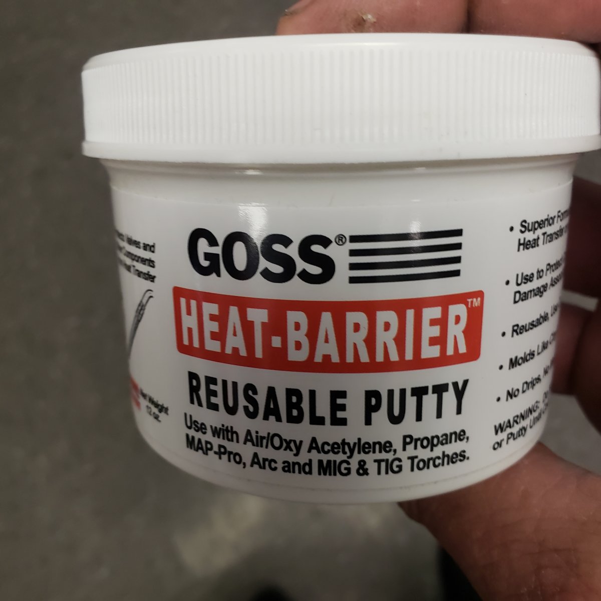

    has anyone ever used this, or is that considered cheating?
    loudbang, j-jock and chryslerfan55 like this.
  22. No, but I make judicious use of heat sinks. If I was doing a job where the putty would help reduce the warpage, I wouldn't hesitate to use it.
    When you mentioned cheating, I was hoping it was some trick that gave you super vision.

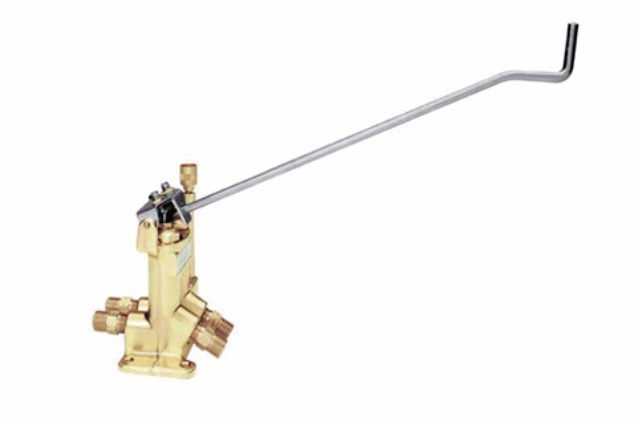

    I could not live without my OA rig. It was actually my grandpa's setup that I have added onto. Smiths torches, mostly the old Minneapolis made ones. I actually just bought a brand new in box 40 ish year old kit too. A gas saver makes hammering out shrink in sheet metal much easier.

    Would like to know, what is this "gas saver"?

    When I started at GM’s locomotive plant in ‘71 they had some water and oil piping that was silver soldered by hand. The welder would hang his torch on the gas saver, that would close off the flow of gas except for a small pilot light. Pick up the torch and you could quickly relight it, it is a convenience for the operator and conserves gas.
