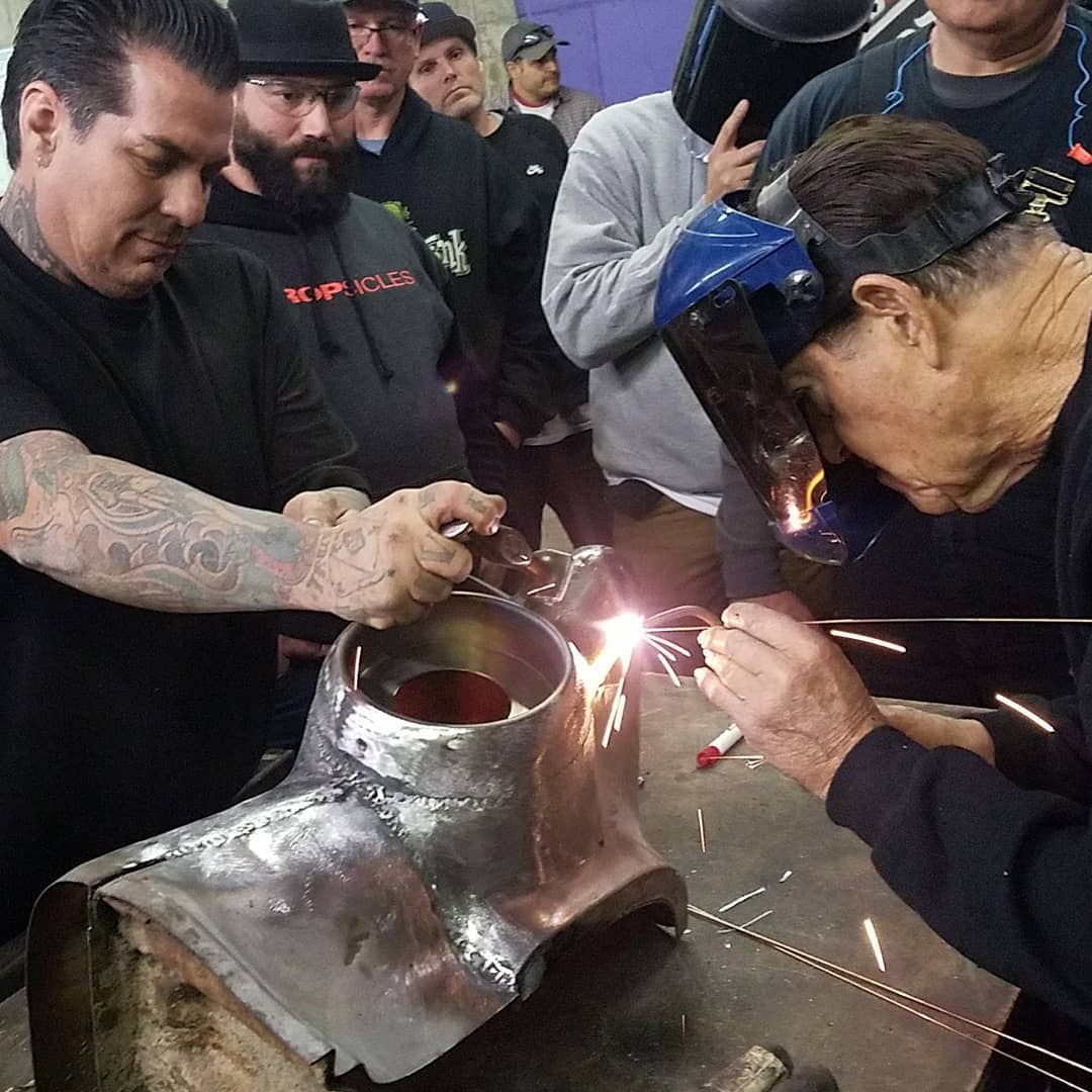

    Saw a video of Gene teaching a cl*** once where he had an ***istant standing by as he welded in a patch panel. He'd lay down maybe 1/2" - 3/4" of weld then hand the torch to his ***istant while he hit the bead with a hammer & dolly as it was still hot. Then he'd set down the hammer/dolly and take the torch back from the ***istant and lay down another short bead, give the torch back to the ***istant and hammer the bead flat; and repeated until the weld was completed all the way around.
