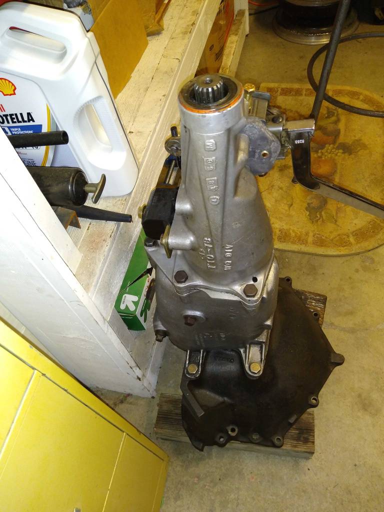

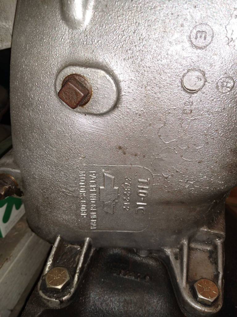

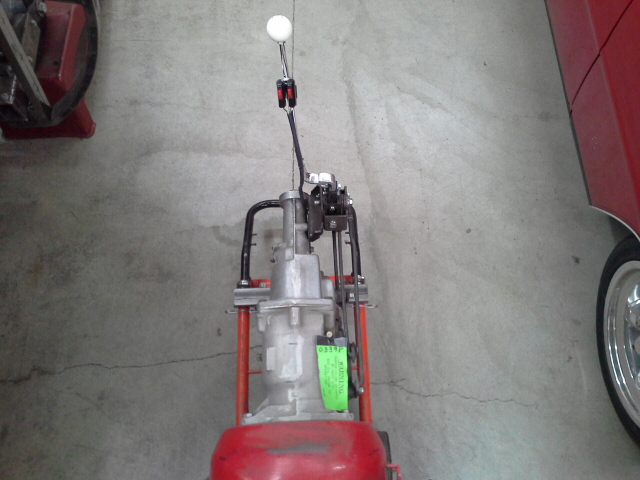

    I'm building a 36 Plymouth coupe period G***er, building a small journal 327 (forged internals) with a 6-71...600 hp on pump gas, 700+hp race fuel and more boost. The real question here is what 4sd trans will hold up to "wheels up" launches? I have an Aluminum case T10-1C circa 1961/62 with a 7B tailshaft. Can this be built up to handle the abuse? Should I look elsewhere? Doug Nash? Muncie? What are you guys running? 1577076505331.jpeg 1577076444020.jpeg 1577076472372.jpeg

    That early T10 is not going to hold up to the kind of abuse you're predicting. They were only rated at 300 horse or so. I believe most of the successful SE G***er racers are running something called a Hightower modified Toploader. Might be worth investigating.

    Consider a Richmond Super T-10, not bulletproof but none of GM's production trans will hold up if serious dragstrip duty is planned.

    Wheels up w/a period correct production 4spd will work, briefly. You're right in thinking it needs bullet-proofed. It's the reason most stick guys just move up to the current crop of race-ready units & move on. ($$)

    Yes you will be wasting your money on any Super T10 or T10&Muncie for drag racing
    the G force 101A is a great box! its also how you set your clutch up and with the correct slippage

    If you want to run a production trans, a top loader is your best bet. The aluminum case GM stuff is not going to hold up.

    A good adjustable clutch is whats going to keep the transmission alive, but that T10 isn't going to survive long with that much power going through it.
  11. The old T10 gears from that era are not very robust. Narrow teeth sections,,,compared to later models,,,,,the same goes for the cluster. When you compare the width to later models,,side by side,,it is painfully obvious.
    That is why they started changing the gear sets after that time period,,,mid to late 60’s saw an enormous jump in strength.
    Like the guys said,,,,,at the minimum,,,use a Super T10,,,,your pocketbook will thank you.
    And to be fair,,,on the track,,,,,,at your projected HP levels,,,it won’t last too long.
