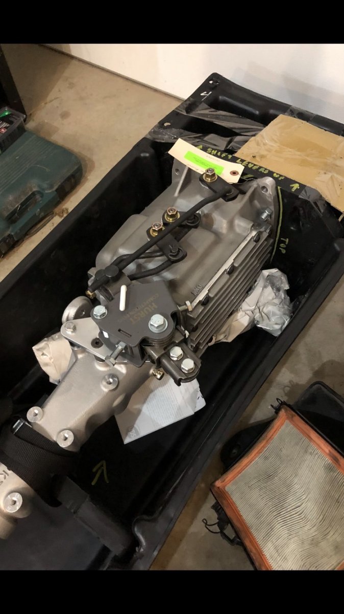

  2. I suppose you could just put a automatic in it? Me I happen to like dumping the clutch at 6 grand and wondering if the 318 Muncie is gonna explode this time.. I can change the trans before they get the mess cleaned up from the track.

    Look into autogear out of Syracuse. They make Muncie based 4 speeds which can handle real power.

    Run a poor man's Lenco, a clutch turbo. David Kee with sell you a big block input shaft top loader.

    Most of the Southeast G***er guys are running the Hightower or the G force. As for being period correct that's impossible to do and it hold up any length of time if you have much power no matter if a manual or automatic. We like the Hightower because he has one version that looks like a ford top loader so when a fan looks under the car that's exactly what he see's. G Force looks like a T 10 under the car so it looks correct also. It's the look everyone is after to be correct. I had a t 10 with Doug Nash gears that was 100% era correct and it shifted better than any of the modern transmissions do. If a manual is used and the clutch is used to shift it will still have to be man handled so it will feel era correct and the fans will love it.

    You would do better by calling Hightower. Liberty will fix a toploader and make special parts for one.
    If you need a period correct looking transmission. G-force or Hightower is your best bet.
    They are making a hopefully stronger input shaft for my top loader. The trans already has their stuff in it.

    Liberty started in the 60's and has been making 833's ... Top Loaders and Muncie's Bullet Proof since then

    X5 on a Hightower.. he will gear it to your engine also.. makes a big difference launching and pulling out the back door. cant beat the strength and are great folks to work with.

    Yeah Sega has no gs cl*** yet. I also have a 60's Jackson mechanical fuel injection unit as well. Automatics aren't as fun as 4spds, I'll probably start with a Ford top loader, maybe find something better used later. I'm not spending $5,000+ on transmission, maybe some other time...lol. I can only do what I can afford... I've already stretched that too. Also Thankyou to everyone who replied! Lots of valuable information here. I've learned quite a bit, Thanks.
