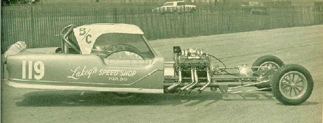

    The metros I always liked were the ones that all the front sheet metal was taken off and a front engine dragster frame under it. They looked cool ,and would be easy to do.
