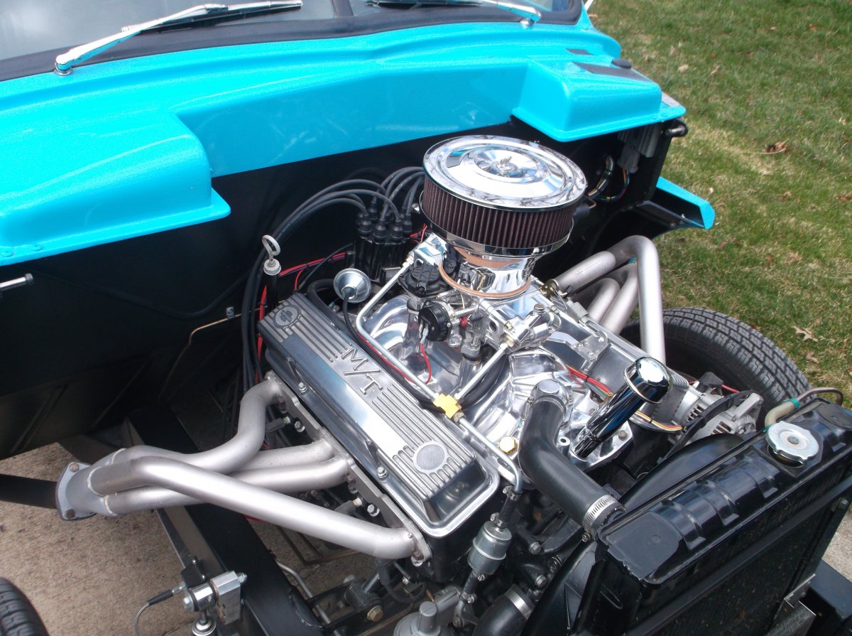

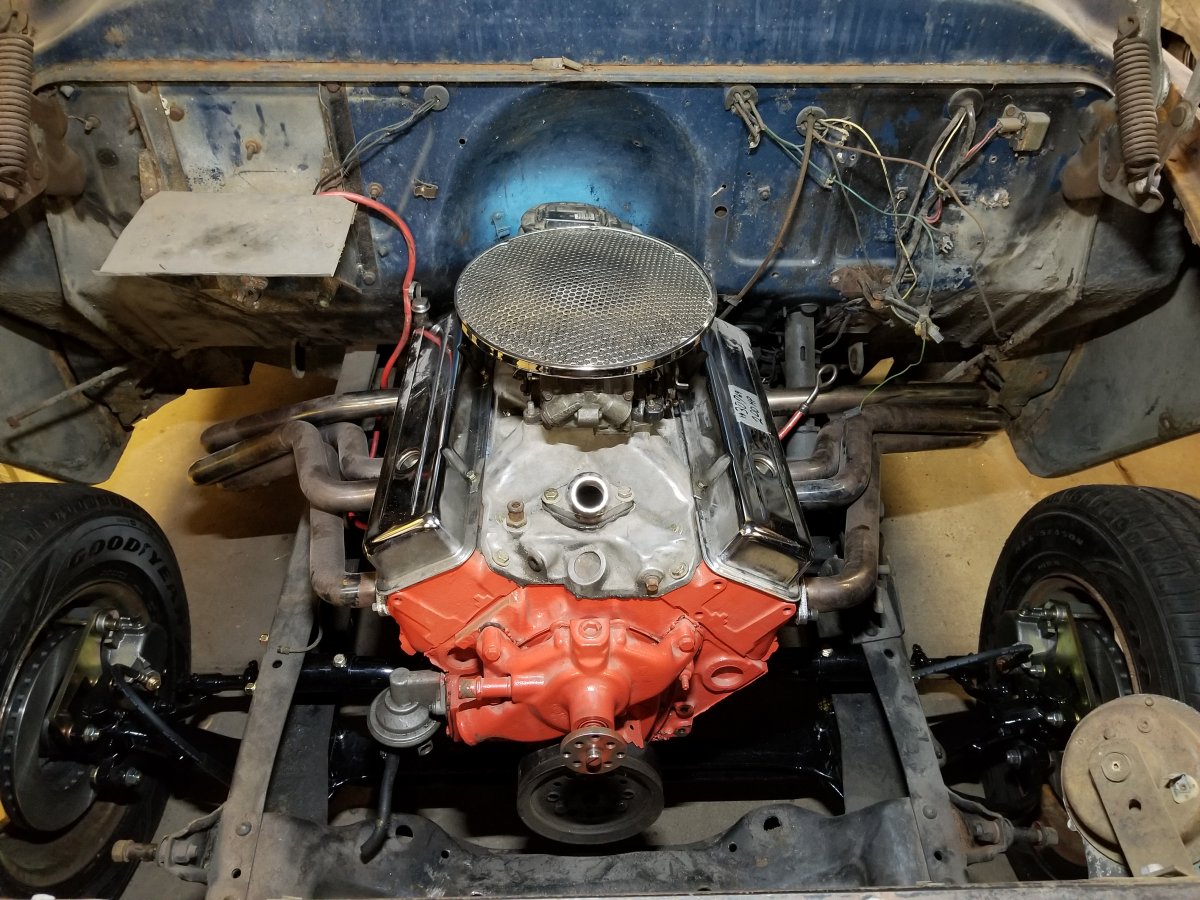

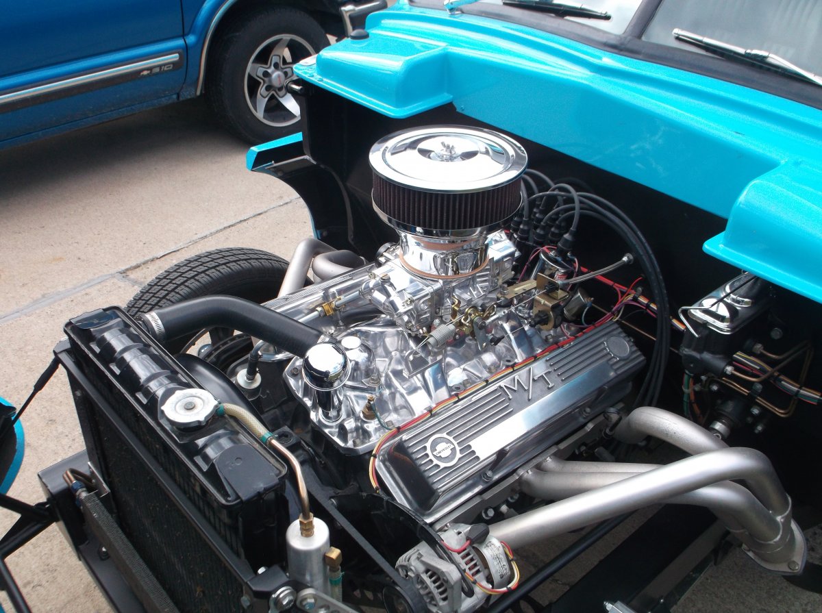

    Looking for header help for my 56 Corvette G***er. I am mocking up the suspension / engine etc. I had some headers that I bought at a swap meet but they are too wide. They measure 66" from outside of collector to outside of collector. Needs to be 61" or slightly less for the Corvette. Patriot makes a SBC Tri 5 header #H8034. Anyone know what the width of those are? Also Dougs makes a #D329 header for a Chevy II. As near as I have been able to tell, I think they might be too narrow. I would like to have the collector just barely inside the fender. I guess the next option is to build some. Possibley Speedway kit #41865600 or? Anyone have some experience in this area? Thanks!:)

    The ones I have on my Henry J are fairly narrow. They are from Advance Adaptors and are to put a SBC in a Toyota Land Cruiser.

    I believe these are the Patriot ones you mention. Had them on my '46 Chevy. Don't recall the exact part number,
    but I found them listed as fat fender headers... on the web it shows dimensions(?) to
    be 39" L, 21" W, 11" H. ?

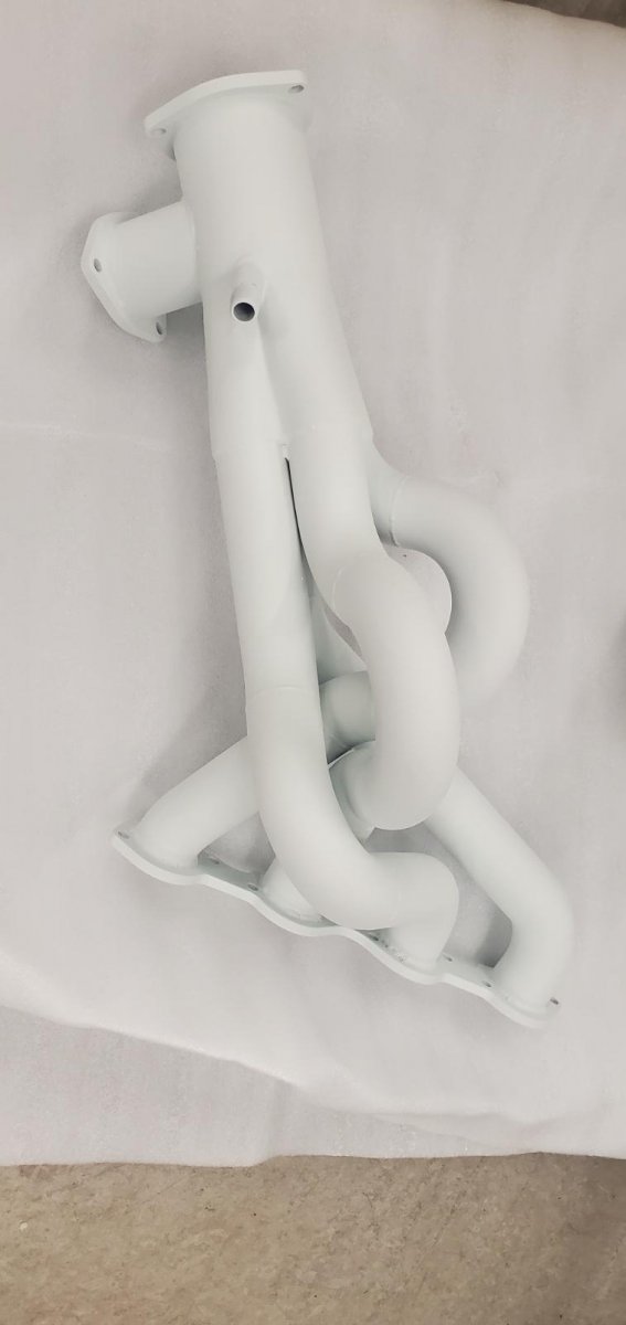

    Instead of buying a kit, just get a set of flanges, a pair of formed collectors and some u-bends or j-bends and build your own. My experience with the pre-bent kits is that I have to cut the tubes up to make them work, so I just start with u-bends. Here is a set that I just built for a '41 Willys. I was into this set for about $400 in materials. LYNN'S WILLYS (42).jpg LYNN'S WILLYS (43).jpg LYNN'S WILLYS (44).jpg LYNN'S WILLYS (45).jpg

    @SNS FAB, that's a beautiful set of headers. What did you coat them with? White paint or ceramic coating or??:confused:
    Thanks!

    I had Jet-Hot coat these.

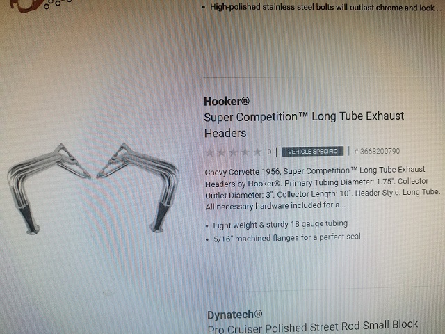

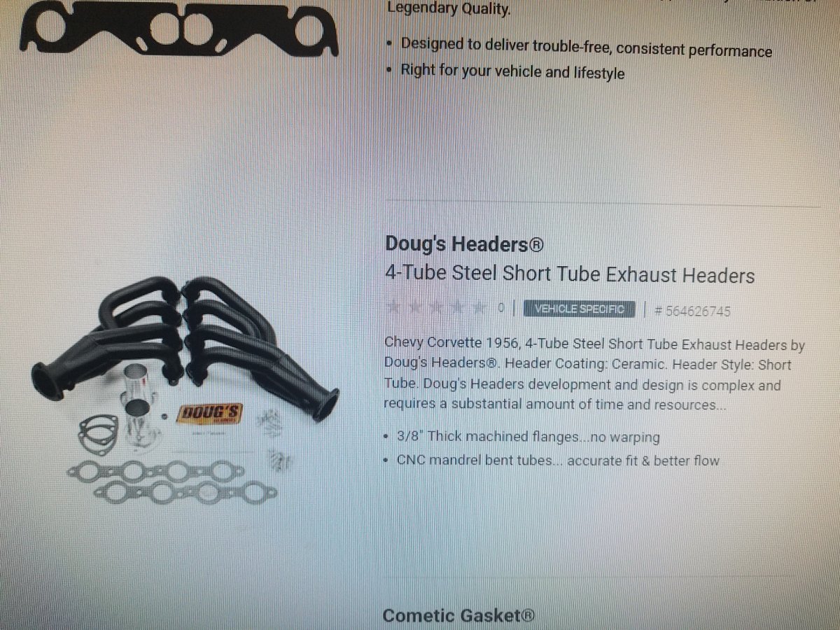

    Swade41... Where did you get the fat fender ones on your car? do you have a part number? do you have a measurement from outside of collector to outside of collector with them bolted on the engine? I'm guessing about 60". Those or the "Speedway Stock Clip" might work. That would be the cheap easy way out. Maybe I need to put my big boy pants on and build some. I've done that before but remember the long hours it took:confused:
    I talked to CARiD this morning about the ****** Super Comps. I'm not getting the warm fuzzies about them.
    In the Pic above, looks like the Dougs #564626745 are BBC

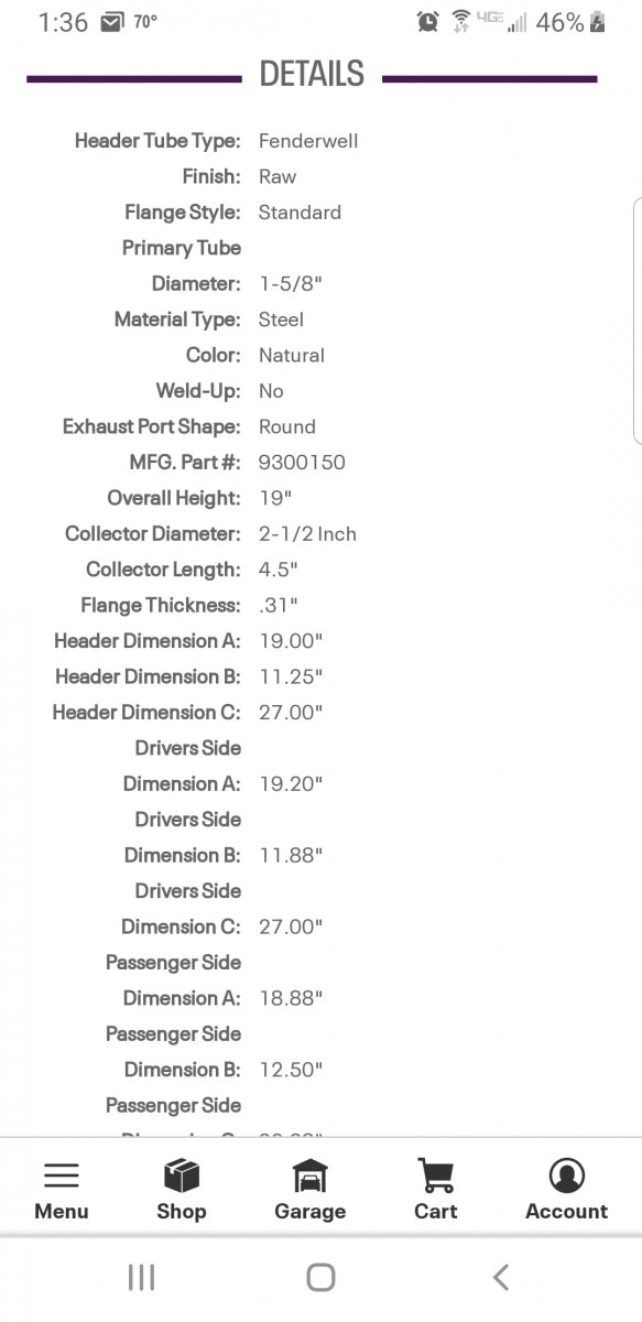

    I don't have a total width measurement on any of them, I do know that those Mr.Gasket headers interfere with my tires turning radius on my 57 p/u. I think I have those bolted to an engine on a stand, if I think about it I'll measure those next time in the garage but I'm not interested in unbolting both sets of headers and swapping them around to measure then swapping them back lol
    Here's Speedway's fat fender measurements off the website, you only need to measure your engine to figure out the total width.
