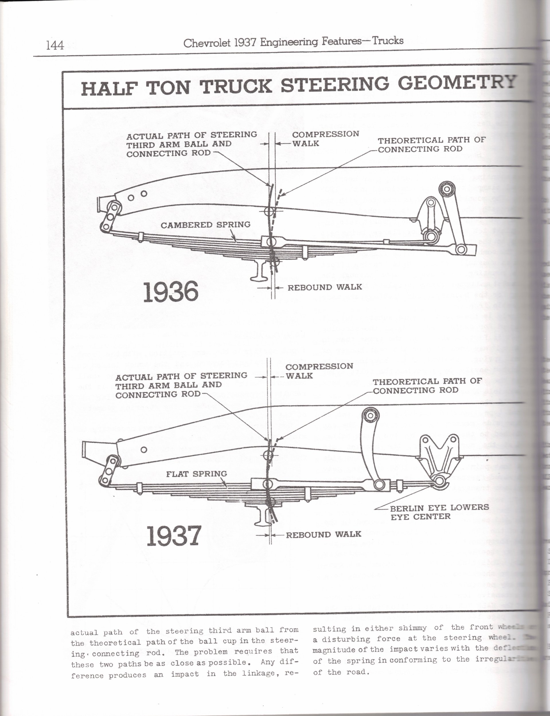

    Shackles in front are likely for better steering. Here is a page out of the 1937 Chevrolet Engineering Manual which highlights improvements over the years of Chevrolet trucks. The picture shows how much less bump steer the '37 has over the '36 model due to steering redesign. With a solid rear spring mount, the axle travel arc is close the same as the drag link arc. If the bolt was in front, the arcs would be opposite. 37 truck steering.jpg

  15. 1971BB427
    Joined: Mar 6, 2010
    Posts: 10,139
    1971BB427
    from Oregon
    Not much of the info for old cars or trucks applies to cross steering as most guys use in a solid axle install for a g***er. All those old cars and trucks used side steer with push pull drag links, not cross steering.
