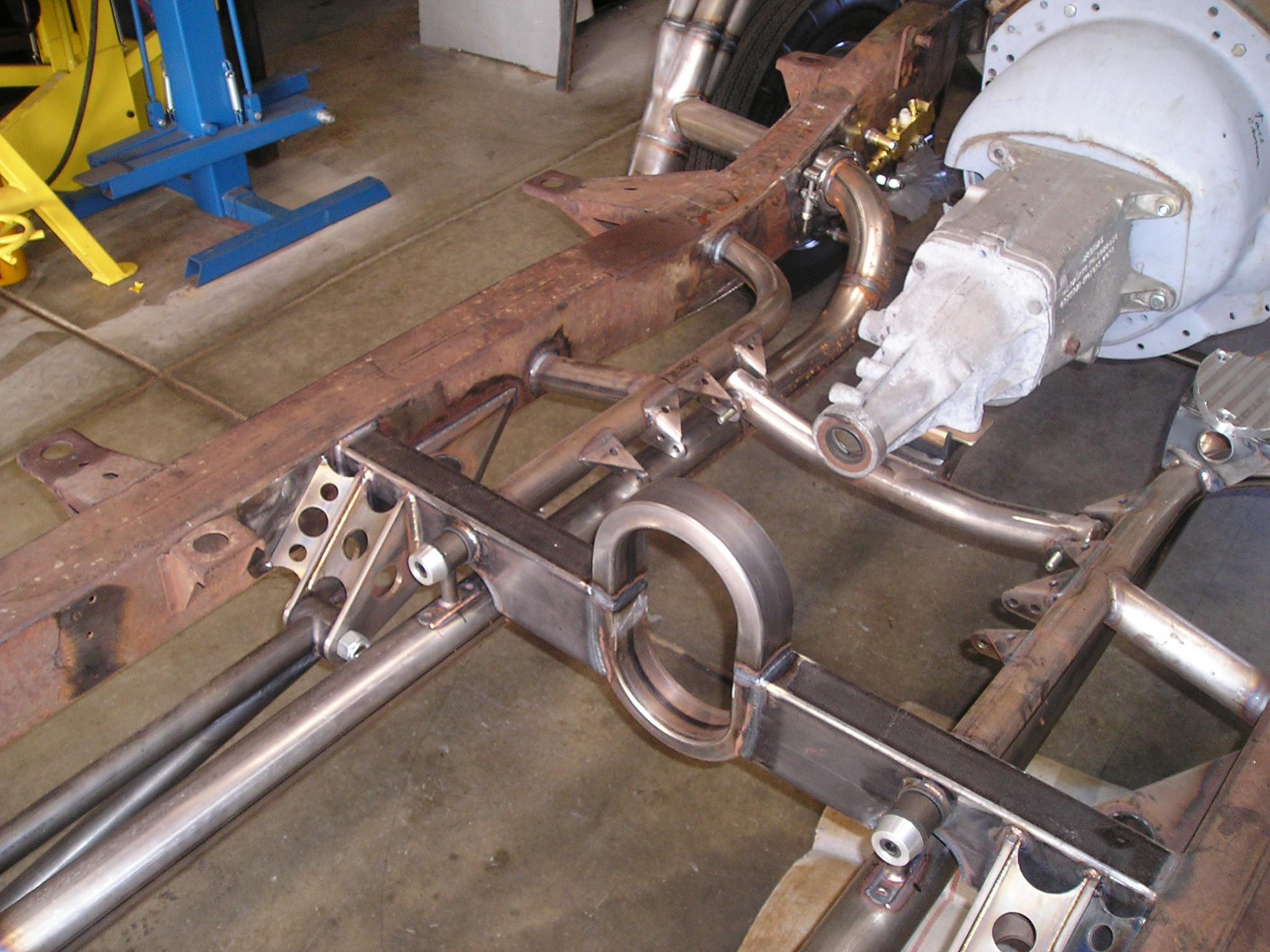

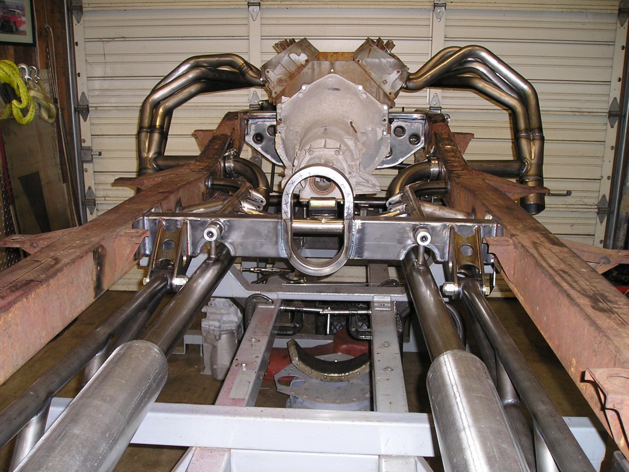

    Have your local muff shop/pipe bender make some tight 90's and weld them to the bolt on collector. It's tight ... but it's better than blowing a hole in the side of your headers. This set up on our '56 was run inside the frame rails. Plenty of ground clearance and it did't even have an axle under it.

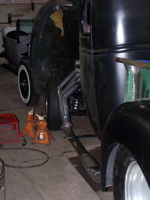

    here's what I did on my truck as far as the pipes go, a little dark but here's the header to reducer to pipe
    I used Dynomax bullets
