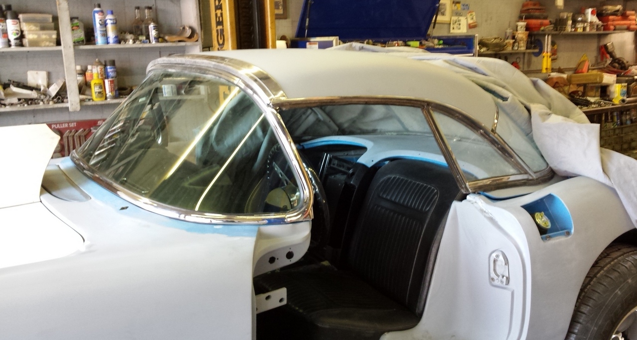

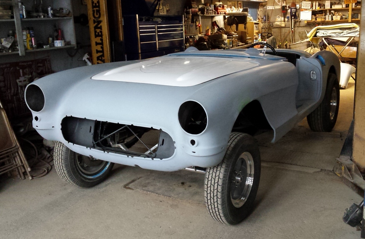

    Been working away on my 57 Corvette. Motor is going in this week-end.

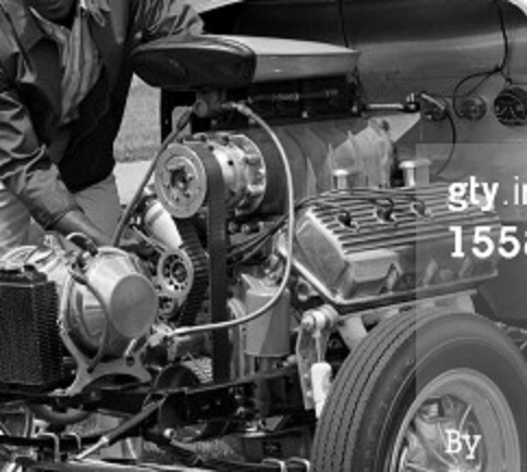

    Hello Don and fellow G***ers. I started reading this from the start, looking for a set of Halibrand spindle mount Sprints. I see you are out of So. Cal. I have Ernie Nicholson's 41 Stuedbaker Super Stude, Tony Nancy did most of the work on this car , and wanting to get it back on track in Pamona or March meet in Bakersfield at the latest. I need front wheels, early Donovan valve covers for late model Hemi, and early small Barn Door Injection by Enderle. Sorry to but in, im having a problem finding these three items. Sounds like your also into the G***er too....Thanks Ted McClure g***erted@yahoo.com Im in Las Vegas, Nv. Here is a pic of the Engine.

    And welcome to the g***er thread as we need fresh guys to keep this going, and with your car you are going to fit right in
    I have been away from the racing deal for 30 yrs now, and do not have any links for speed stuff anymore
    You have a serious car there with that huffer on top, hope you find the parts you are looking for

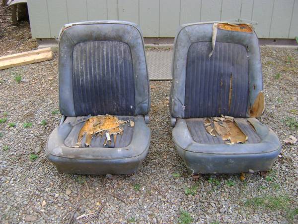

    A g***er must have cool period seats.
    Picked up a pair of 68 mustang buckets today for mine Craigslist 68 Mustang seats 1.jpg
