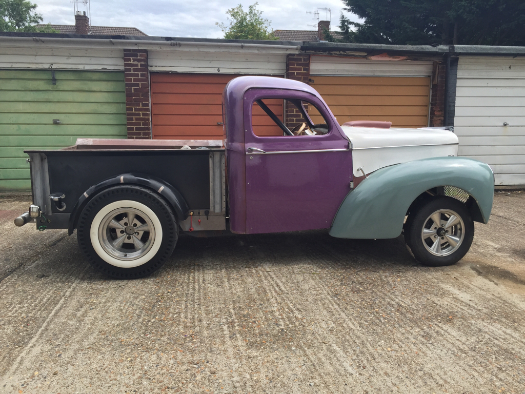

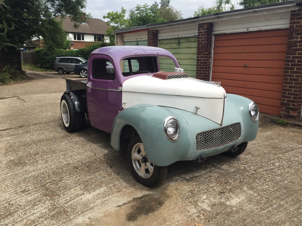

    I'm building a 40 Willys pickup with a 4/71 blown 292 Y block for Sue to run

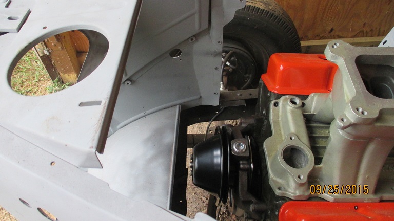

    My 39 Hudson is about a week away from being in the garage which has been occupied for months by house projects.
    That doesn't mean I have been idle. Working to determine what issues I will have sliding the SBC in there. Going to need a short water pump for sure.

    Hey Langy your pick um up truck is looking very cool !!!

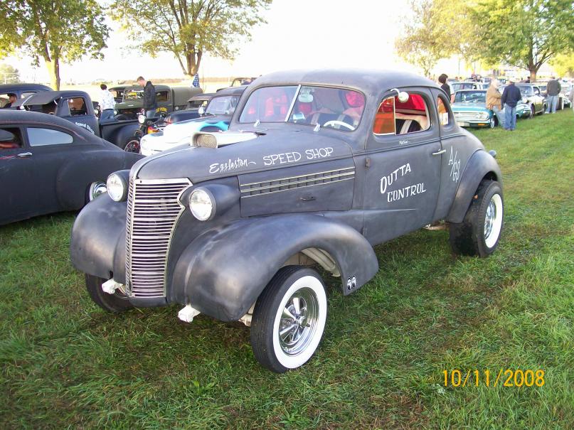

    hunnert08.jpg Don,...shootin for somethin along these lines...

    Dave that water pump looks like it fits ok, are you going to run one of those electric fans or the stock one
  18. DirtyDave
    Joined: Sep 30, 2011
    Posts: 1,528
    DirtyDave
    Not thinking electric. Were there electric fans back in the day? Was thinking 4 blade, obviously have a top to bottom centering issue at this time.

    Rusty that 38' looks pretty cool , but maybe a bit too much white as in the frame and tires
    You know my car was a 38' when I bought it but liked the 37' grille better, and a shop close by had a brand new grille - trim strips and center section so I had a 37' in a few days

    Opp's I was having a senior moment there Dave, not thinking that far back as now days the electric fans are the in thing i guess
    Can you cut out that curved sheet metal panel for more room that's right in front of the pump ?

    Those might be early Radar wheels
  25. falcongeorge
    Joined: Aug 26, 2010
    Posts: 18,339
    falcongeorge
    from BC
    I have seen them on a number of cars recently, I have a hunch someone might be making them new, or at least, that's what I am attempting to find out. They were on some guys Henry J on here a while back as well, and I have seen them on a couple other cars.

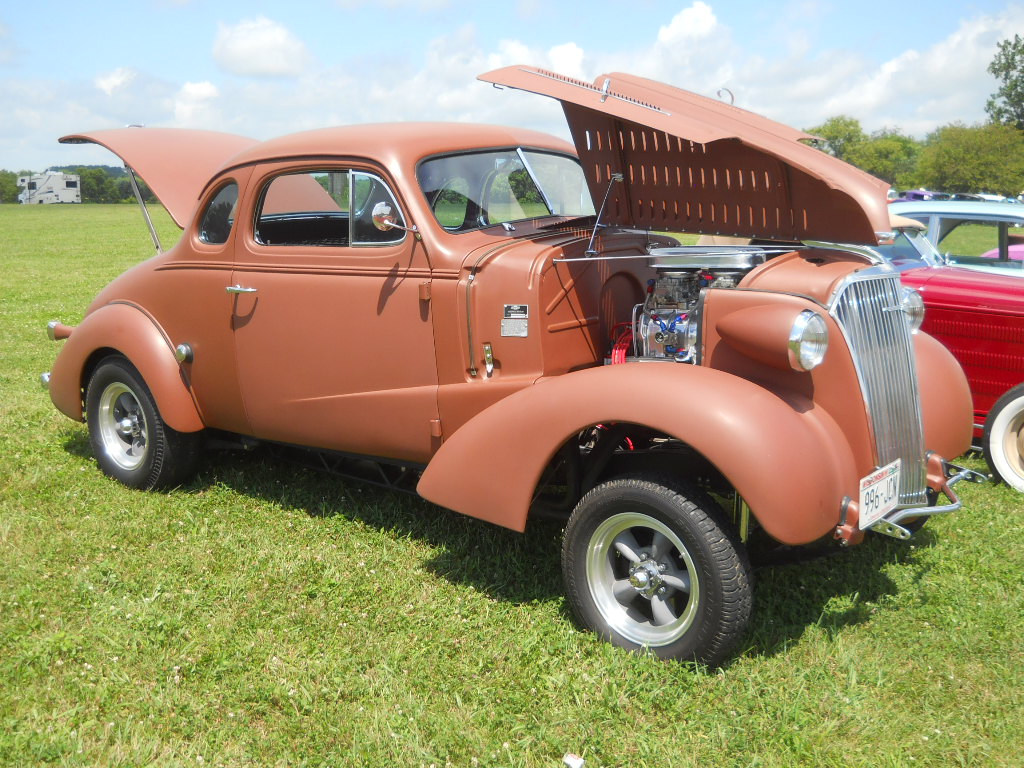

    meltdown 15 018.jpg ...maybe more like this ...
    enloe, 33sporttruck and Finn Jensen like this.
  27. D.N.D.
    Joined: Aug 15, 2012
    Posts: 1,385
    D.N.D.
    Rusty that one is very clean maybe some large cheater slicks on wider mags, with the fenders cut and rolled under and you would have the correct look
    First time I have seen louvers on a 37' hood , kind of different looking
    Wonder what color it is going to be ? plus chrome window frames so he is on the right track

    The are Radirs George rear 10x15 front 4x15, they are quite old
  29. falcongeorge
    Posts: 18,339
    falcongeorge
    from BC
    Thanks Langy, well, not the answer I was hoping for, but, hey, You cant always get what you want...:D

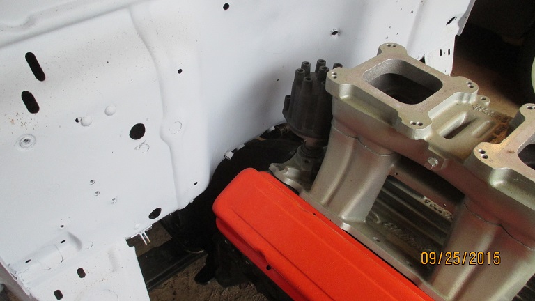

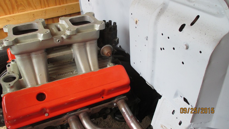

    The car as shown is sitting in a small barn out back with a foam small block and a gutted trans shell. This allowed me to tinker and design for months while I other things were occupying the garage. Obviously there is a downside to that, minimal industrial work, jacking etc.
    The trans is sitting on a stock Hudson cross member limiting the height and depth changes until it gets indoors next weekend. The engine will set back an inch or more without cutting the firewall. After that slight firewall mods will be needed to get it where its needed.
    As for the curved tray in the nose, a cross member below it wont allow any gain in that area. I have 18 x 22 opening for radiator in shell and I have found off the shelf solutions.
