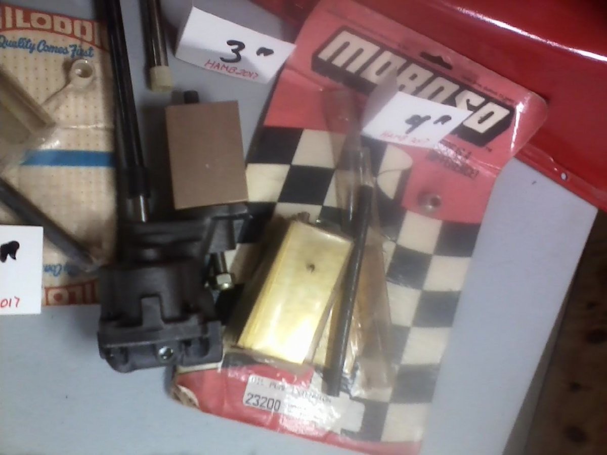

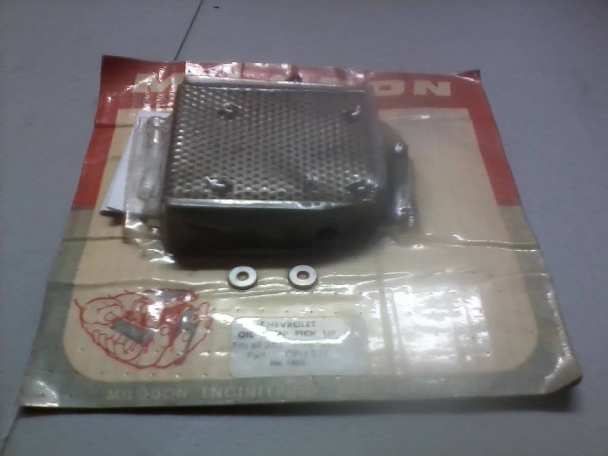

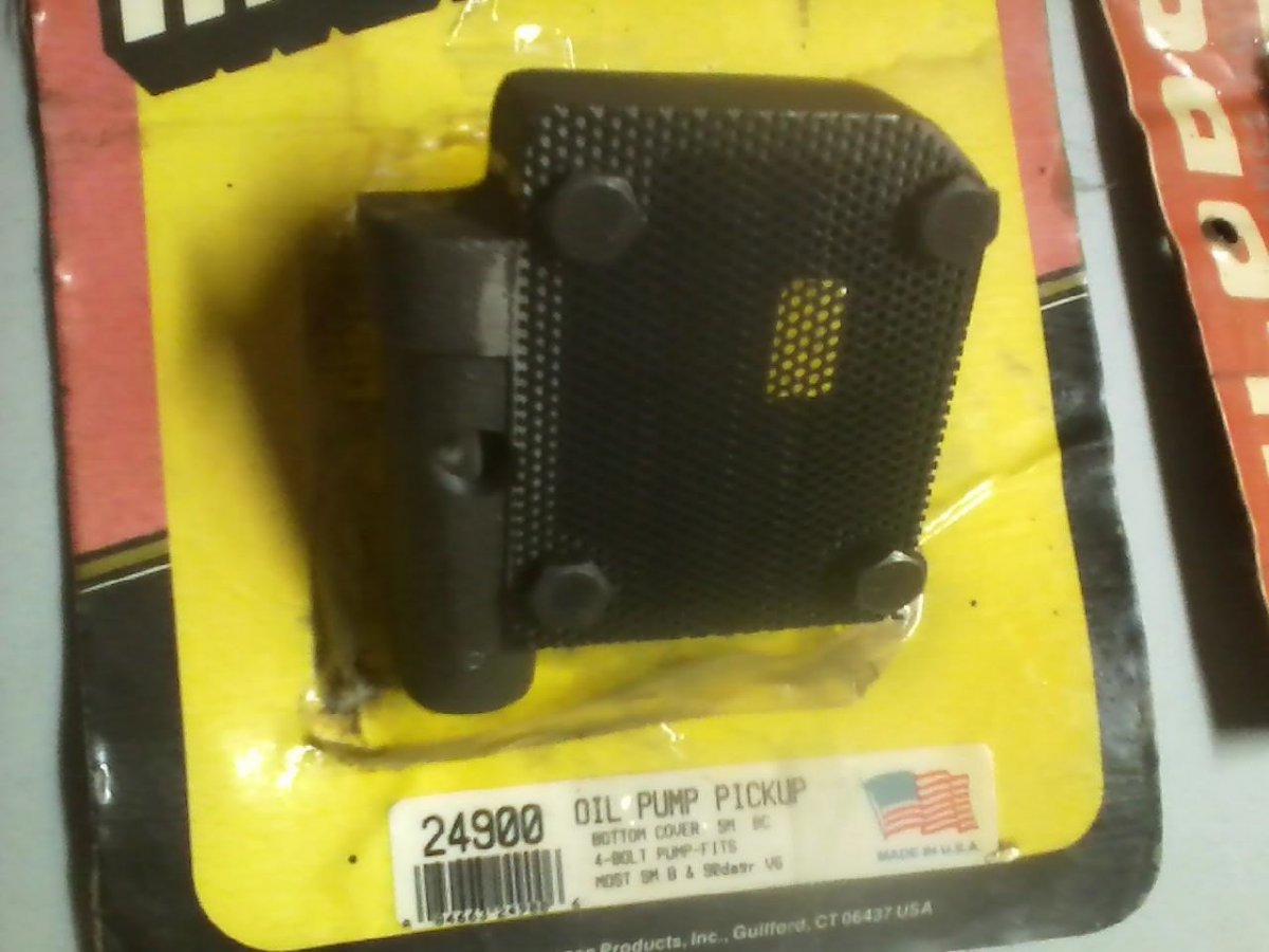

    more pictures of oil pump drop extensions...
    10-1/2 inch DEEP 8 quart 4" added oil pans...
    And those Bottom feed pickups
    Just Left over from the RACE days ...

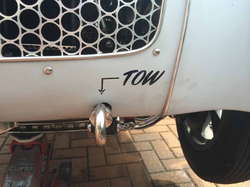

    What about a front tow hook?
    Without a bumper we should have an easy place to wrap a strap to get us off the track on a bad day.
    What did they use back in the day?

    When j was researching I saw all sorts of bits of metal screwed onto the front bumper mounts, I went with this in the end as it looked neat and j saw a lot of them

    Is it a hook or a loop?

    It's s loop Dave, you see them everywhere here, I found a stainless one so gave it a polish

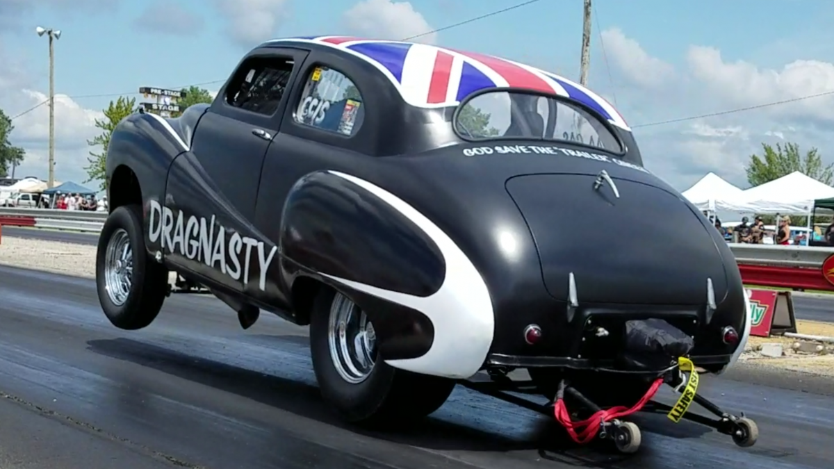

    I got the wheelie bar pics from a few early 60's pics. They are semi elliptic springs cut in half and held in place with U bolts
    I did notice a few early pics where the ladder bars were mounted on the rear ch***is rails, never could see how that would work ???

    I plan to make new leaf pads to hold the semi elliptics. Doubtful this car will ever wheelie. I bought some cast steel wheels. Maybe get that done soon and share pics.
    I wanted a tow loop, thanks
