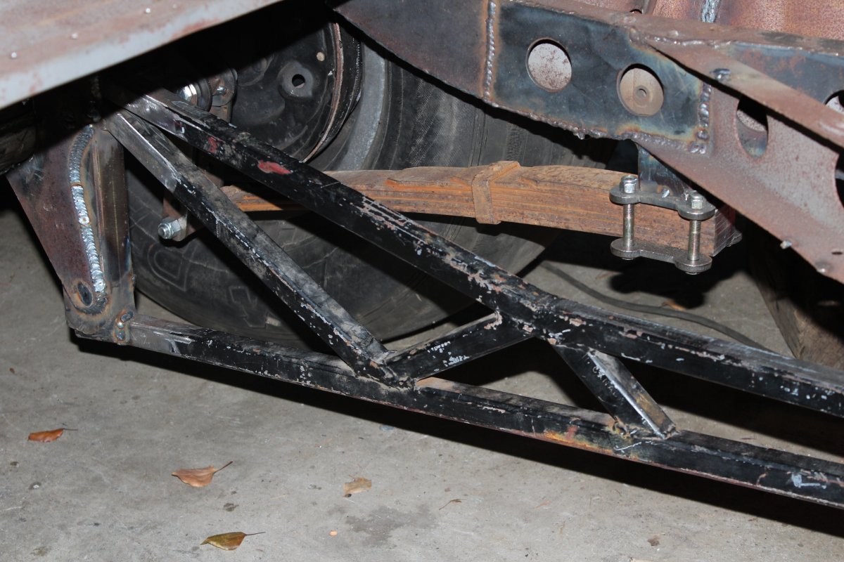

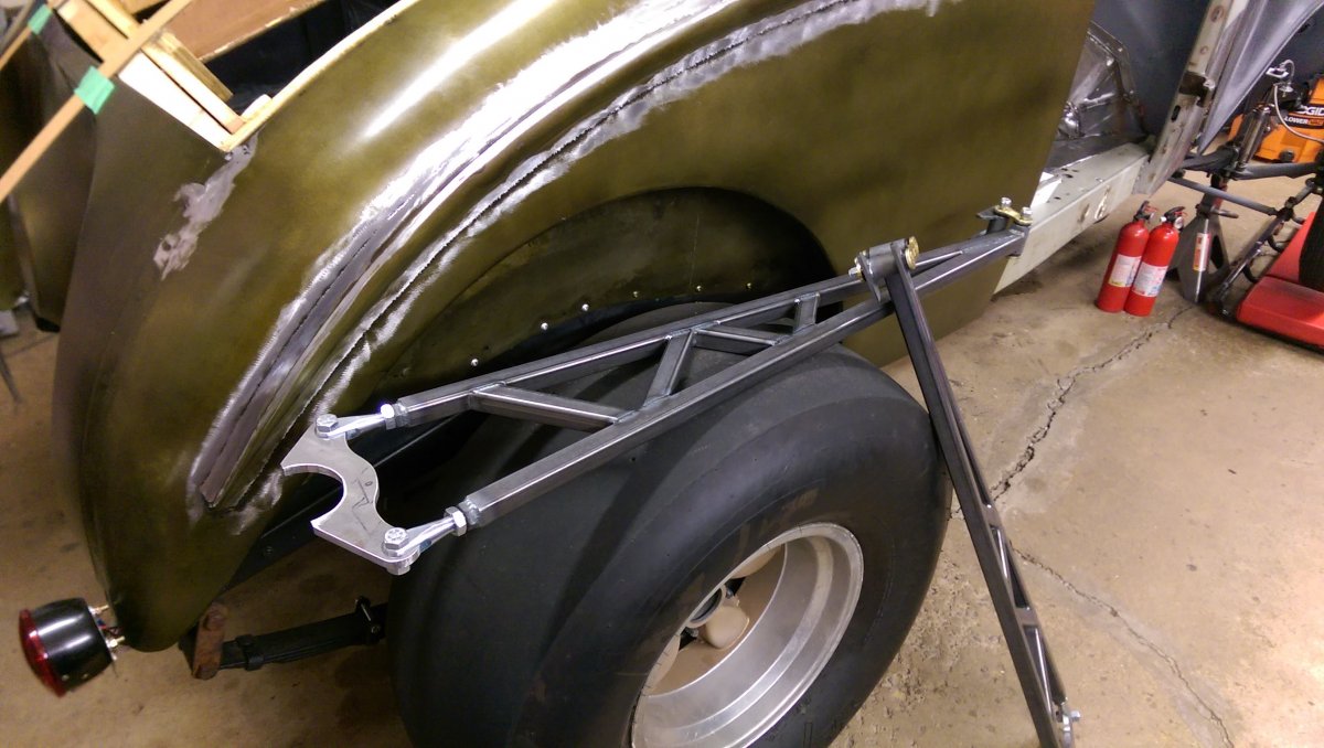

    I built similar shackled ladder bars and caught a lot of flak about how they won't work.

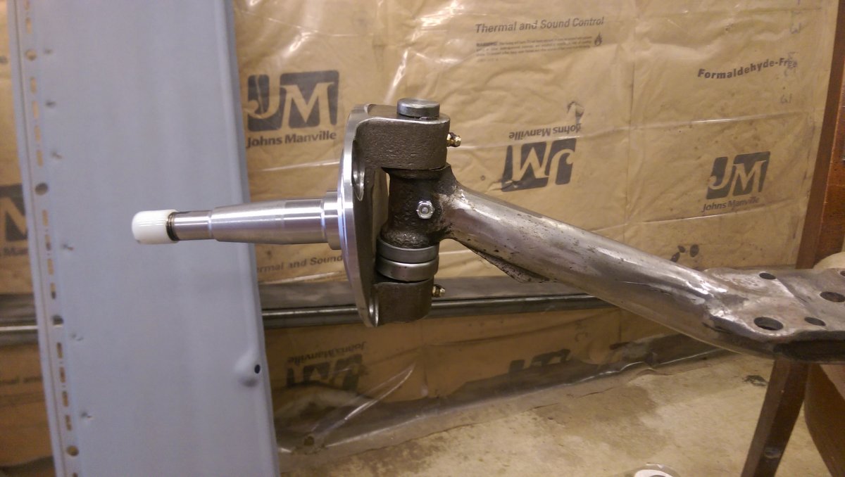

    Are those Ford spindles on a Willys axle? I thought about doing the same thing with an Anglia axle.
    Bowtie Coupe and loudbang like this.

    Baloney. I built them the same way on my '63 Falcon g***er with a 464 c.i. BBC and they work just fine. Of course they have a little give built into them with the front shackle. But if the angle of the shackle is correct it not only allows the springs to work, but also keeps the pinion from wrapping up and causing wheel hop. My Falcon hooked great with them, and lifted the front wheels on launch with no wheel hop. I'll be doing the same thing on my current '39 Chevy g***er build because it works.

    If all you want is a lift bar they work fine with no problem on low power cars and will help control wheel hop. If the ladder bar is to be used as designed it needs to have a solid mount in the front and a slider on the leaf spring. The front mount of a ladder bar is designed to be a push point, if a shackle is used it becomes a lift point only and the front eye of the leaf spring remains the push point defeating the purpose of the longer ladder bar having a further forward push point. Confusing I know but it's how it's designed to work.

    If a solid mount it still pivots in the front because of only one bolt.
    If the leaf spring is mounted solid to the rear end housing and no shackle or slider in the front it will bind because of two different length pivot points. I wish i could draw on here to explain it better.

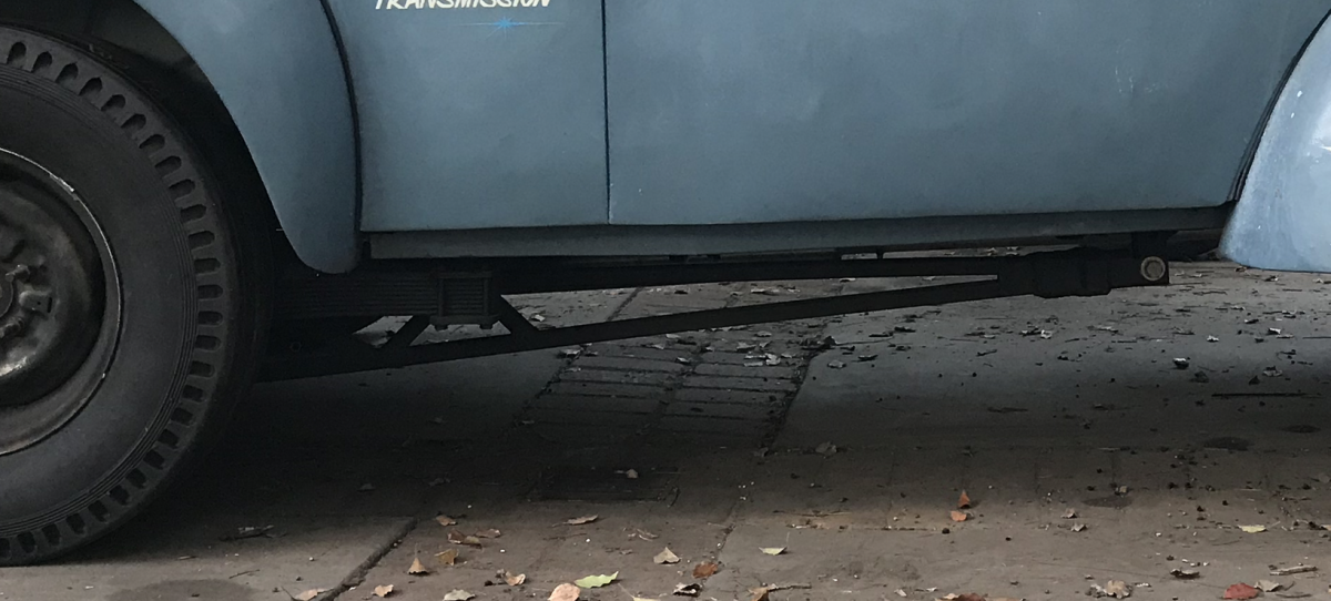

    Since you are giving free advice, I was more wondering if my setup will work.

    This setup will also bind. It doesn't matter if it's a 1/4 eliptical, or full spring. It's still going to restrict travel and cause spring bind.

  18. CGkidd
    Joined: Mar 2, 2002
    Posts: 2,924
    CGkidd
    How would it bind if it has a shackle mount between spring and housing?
    Sent from my E6910 using The H.A.M.B. mobile app

    Your set up will work perfect. The 1/4 elliptical spring was exactly how they did it in the old days once they figured out the full leaf mounted solid was binding. The shackle on your set up will let the housing move back and forth to so no binding. The bars being welded at the housing instead of having rod ends don't leave you any adjustment is the only problem i see.

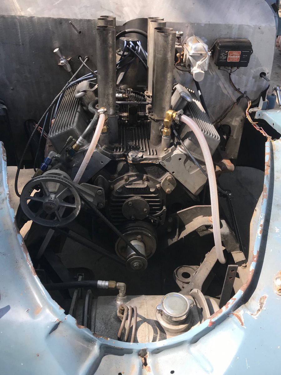

  21. drumyn29
    Joined: Feb 16, 2006
    Posts: 2,279
    drumyn29
    I did install a Jabsco water pump, so at least I can drive it around my neighborhood to work some of the bugs out. I spun a bearing last month and I'm not sure if it was from overheating or something else.

    Sorry, didn't see the shackle on the end.

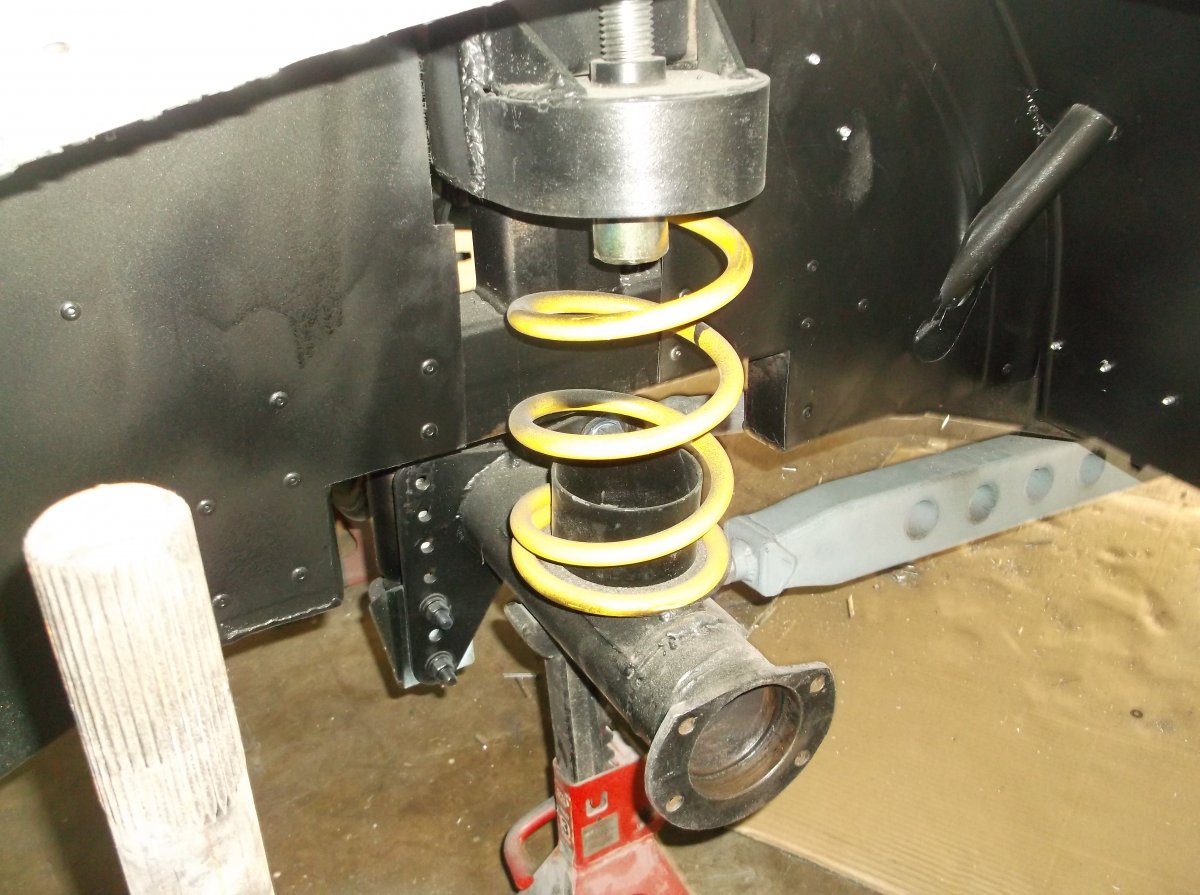

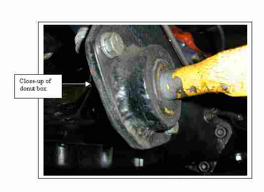

  23. willys36
    Joined: May 6, 2006
    Posts: 3,207
    willys36
    Ladders work fine on full semi-elliptic springs if you allow for the different swing arcs of the spring and the bar. I have seen cars with two shackles on each spring, one in front and one in back. This seems to be not as good since the axle will struggle making its arc comply with the bar. I have done it two ways. On my buddy's '37 Willys pickup we mounted the front of the ladder with a shackle to the frame. Here are some pictures of how I did it on my Willys coupe. I made a little holder for a Mustang II front strut rubber donut and welded a piece of pipe to the front of the ladder that slides tightly into the hole in the donut. This allows the ladder to make its arc that follows the spring's arc. Both work great, the spring doesn't know the ladder bars are there until it tries to wrap and hop. Smooth ride and no hop.
    Bowtie Coupe, Dog_Patch and loudbang like this.

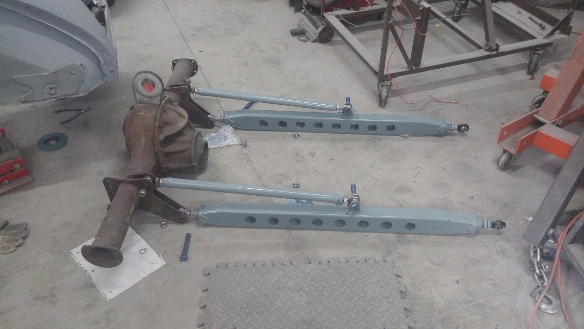

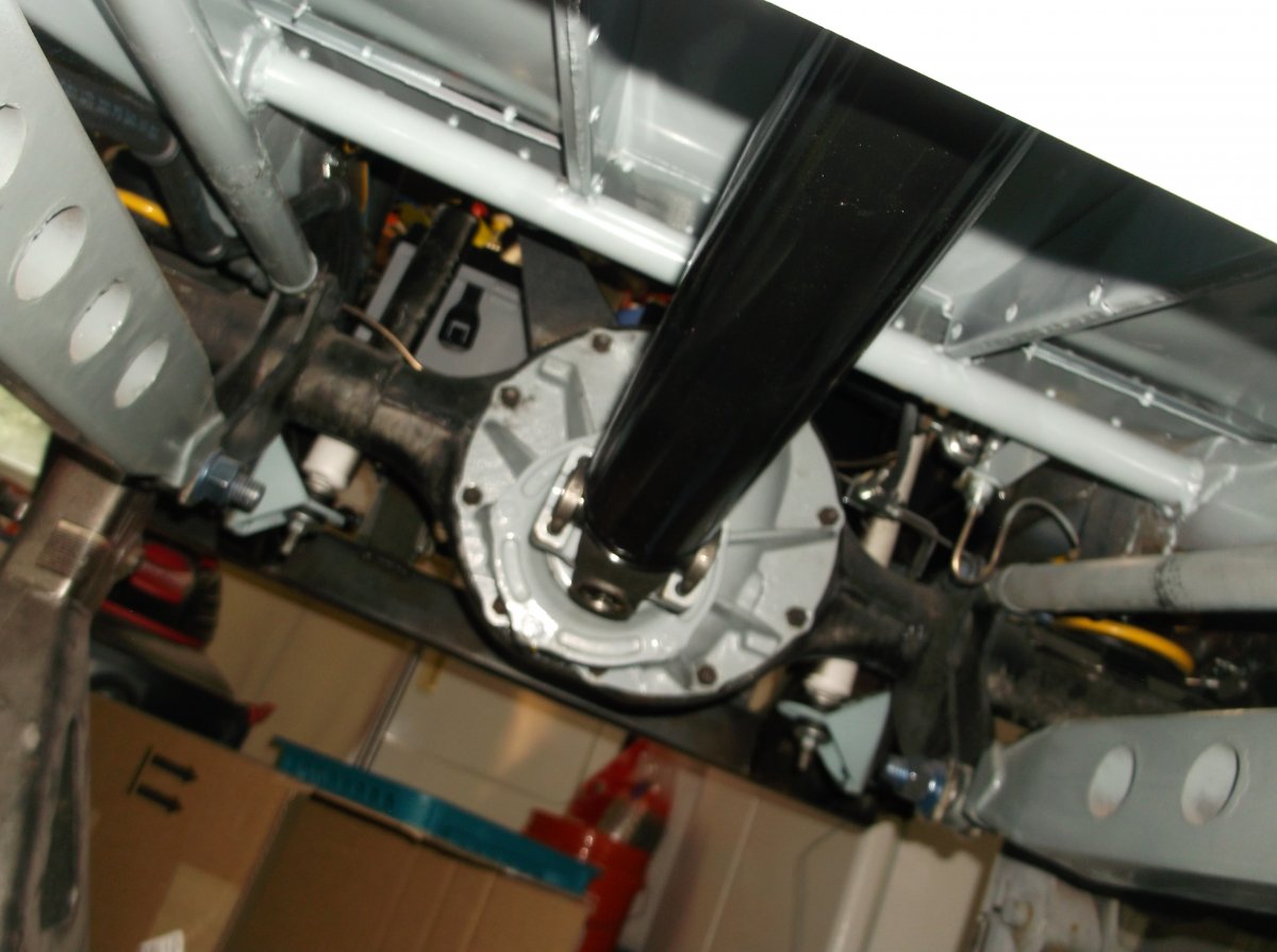

  26. southcross2631
    Joined: Jan 20, 2013
    Posts: 4,412
    southcross2631
    This is my version of the Stott bars. All points have adjustments. Mine is a coil spring car. DSCF3465.JPG DSCF3512.JPG DSCF3527.JPG 20171018_111207 (1).jpg
