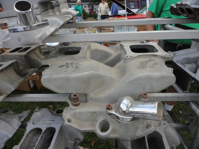

    Have we addressed cross ram intake manifolds?
    I'm a fan..............

    I like your style.Those intakes look really great,but some don't run as well as others.
    The ones you want to look for have the two halves or plenums joined in some way,such as the Mickey Thompson intakes do.
    These seem to provide a stronger vacuum signal to the carburetors,allowing them to operate more smoothly,and without stumbling.
    The Edelbrock does not use this feature,and I have heard of guys having quite a bit of difficulty to get it to run well.
    I do not have any personal experience with the Offy crossrams.
    For carburetion,on a smaller ci motor (up to 300ci hot,or 350ci ish mild) I would suggest going with 390cfm carbs,and for hitter street motors I would suggest 450 cfm mechanical secondary carbs.I would save the 600 cfm carbs for VERY hot small blocks,or big block motors with lots of inches to feed.
    I would also let the cam companies know what intake you were planning on running,and let them suggest a specific grind,or maybe even a custom grind.They will also be able to help with carb advice.

  26. cool to look at, but not that great for making power. The very first Edelbrock TR-1 tunnel ram which is crude by todays standards, and was a somewhat copy cat of a '63-'65 Rochester Fuel Injection manifold was 10+ hp better than the Ram Log at 3000 rpm, and 63HP! better at 6500. This was on Edlebrocks very own dyno, with their very own 331" SB Modified Production engine.
