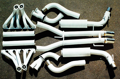

  26. Ok, I called Swain Tech (585)229-2786 and talked to Mike. They typically get $350.00 set to do domestic V8 header sets, depending on how much prep work they need. Worst case scenario would be a set that had silver Jet Hot, or something similar (which does need to removed for their coating) could be up to $100 extra. They call theirs White Lightning Ceramic, and it IS a ceramic material and .015 thick! & very durable, compared to the typical paint base coatings that are only a few thousandths thick. They claim an outer header heat reduction in the 35-55% range, which should significantly help driver and engine compartment temperatures(remember, every 10 degree reduction of inlet temp to the engine, is good for a 1% HP increase, thats 10-15hp for a 30 degree reduction on a 450hp engine Swain Tech White Lightning Ceramic Coating.jpg . He said typical turn around is 2.5-3 weeks. If you want additional exhaust system pieces done, they generally quote $40.00 per foot.
