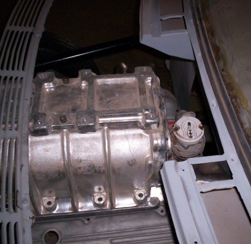

    I have a question to pose to you all that hasn't come up so far in this discussion..
    I'm deep into the build of my 56 *ahem* "G***er?" and early on I decided to push the engine back...wayyyy back. The car has a 115" wheelbase so I was going for 11.5" but ended up at 10" and brother lemme tell you it is deep in what is now left of the cowl. I'm running stack injectors and the velocity stacks would not fit underneath so I split my beloved 56 open like a ripe watermelon to make room for them. My plan is to make a scoop which p***es through a lexan windshield. I have looked at hundreds if not thousands of photos of vintage g***ers and have only seen this done on one car and it appeared to be from the early 70's. I cannot find where it says this cannot be done in any of the rules but admittedly I am looking at abridged rules posted on forums such as this one.
    I'm not going to jump off a bridge if that's a deal breaker because I'm happy with my car but I'm also curious to know the facts. Could g***ers have a split windshield and if so when did this occur?

    Aren't we back to the 10% setback rule for g***ers? Back in the day of weight-to-cubic inches there also was maximum engine setback. With that kind of setback, I believe you are replicating something other than a g***er. Move your engine back more than 10% and you were in an altered cl***. Larry T seems to have a pretty good handle on rules. Does this sound right?
    None of this matters when it comes to what you are building, it may just not technically have fit in a g***er cl***.

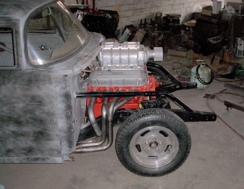

    At 10" of setback I'm actually under the max of 10% engine setback for my car by an inch and a half. I measured it from the spindle back to the #1 spark plug hole just to be clear. I found this picture not 10 minutes after I made my post.
    I can't see any cl*** designations on the car but it sure looks like a g***er to my eyes.

    Yea, the rule is 10% of the wheelbase from the front wheel centerline to the front spark plug.
    The BBC in my 55 was set back about 7 inches and it looks like there would be plenty of room to move it another 3 or 4 inches before you got into interference with the windshield. I think the injector stacks would be about in line with the back of the (mock up) blower.
    Ok, the car is still here so I pulled the hood and measured. I guess CRS set in, it measures about 5" setback with about 4" more you could squeeze in. Not quite the full 10%, but close.
    Bean Dip, are you going to run the car on the street? Is a plexigl*** windshield legal? I didn't think they were in Texas, but not 100% sure. If it's drag only, no problem.

  16. Steve!
    Joined: Sep 27, 2011
    Posts: 268
    Steve!
    from at the gym
    looks like an altered

    I have about 8* of tilt on my engine which may explain why mine is deeper into the windshield. I also have some pretty mighty injectors sitting on top (3" Kinslers). I will post pics of the car when it is done.
    Nahhhhhh...mine is setback much deeper than that. Maybe I just don't know how to use a ruler :D

    Sure enough is...thanks for the clarification!
    ....well...did some guys run injectors through the windshield prior to the 70's and NHRA just put a stop to that later or was it always a rule that you couldn't cut the windscreen?

    ...Well, as best as I can tell, my car went from A/G to C/A just as soon as I decided to put the scoop through the windshield. This thread has definitely opened my eyes on g***ers. Funny and a bit embarr***ing at the same time to not know about the windshield but I suspect I'm not alone on that one.
