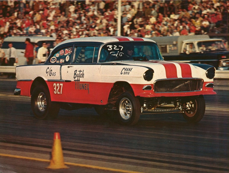

    Interesting - that was the only pic I had of the car.

    Bean Dip
    That sounds awesome!
    Now not to beat a dead horse but does that mean that some g***ers got away with notching the windshield? I just don't want to letter my car incorrectly.

  6. Well, that big pic of Thuneys '55 is the Winternationals, and I believe it still has pie crust slicks which would probably be 65-67 at the latest and although he doesn't have a scoop, the injectors are into the windshield/dash. Since this is an NHRA National event, they would be more likely to bounce the car out of Gas and into and Altered cl*** but it clearly has C/G on the side,and is shoe polished on the windshield, so I think we are good to go on that one.

    Super cool!!! I'm posting with my phone and couldn't make out the details of the pictures very well. That's very good news. Thank you for the help!
