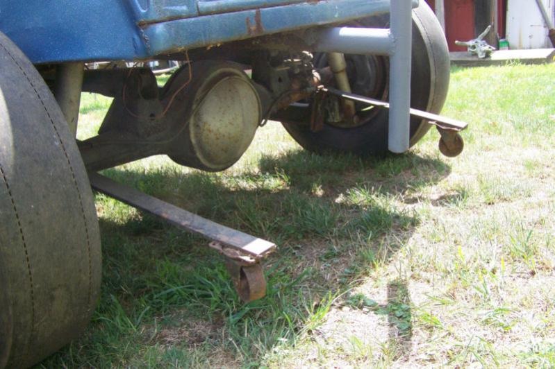

    I am still kind of stuck on the look of this setup though: ImageUploadedByH.A.M.B.1382783118.435466.jpg
    Olds/Pontiac housing,leaf spring wheelie bars,and that badass looking push bar.....thinking maybe a Q/C added into that mix would just be overkill and make the car look a little too...."Hollywood"...like its trying to hard to be one of the cool kids,you know..?:)
    Scott

    Scott. I have a Hallibrand Champ QC in my 49 Thames that only has 310 rear wheel HP. I've broken the spiders once, and cracked a side bell once resulting in $1500 in parts to repair. But it does look good!!!
    Sooo, I run a 9" with spool and 4:11's in the 48 Thames.

    Yikes.....that's a bit pricey for my feeble bank account.
    I'm kinda leaning toward the big old Olds after that info...
    Scott
