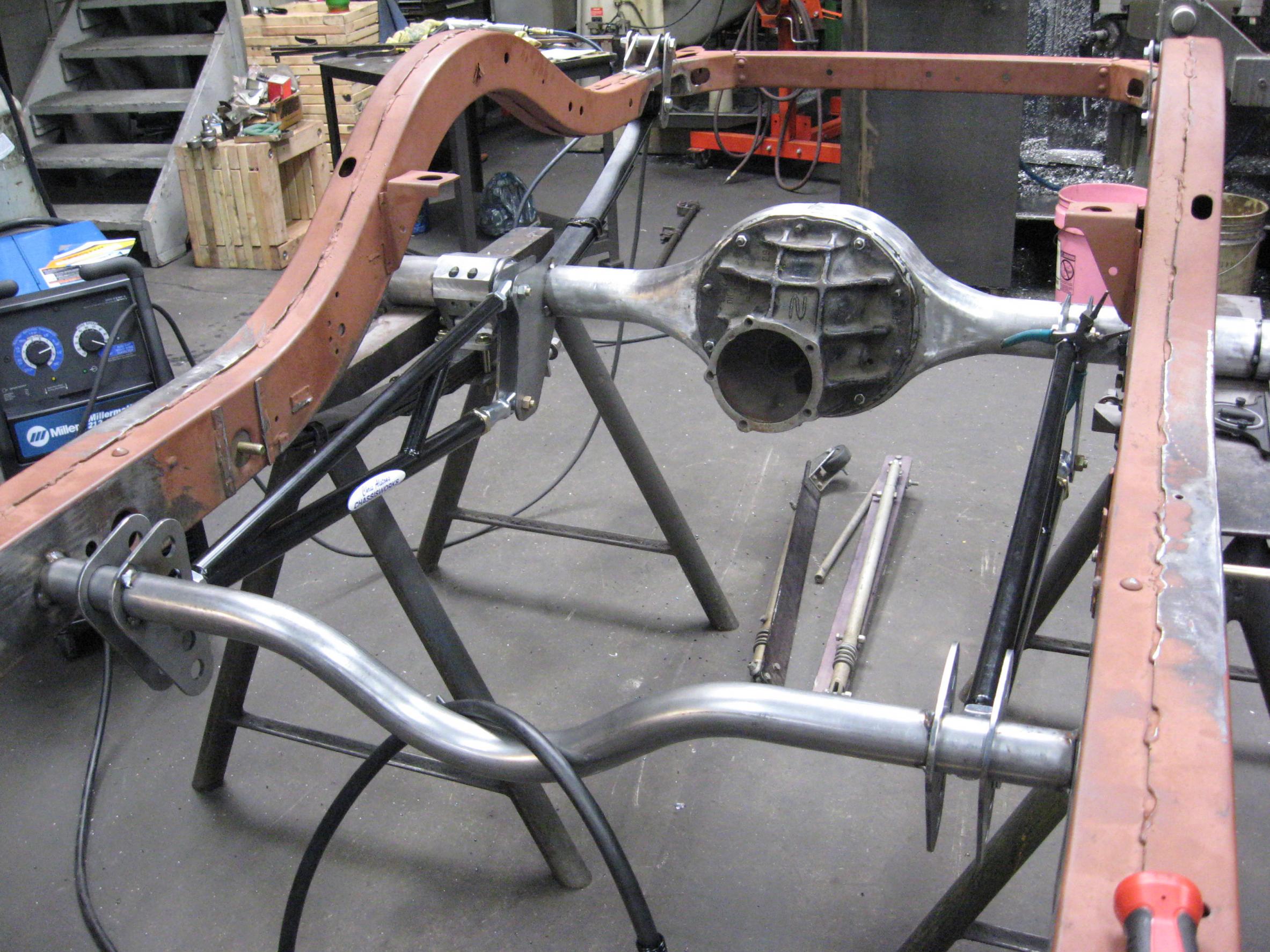

    We used a 9" 57 F100 housing (one year only) in this '55 Chev, they have the appearance of an Olds, when viewed from the rear. The tubes are over 1/4" thick and don't have any weld seams at the center, or the bearing cups.
