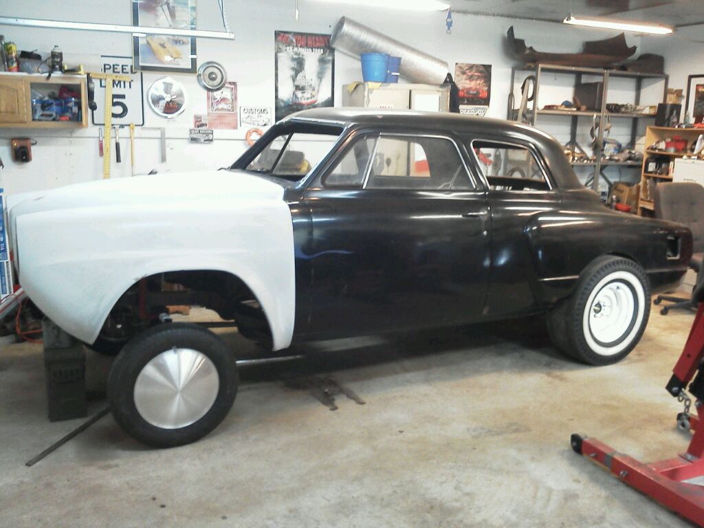

  24. CGkidd
    Joined: Mar 2, 2002
    Posts: 2,924
    CGkidd
    Good post the info in here is all good for building up a g***er. I am looking forward to getting mine back up on its wheels and running.
  25. CGkidd
    Joined: Mar 2, 2002
    Posts: 2,924
    CGkidd
    Here is a pic of my Stude I am building,
    Hightone111 likes this.
