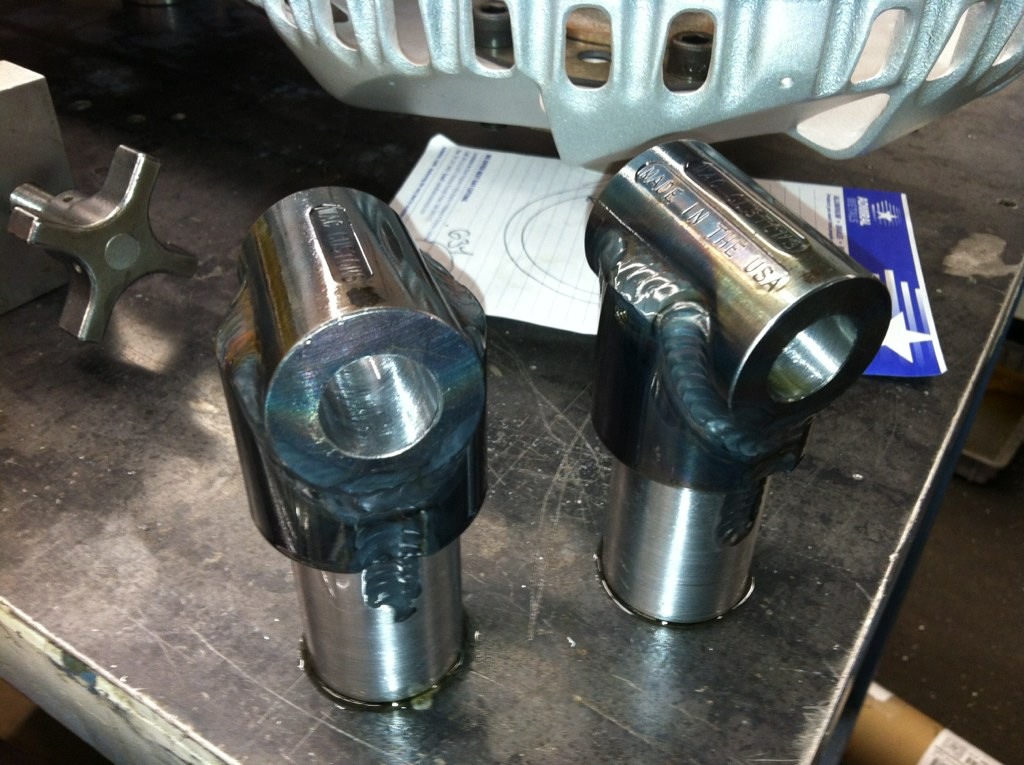

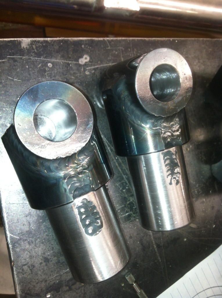

    Here are some Henry J ends I made for a straight axle.
    I can make any size king pin boss.
    Any size Tube (if I think it's Safe)
    Moly or DOM
    ImageUploadedByH.A.M.B.1386513556.782054.jpg ImageUploadedByH.A.M.B.1386513575.300826.jpg

    Just wondering why you make them as slugs to go into the tube ?
    I mill tube ends at the required angle and then tig weld the bosses
  5. BCCHOPIT
    Joined: Aug 10, 2008
    Posts: 2,604
    BCCHOPIT
    The Ends are a HD version of my dirt modified and sprint car ends
    I make over 300 dirt modified axle a year. I am set up for it so I can make a pile of ends and just cut the main tube to size and ship it out the door.

    I ordered (2) of his axles, one 38" and one 50" king pin centers, both had only one end welded. At the time I was unsure about the final width in both applications. Another thing that worked out well, was the ability to slide 360 degree brackets on, and then install the other end. This sample is on a Bonneville car I am currently building.
  7. langy
    Joined: Apr 27, 2006
    Posts: 5,730
    langy
    Thanks for the explanation, I had a feeling it might be to do with multiples, You do a very nice job.

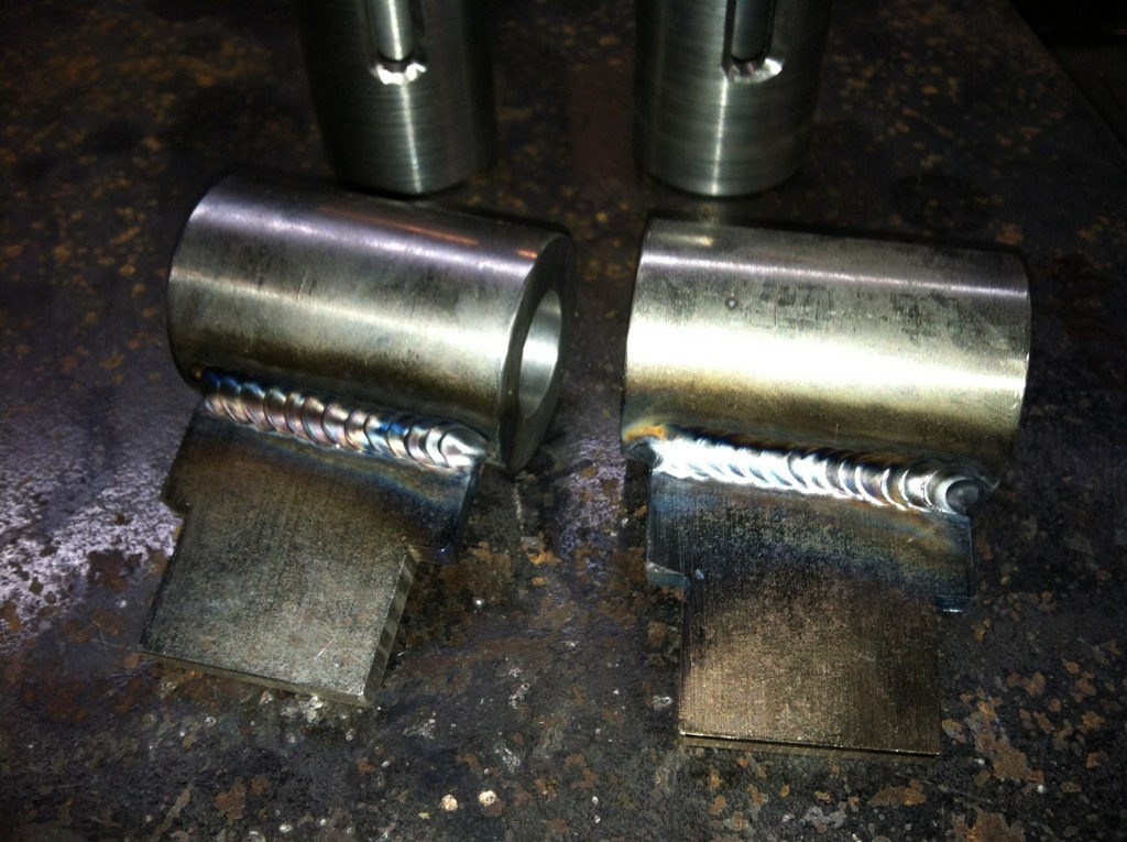

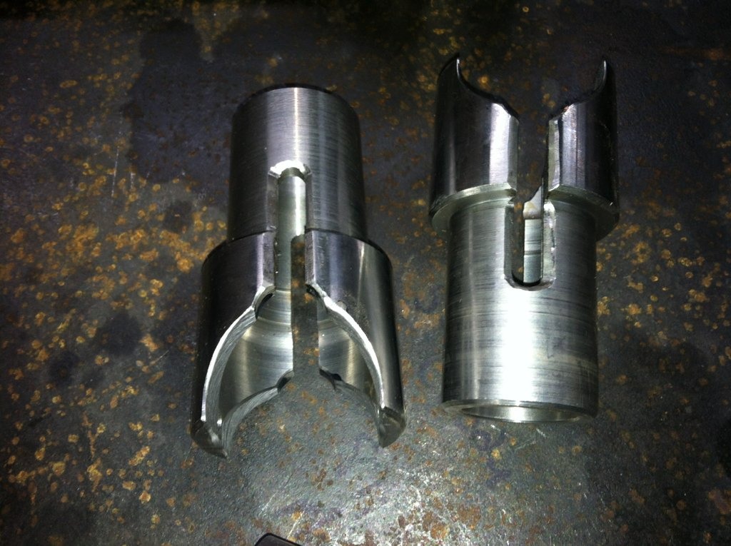

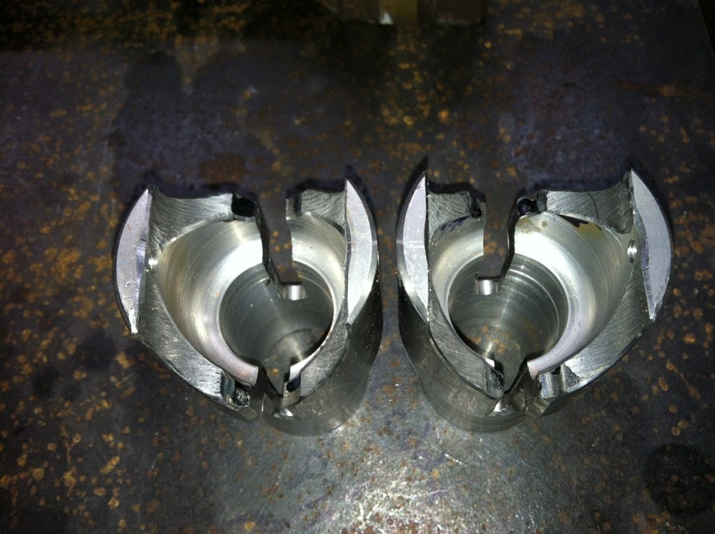

    Here's some pics of the ends before welding

    Hi BC
    Great looking TIG stuff, have you ever seen the early Trackmaster - Redline flat track frames the had welds that look like yours
    They get them Nickel plated with no polish and those welds just jump right out at you
