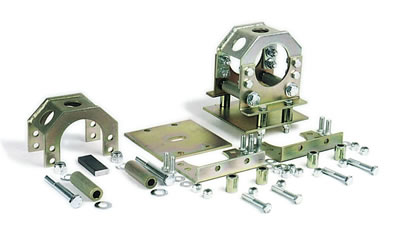

    Baron
    Here is another option to think about. I have used this type semi floater many times and they work fine. They are quiet, and your able to adjust the ride height of your car 2-3 inches.
  24. abone1930
    Joined: Jan 16, 2006
    Posts: 1,324
    abone1930
    Who makes those? Not building my Willys to be a period correct car, but I want it to look it to the average car guy. Just don want anything getting into a bind.
  25. Baron
    Joined: Aug 13, 2004
    Posts: 3,672
    Baron
    Jeg's sells them. Jegster 40603 Housing Floater Kit. $110.00
  26. Quain Stott
    Joined: Nov 21, 2006
    Posts: 2,068
    Quain Stott
    You can make a slide / floater system real easy that we use and it works good. Just drop a bracket down on each side of the spring with a hole above the spring and another below the spring with about an 1/8" clearance. Sort of like the 2 side brackets in the pic in post 2183. Make a piece of tubing for a crush sleeve between the bracket on each bolt. Now the spring is captured with the bracket on the sides and a bolt on top and bottom it will rotate and slide, works just like it has coil overs. I'll try to get pics if anyone is interest. Oh make sure you get about 1" ahead or behind the spring bolt because it will move about that much and the bolt will interfere.
  27. Baron
    Posts: 3,672
    Baron
    Something like this ?
  28. Quain Stott
    Posts: 2,068
    Quain Stott
    Exactly, Thanks Baron you saved me from crawling under my car and making a pic.
