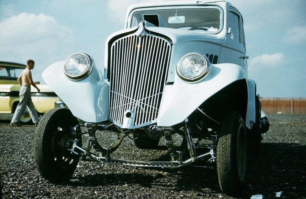

    So I was originally going to run fenderless,with lots of engine setback,and build the car as an Altered,but after seeing a picture of this coupe,I'm tempted to put fenders on my 'A',and maybe get out to a few Gasser events... ImageUploadedByH.A.M.B.1389811117.259282.jpg
  29. langy
    Joined: Apr 27, 2006
    Posts: 5,730
    langy
    I got to thinking the other night did they have their front axles chromed in the 60's, I would of thought they would of rather have put the money into the motor ???
