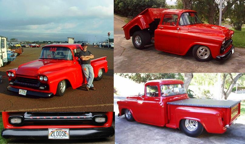

    PS. like your avatar, looks like a 58/59 chevy pickup, here's a pix of mine...
