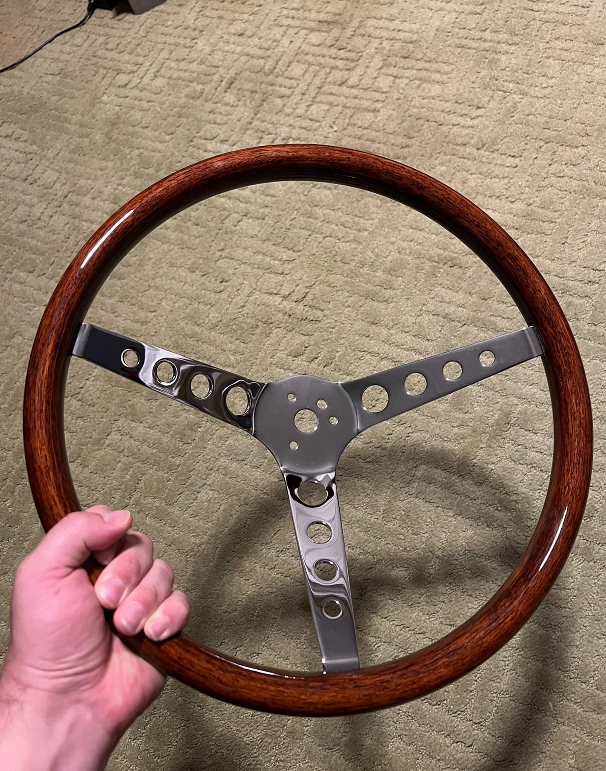

    I just ordered in a new steering wheel to paint the rim like the 60s flake steering wheels like Moon, Cragar, etc. I bought a wood rimmed one as I didn’t want a rubber one that would get gummy in a couple years. After opening it up I am having a really hard time sanding down such a nice wheel to paint. So my questions are:
    -Were wood rimmed wheels traditional for a g***er type build? I know they were around but it seems like that was a mid to later 60s trend.
    -keep the wheel wood, or who cares, stop being a sissy and paint the steering wheel.
    Thanks.

  14. I don't think painting a wood object with hard automotive paint will work out. Wood can expand/contract a lot with changing ambient temps/humidity and the finish will crack/lift over time. How much time is the variable, but I don't think it will take all that long. You might try the additive that's used for the modern plastic bumpers to add flexibility but whether that is compatible with your paint choice will have to be determined.
    A better choice IMO would be one of the plastic-rimmed metalflake ones after stripping all the plastic off. You now have an all-metal wheel to work with.
    I will say after looking at the pic of your wheel I'd question if that's actually wood or that it's more than just a thin veneer. You may get away with painting it...

    I never thought about contraction and expansion. I believe it is just a veneer. I’m gonna give it a shot but if it fails I will try it with a plastic rimmed wheel. Thanks for the tips.

    Steering wheels are right in the sun, so expansion and contraction is an issue, but the big thing is handling. Think the door top where your arm rubs times 10. Also, the old school ones were clear to the metal frame, so painting a solid wheel won't look like them.
    I understand wanting to select just the right part to match a specific time and use. Too many don't do that. However as said, race cars are function over form, so anything that would work was bolted on and you moved on to the next thing. So long as it is of the time frame and works, you are good.

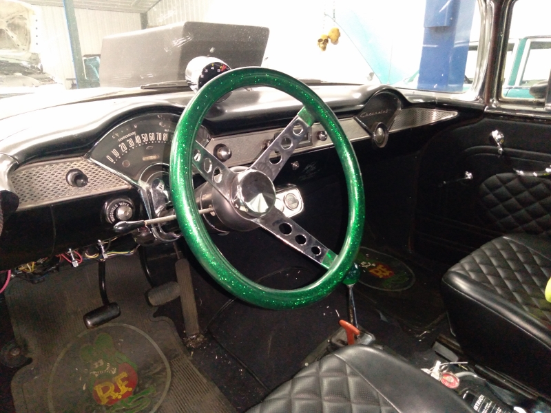

    I just bought that exact same steering wheel for my old hot rod car. Mines not nearly as nice as it was used. I figured it would go with the wood slats in the roof
    Chadcamo and Just Gary like this.

    Plywood is made from fir, a grainy soft wood, better ones are birch, a less grainy medium hardwood but both tend to show grain after time in plywood since it is of questionable dryness. The steering wheel he has appears to be a stained hardwood, maple or birch? But it is holding a nice gloss finish so is probably pretty stable. If coloring that wheel, I would sand it to a perfect finish with 300 dry paper, being careful to not breach the existing finish then paint it w/ catalyzed urethane automotive paint. If it fails, at least it isn't a $30,000 pearl/metal flake/candy full body job!!

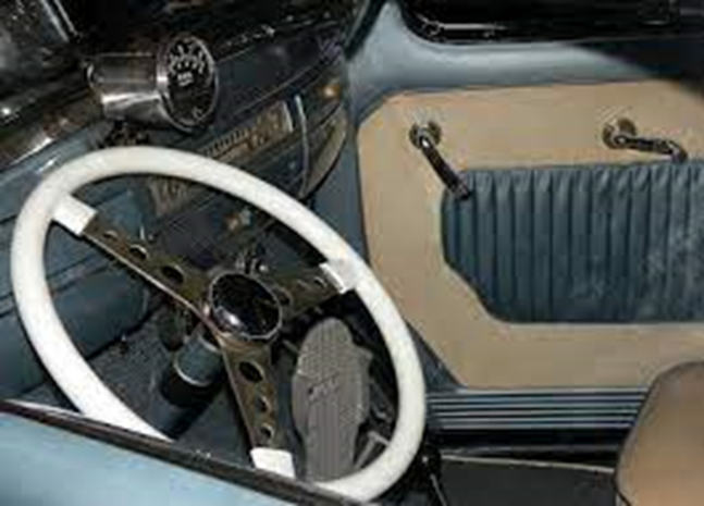

    Your project should be labeled custom steering wheel for cruisers. The Gas Coupe and Sedan cl***es did not have painted steering wheels. They usually used what came with the original coupe or sedan. A 34 Ford coupe or 40 Ford sedan steering wheels. When some of the top racers began to exchange the stock wheels with the 3 spoke or 4 spoke black rubber/plastic compound wheels, that is when the popularity began.
    upload_2024-11-3_3-16-27.png variation of the black rimmed steering wheel is based on the early Moon steering wheel. Then as the popularity rose, other companies began to make their all black rimmed steering wheels.
    Now, custom cars had the different versions of steering wheels from chrome chains and mini wheels we saw in early cruisers, to the 3 spoke flashy versions for custom cars. The hot rod group still stuck to the racing hot rod look of 3 spoke black rimmed steering wheel or the popular 4 spoke.
