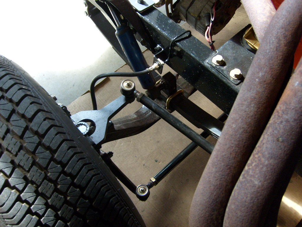

  4. Here ya go-

    Nice, this thread only took 2 years to take off. Some really great detailed shots Baron. I like like the pics where you can really see and understand how everything works on each varied application.

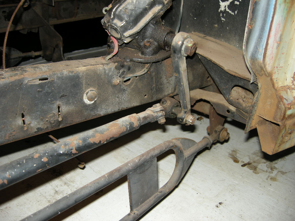

  8. Baron
    Joined: Aug 13, 2004
    Posts: 3,665
    Baron
    You do need shackles. With out them, the springs will not be able to flex what-so-ever. The shackles can be mounted either forward or aft. I have found over the years that if you are running drag link steering frt to rear( as opposed to the drag link going from the steering box to right front wheel), the shackles are better mounted the opposite side of the axle the steering box is mounted. (example: if your steering box is mounted in front of your axle,best to put the shackles in the rear, and vice versa). Cross steering is just a matter of preference/looks.

  11. Atwater Mike
    Joined: May 31, 2002
    Posts: 11,618
    Atwater Mike
    Baron:
    Nice clean setup, everything parallel. Where did you get that slick pitman arm?
    Is it just straight-splined inside or does it have the 4 'master slots' like the factory one?
    Thanks...
  12. Baron
    Posts: 3,665
    Baron
    Thanks. The pitman arm came from Speedway Motors. I think it has only 1 double wide spline, so it can only be installed in 4 positions.
  13. seb fontana
    Joined: Sep 1, 2005
    Posts: 9,111
    seb fontana
    from ct
    Take out the double wide splines and you can put it any where you want..Two or so splines "to the left" will give equal steering wheel turns to left/right..

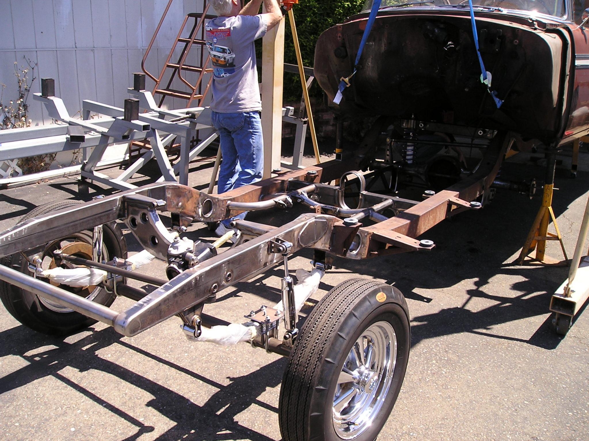

  14. here are a couple of pics of mine. We made the axle from hydrolic tube (seamless). tig welded. 40 ford stubs and falcon rotors and calipers. Made springs with shackles up the front. Original fairlane steering box.
    I have run 10.99 at 119 mph and can not believe how straight it runs.
    Hope this helps some one.

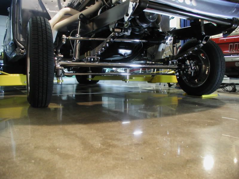

    Mine was all Speedway Except for the Chassis Engineering steering arms. The 1/2 rack is a right hand steer unit turned upside down so I could put it in front of the axle.

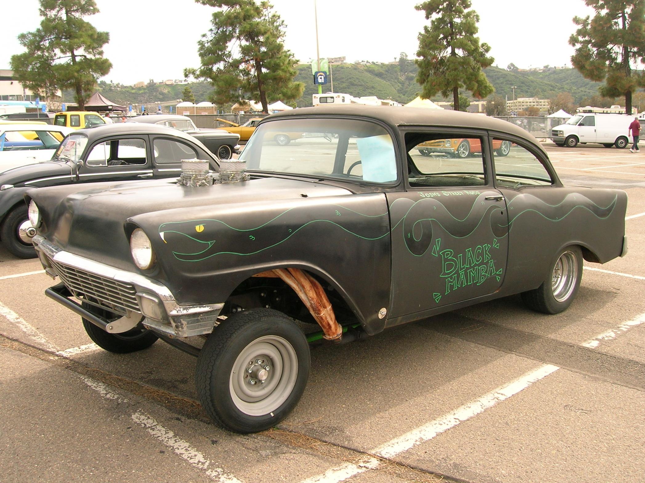

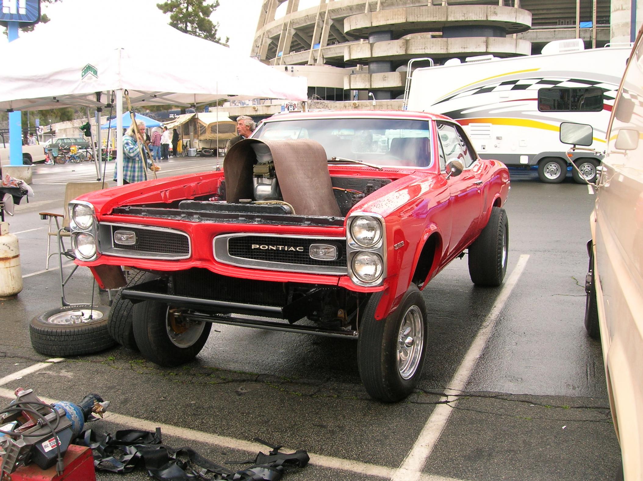

  25. I saw these at the SanDiego Big Three Swap meet in 2010

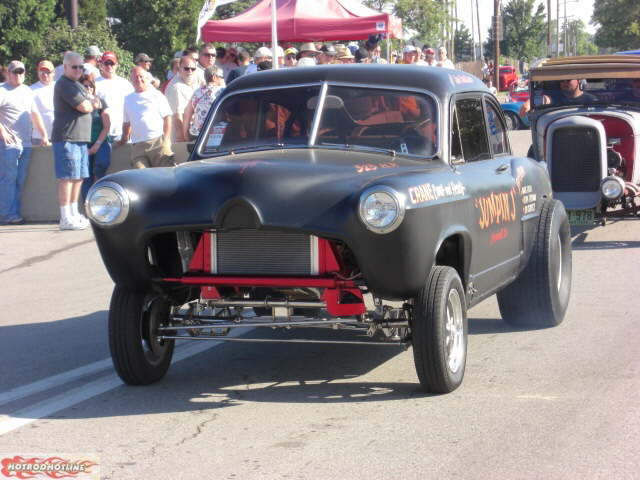

  27. Mullins
    Joined: Sep 1, 2007
    Posts: 209
    Mullins
    Better shot of under my Henry J. Jumpin J

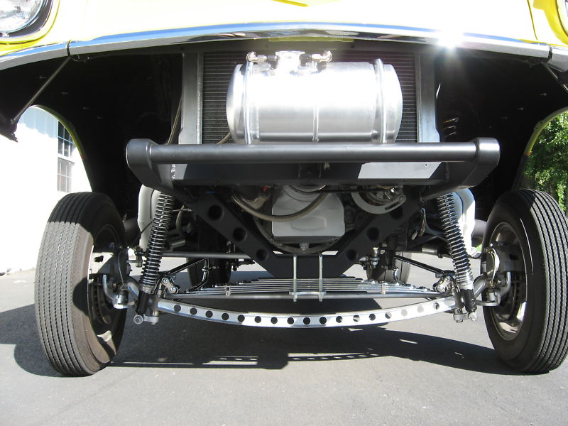

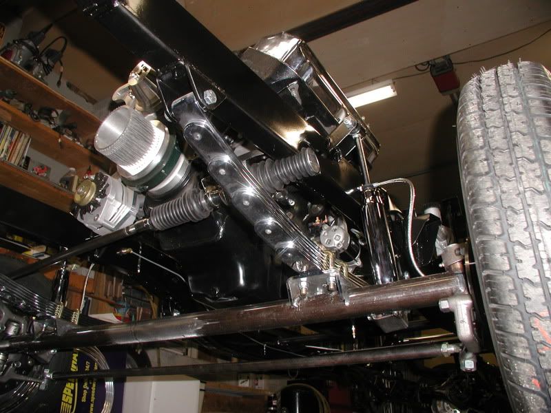

  30. choke
    Joined: Dec 15, 2008
    Posts: 323
    choke
    This is definitely a STREET FREAK front end design. We used the chrome overloads for a stablizer in turns. It worked out excellent and also gave it a PURE HELL LOOK!! Car steered and road like a Cadillac.
