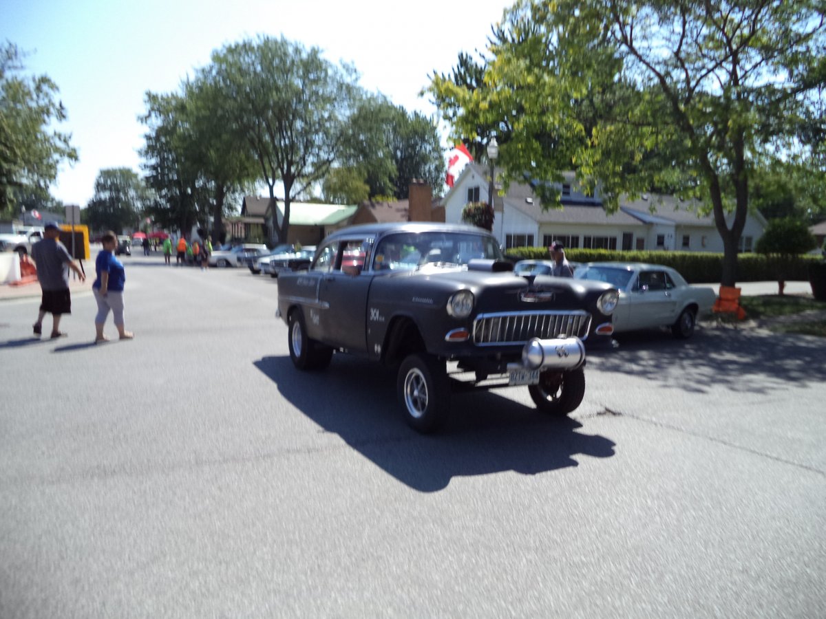

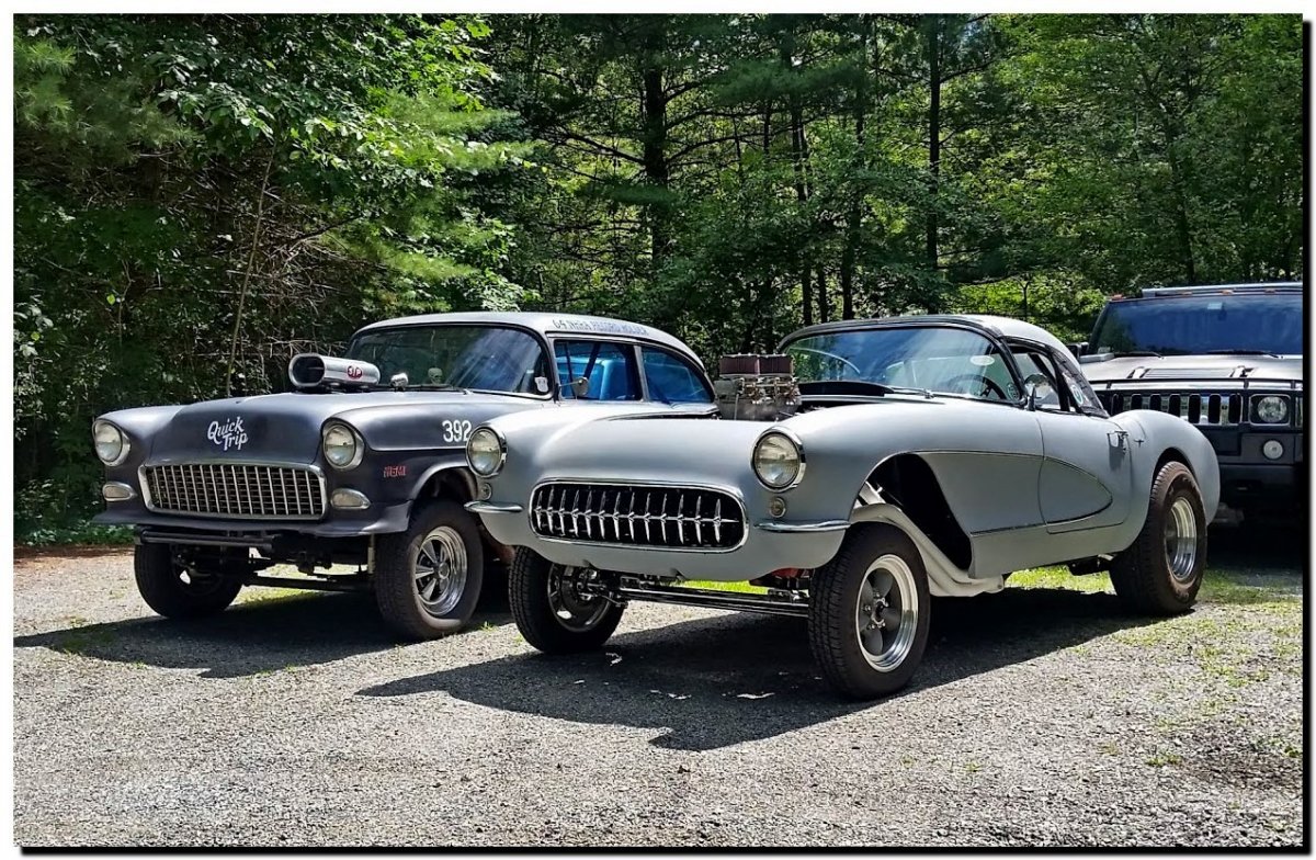

    Measuring at the rocker panel, my 55 Chevy is 13 inches, the Corvette 14 inches. Both cars ride and handle fine.

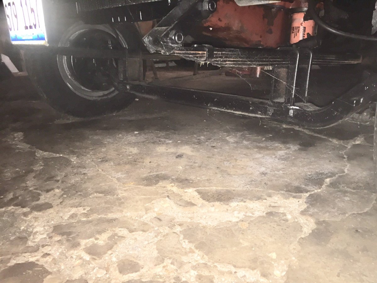

    Just finished narrowing my 54 f100 axle to put under my Morris Minor. Will be drilling the holes in the axle tonight. 20161212_1946411.jpg

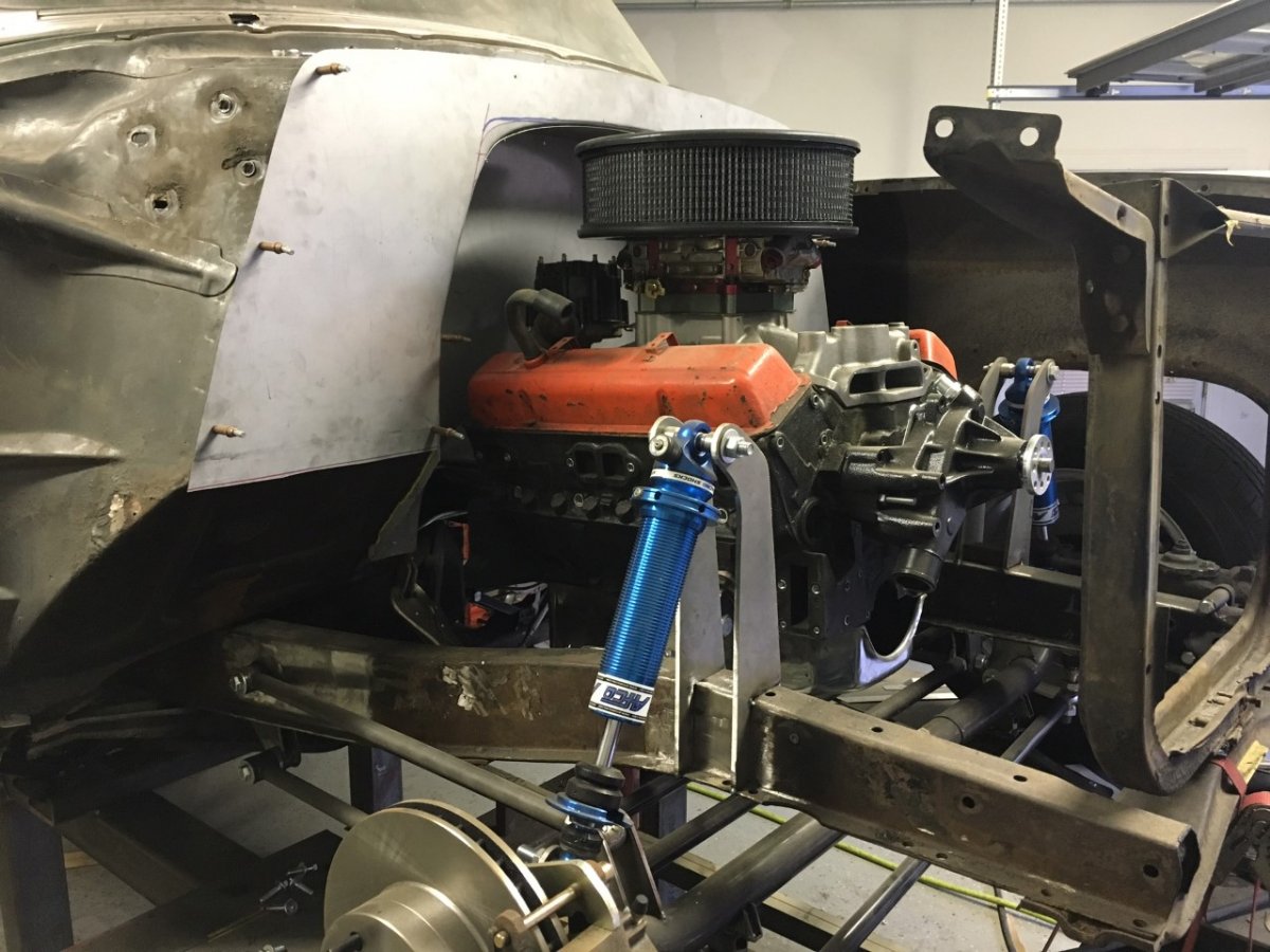

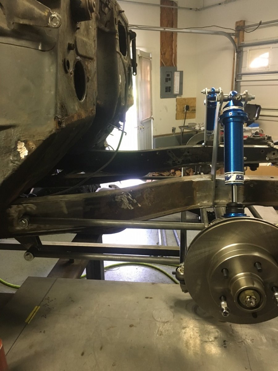

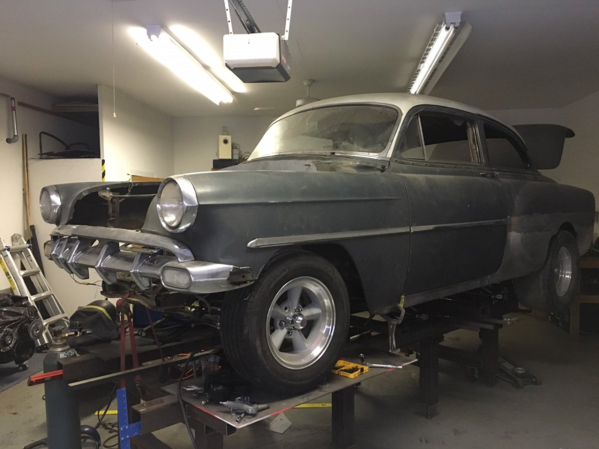

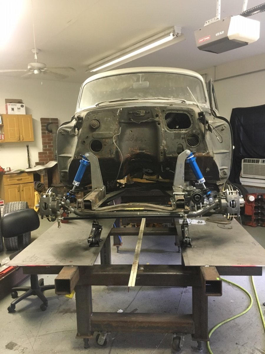

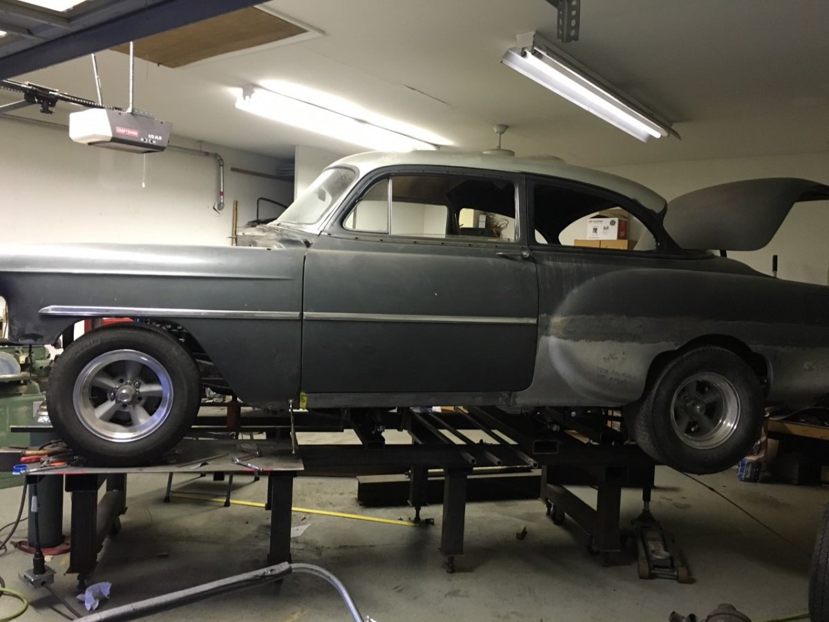

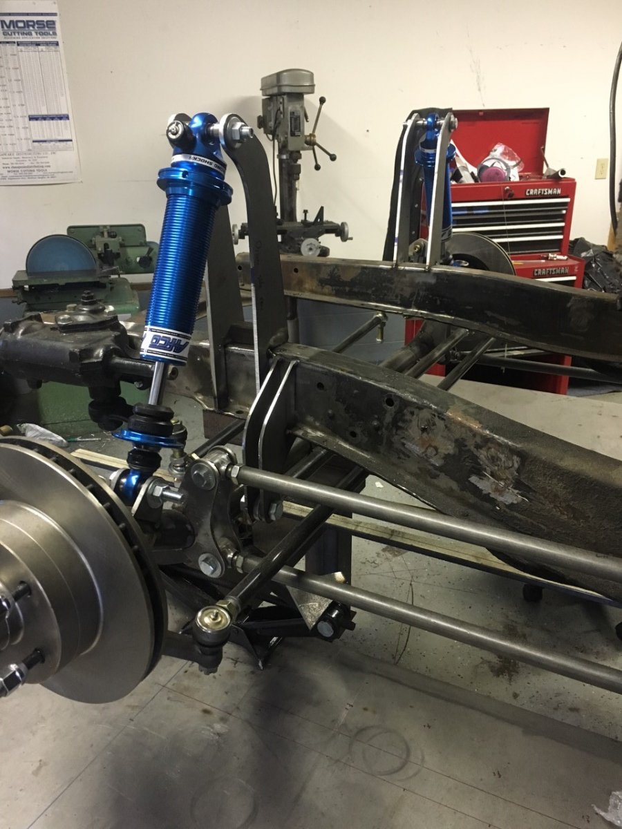

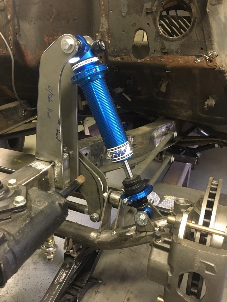

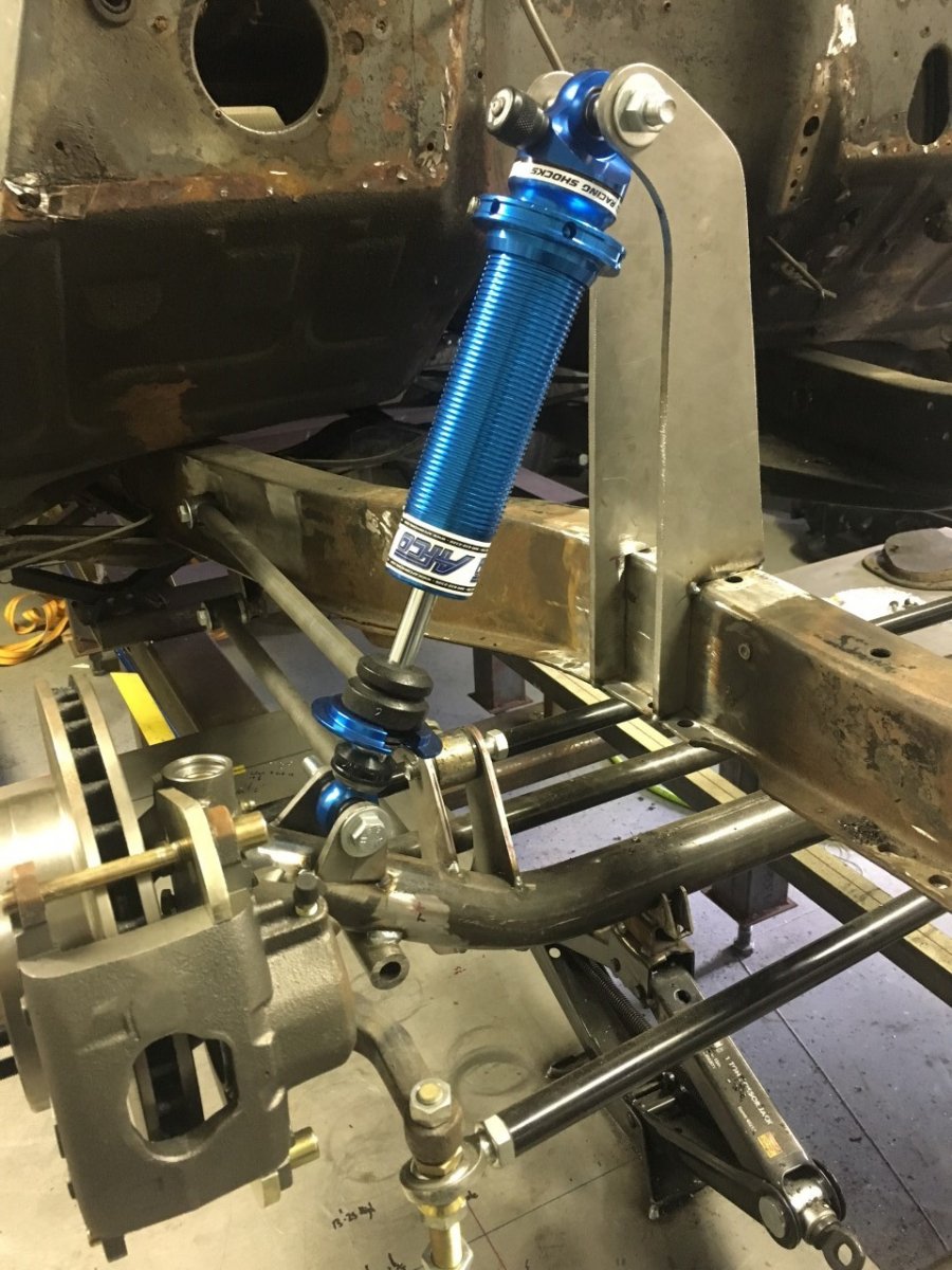

  9. Heres mine, modelled after the 2 lane blacktop car, not sure how O/T it is...this is a mock up stage, there is still trimming/gusseting/welding to do and wheel arches to be cut. but at this point I know it'll all work together harmoniously.
    It is 11.75" from the rocker to the ground at the rear and 10.25" at the front at ride height..
    I'm working on the tilt front now...
    thumbnail_IMG_4860.jpg thumbnail_IMG_4861.jpg thumbnail_IMG_4862.jpg thumbnail_IMG_4863.jpg thumbnail_IMG_4864.jpg thumbnail_IMG_5740.jpg thumbnail_IMG_5638.jpg thumbnail_IMG_5741.jpg

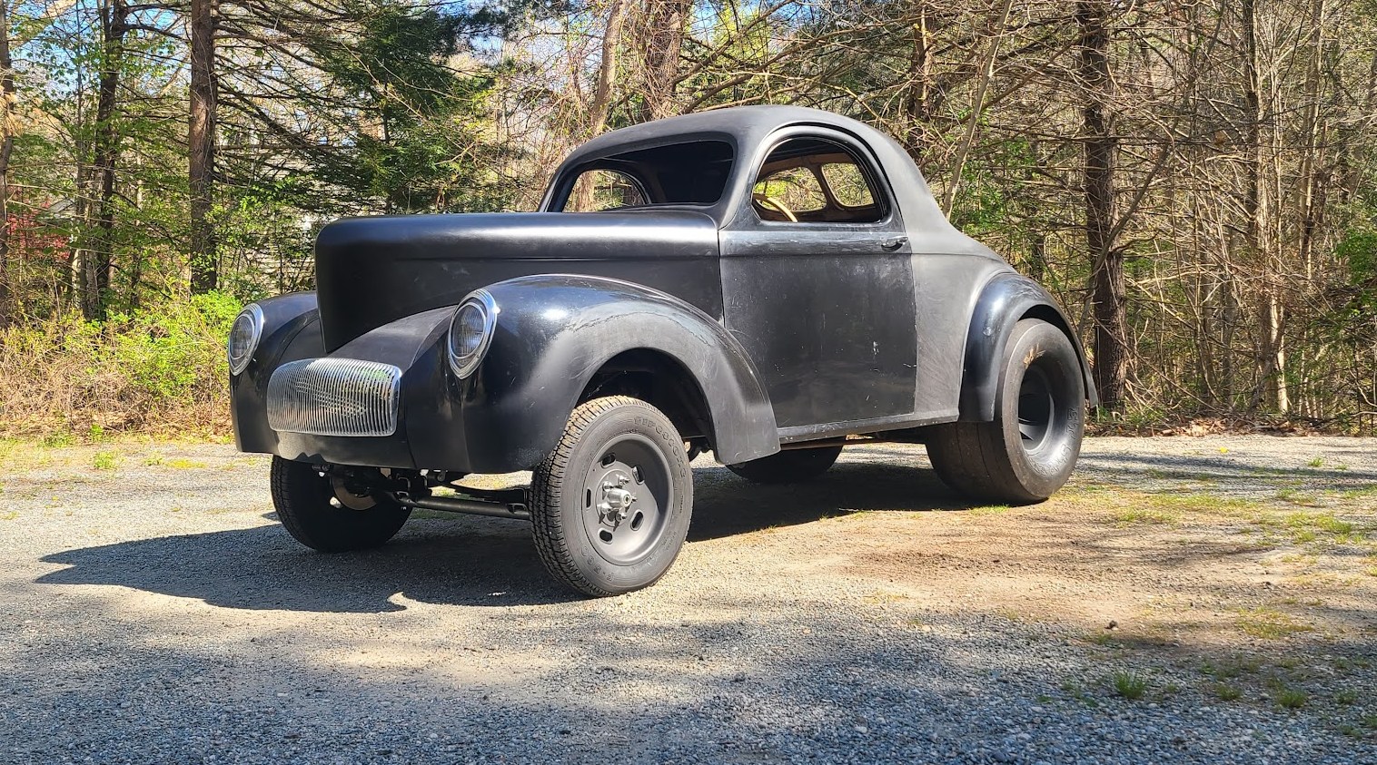

    Another WAC ( I beam/ tube axle ) under my 41 WIllys. Won't bend this one. 20220513_154420     cropped.jpg WAC I beam tube axle.jpg
