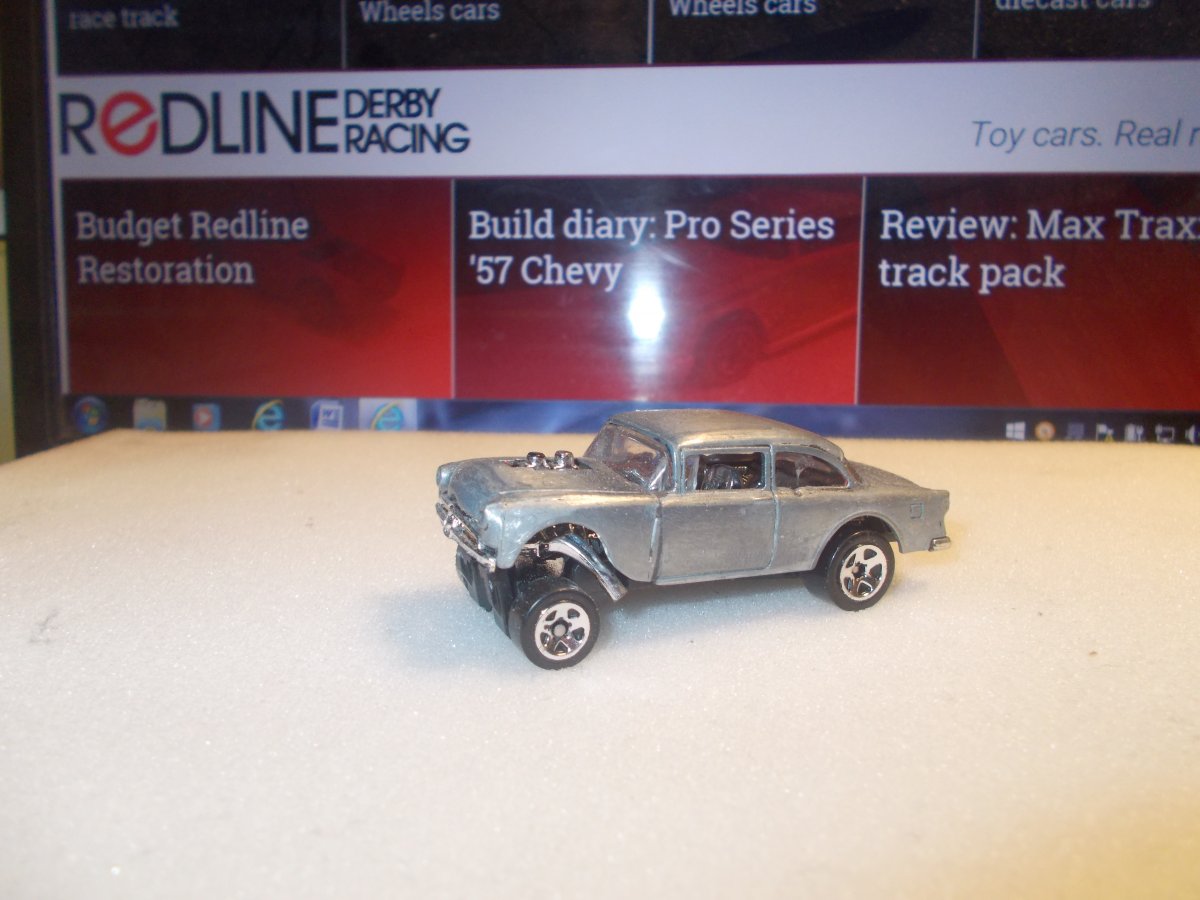

    If you can find a similar hot wheels car, then buy a " '55 chevy bel-air g***er" hot wheels , drill out the donut rivets underneath both cars... The '55 has a plastic ch***is and is easily snipped and filed to fit under the body you want to use... A round file or a burr-bit in your drill will hog the wheelwells of your car in the direction needed for it to fit the g***er's ch***is... with a chunk of black foam inside you can play with ride hights, take pix, blow them up on computer... try till you get the look you want...
    .... great H W tips at the redline derby website ...
    pictured example is a '55 chevy with a shoebox nose... works with at least 40 hot wheels cars
