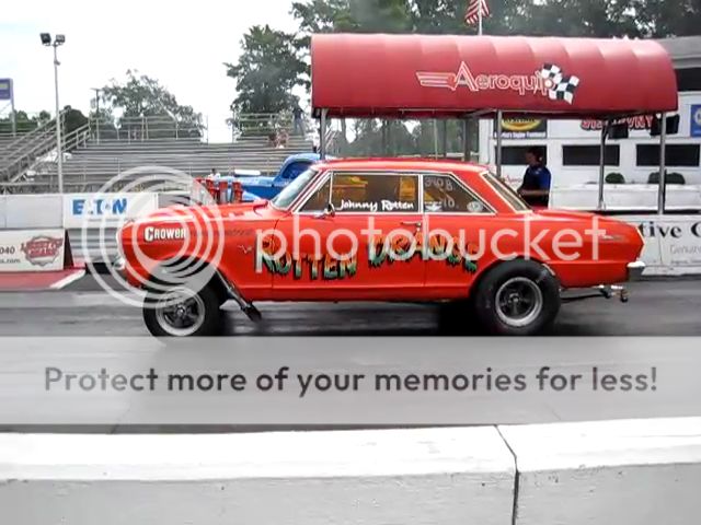

    3 pedels for me without doubt.
    I broke 3 doug nash units..........cost alot of doe
    Got a liberty 5100 series......cost alot of doe but saved me trans repair
    If you want a clutch, get good stuff the first time.....
    Sidenote.....I have been "thanked" many times by the spectaters for bringing out my manual and pullun gears HARD........The fans know whats cool and what they like
    click the picture/////[​IMG]
