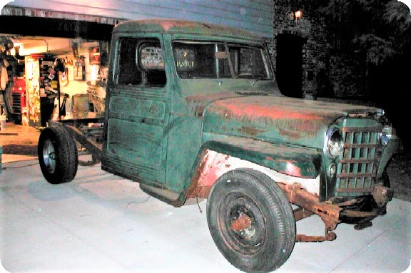

  2. I used one under a Jeep pu. Width was correct. Once upon a time someone here said early Ford spindles would fit but I have no first hand info on that. 49jeep_pu.jpg
