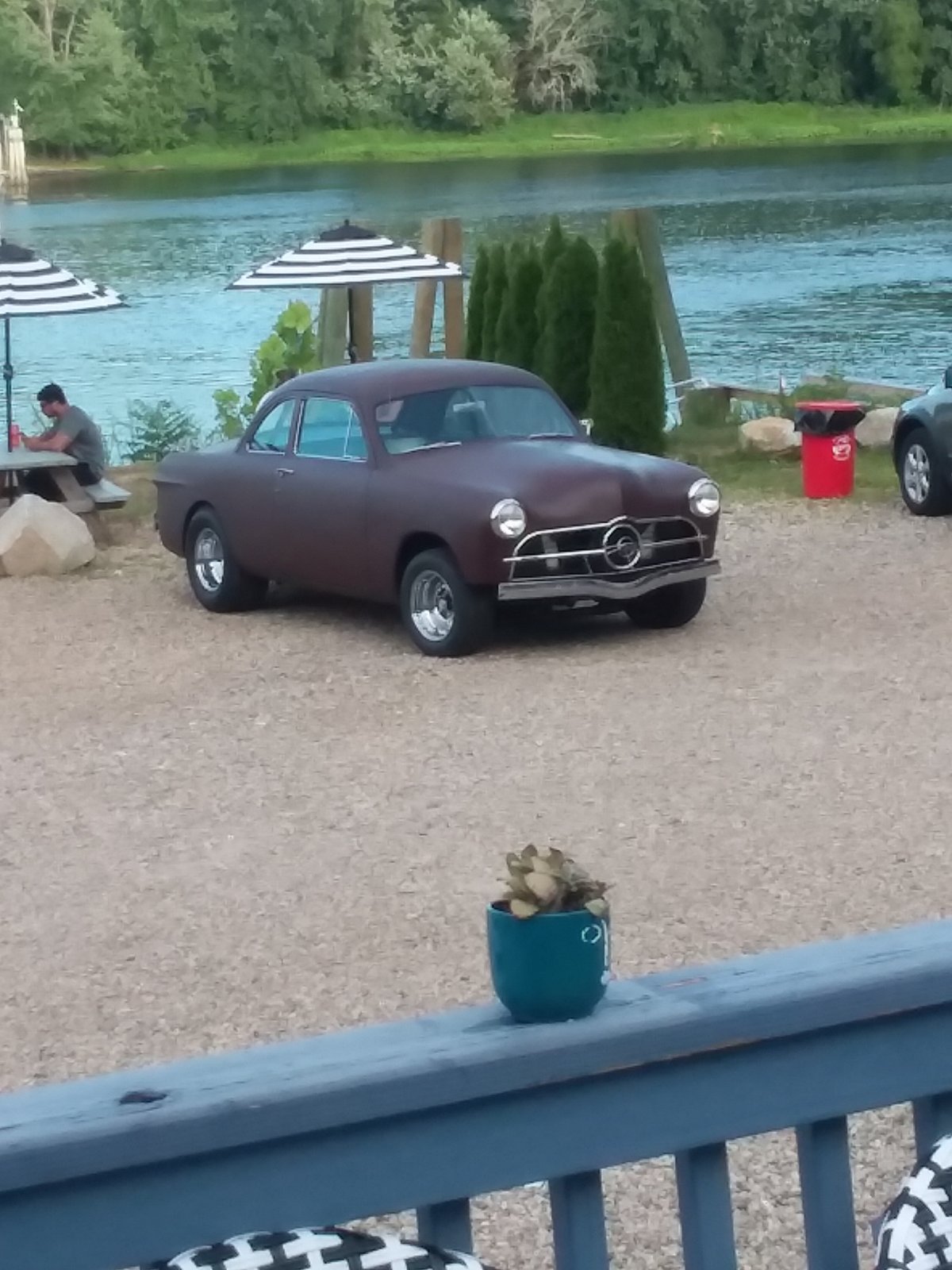

  5. Bob Lowry
    Joined: Jan 19, 2020
    Posts: 1,627
    Bob Lowry
    Yep, the thinking back in the late 50's and 60's was that when you were coming off the line, it
    was a waste of horsepower and e.t. to have the front end lift up when taking off. Racers basically
    had solid front end suspension, lifted as high as feasible to eliminate lost time and power. Once
    one guy did it and he won, everyone else copied him, thinking it was an advantage. Here is my
    street '40 Chevy which I did the same thing to......

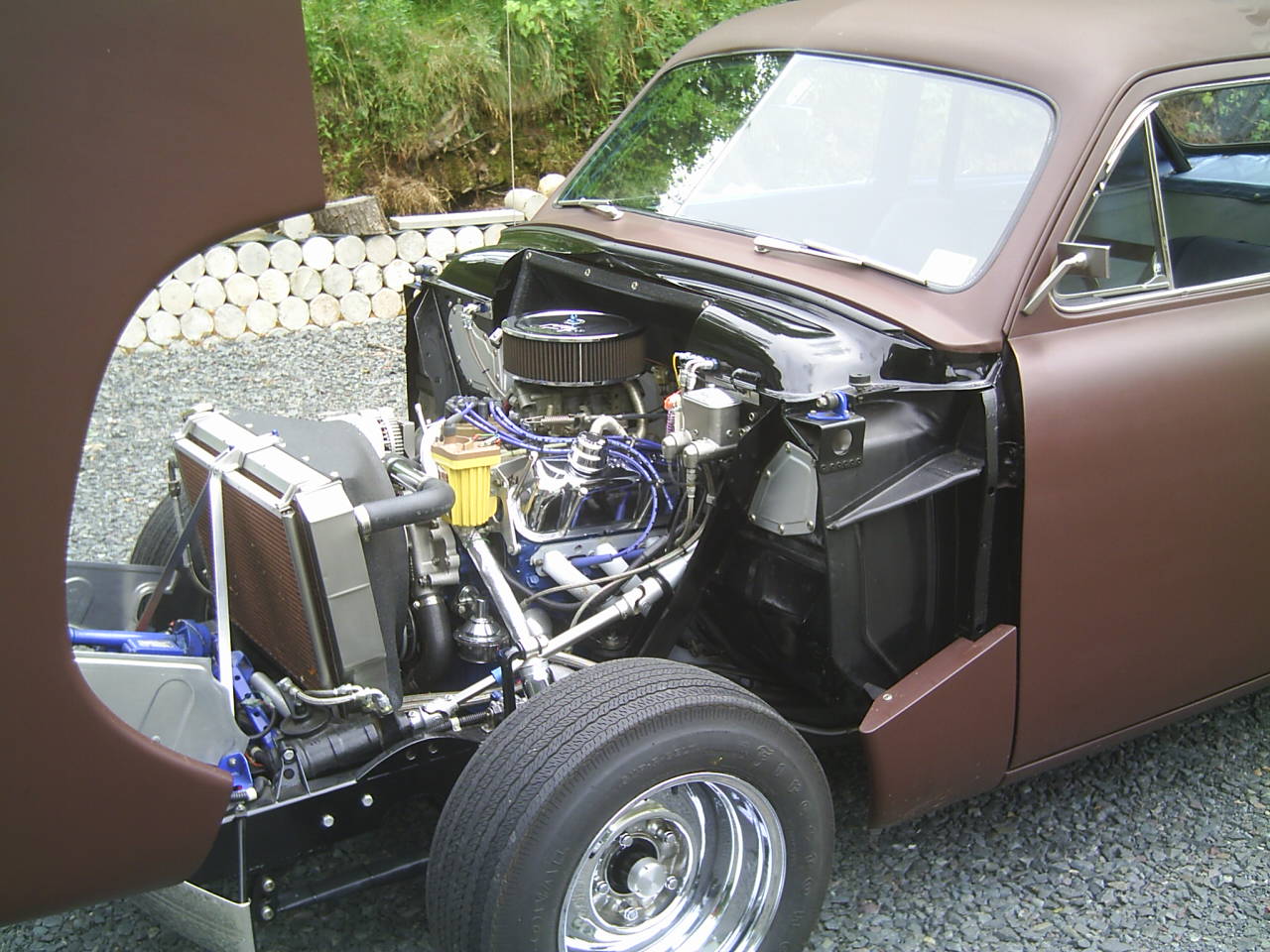

    Couple of pics of my old 37 Plymouth.....
    Chucky built Vanilla Shake

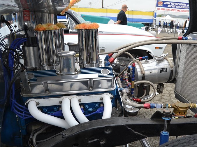

  25. Sky Six
    Joined: Mar 15, 2018
    Posts: 17,544
    Sky Six
    from Arizona

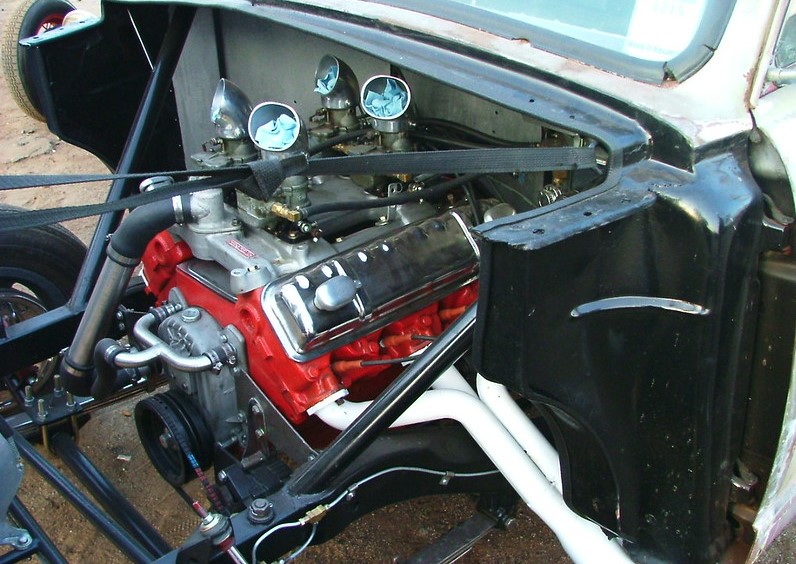

    With the proper engine setback.

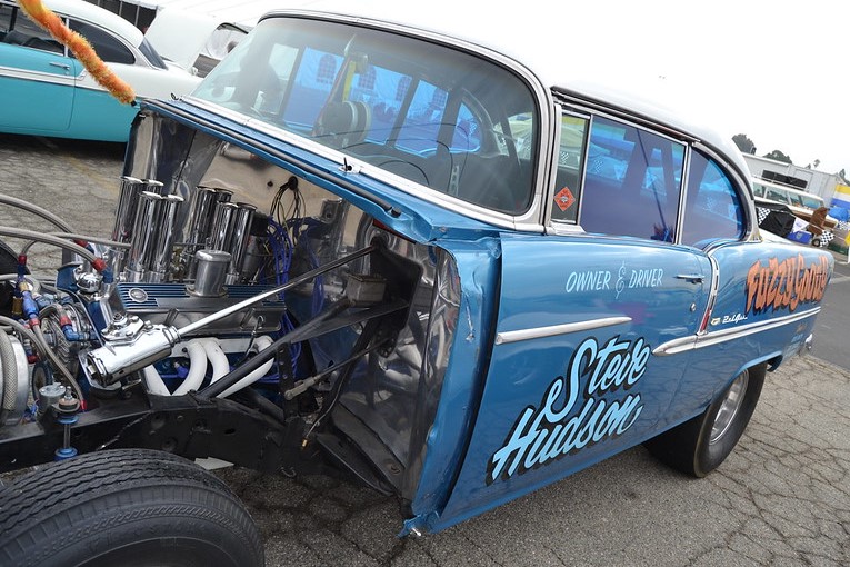

  27. Sky Six
    Posts: 17,544
    Sky Six
    from Arizona
    Another with the proper engine set back.
