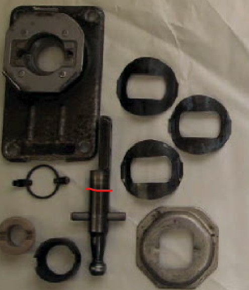

    If you really want to go down the gated shifter path, The best shifter to use a stock shifter / hybrid.
    You will need to split it open and remove the stub and graft on a thin stick
    This can be cut / bored in a lathe and a new lever TIG welded in place.
    When you re***emble [and TIG the top in place] get another 2nd hand shifter and pirate the Belville springs from it [and stack 5 together vs the original 3]
    You cannot use any short shift mods at all [or even a S10 T5 shifter] T56 and T5 shifters interchange on early models
