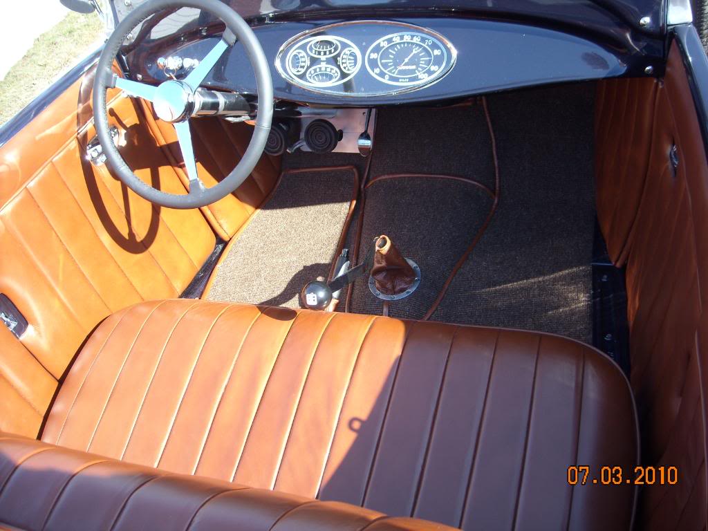

    Like this one? You don't need to spend 1000's to redo it. The speedo is out of a mid 70's Chev pick-up installed into the original cup and the needle swapped. The temp and oil are mechanical so no problem there. I used cheapie volt and fuel gauges I picked up. The fuel gauge should have it's own sender so the Ohm's work out right and you might have to adjust the sweep of the float in the tank. The volt meter is just a retro fit into the old gauge cup as is the fuel gauge. The actual guage faces are done with letra-set drafting decals. The dash face plate, which has the numbers and labels on it, was done by a auto decal maker here in town.
