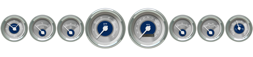

  9. I really like the original gauges too, but I need them to be white. The truck will be dark blue suede with some sort of white inside, and the black gauges just don't go with it. Aurora makes a badass set I dig, but then again, they are about $500, and I'm trying to see what I can get away with for as cheap as possible and still look good. Hell, everything I've bought for the truck so far has come from Craigslist or eBay for no more than $300 each :D I'm running a fuel cell that has a universal GM 90ohm sender on it, and I know Ford gas gauges tend to be backwards from that (at least that is what I've seen before). Just seeing if anything else did that too. The tranny has a mechanical speedo, but I know how to make that work.
    Here's a pic of the Aurora gauges: (WARNING: not HAMB friendly :D)
