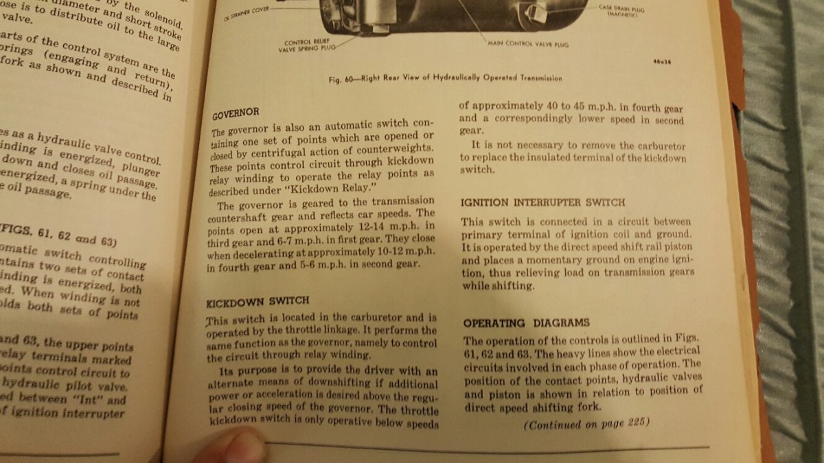

    Do you have a shop manual to help you figure it out? if not, maybe you ought to see if you can find one. Mine's out in the shop...

    Looky here,

  18. squirrel
    Joined: Sep 23, 2004
    Posts: 60,081
    squirrel

    Your car has the Fluid Drive and M6 semi automatic trans. It has certain features of both manual and automatic transmissions. But, other than the clutch pedal, you drive it like an automatic.
    The gear lever has 3 positions. Toward you and up, Reverse. Straight up, Low range. Straight down, High range.
    To go for a drive try this method. With the trans in neutral, and the hand brake set, start the engine and let it warm up until it will drop down to a slow idle (400 RPM)
    Step on the clutch, shift into High range, and release the clutch fully. You are now sitting still with the car in gear and your foot on the brake like an automatic. Release the hand brake, step on the gas and take off.
    When you get going over 14MPH lift off the gas. You should hear a soft *click-clack* from below the floor boards. That is the trans shifting into high gear of high range. Step on the gas and go someplace.
    If you want to stop for a light step on the brake as you would with any automatic. When you want to take off step on the gas, when you reach 14MPH lift off the gas and shift up.
    The trans will shift down automatically when you stop and it will kick down if you floor the gas pedal at any speed up to 50MPH.
    For going slow, starting off on a hill, or going in deep sand, snow or mud you can use Low range. It works the same as High range, but will shift up at 6MPH. You can shift from High range to Low range using the clutch and shift lever.
    Shift into reverse using the clutch. Do not slip the clutch, use the Fluid Drive for that. The clutch is small and will not stand much abuse. The worst thing you can do is gun the engine and slip the clutch like mad. Just put it in gear at idle and use the Fluid Drive.
    The Fluid Drive and M6 trans are simple, rugged and reliable. Most faults are very easy to fix . Usually all that is wrong is, they need to be topped up with oil or there may be a loose or broken wire. These 2 things account for about 90% of things that go wrong.
    Any other questions just ask.
