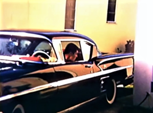

    Hello,
    When we got a 58 Impala new off of the showroom floor, it had a 4:11 Positraction gearing. So, my brother arrived and drove it to our house about 5 miles away. He did not beat the **** out of the new gearing as been described in other posts. He just drove it home with the stock 4:11 Positraction gearing. The teeth and gears will get plenty of meshing and in the normal mode. As it gets driven over time, it will wear evenly.
    No one did burn outs or drove radically to get anything “warmed up.” Daily stop and go driving gets plenty of action for all running gear. But, my brother did drive it normally for a week or so, before he ventured to Lion’s Dragstrip to see how it was going to perform. By this time, it had been driven normally to give everything time to “get settled” and work properly.
    Jnaki
    If in doubt for oil or weight, there are Ford dealers that have gear oil available. The one thing I remember each time I crawled under the 58 Impala on a Thursday night, was the odd smell/odor coming from the Positraction third member when it was draining. To me, it smelled like day old fish and was very thick. I spent the next several hours under the car replacing the stock 4:11 Positraction third member with a complete 4:56 Positraction third member.
    My brother’s idea was that everyone had to follow the rules in racing in the stock cl***. As long as it was listed as a Chevy part and in the catalog, then it could be used in the stock cl***es. So, despite some cars with 3:55 gears, the 4:11 and/or the 4:56 Positraction gears gave us an advantage in the cl*** eliminations. We always had extra cans of the Positraction oil handy.
    But, for the early time we drove places, it was all normal driving. The whole car worked well and without bashing it from the beginning, when it was called upon to accelerate with power, it did that and then some. That “fishy” smell from the oil still stays in my mind and sometimes when we have a fresh fish barbeque, I make sure not to get the aroma of the fresh fish on my hands.
