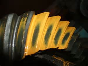

    Setting up a Pontiac Olds 9.3. This is the best pattern I've gotten, however, I have .058" of a shim pack. Is that too much? Does the pattern look right? Backlash is at .010". Thanks in advance for the help. ImageUploadedByH.A.M.B.1428428245.021203.jpg

    Looks like the pinion is to far away you need to remove some shim from pinion.

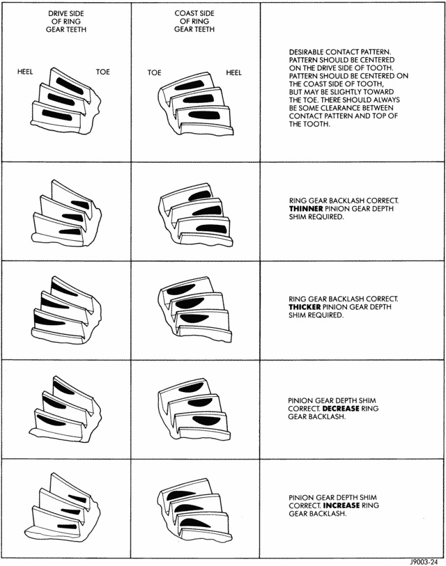

  4. pattern.jpg You want both patterns to "float", unless you are racing

    Thanks for the help guys. This is my first rodeo with gear setup. I decreased the shims to .03" and tightened the backlash to .006". This is the pattern I got, the problem is that I cannot get the coast side to move off the toe no matter what I do. Am I missing something else?

    I would give it more back lash .006 is too tight.
    On some gear sets you may not be able to change where the pattern is located on the ring gear.
    Make sure you put a bunch of load on the ring gear when you turn your pinion to check your pattern and run it a bunch of laps on the gears to check your pattern if that makes any since.
    When I make changes I will use a different color making die to help see what changes I have made.
    I would like to see a better picture of your last pattern.

    Hey guys, sorry for the late reply, but here is where I'm at as of last night. I went back and started over. The pattern below shows a .023" shim with .011" backlash. Looks like it still wants more shim. Any suggestions? Damn coast side still won't move off the toe, I think I'm going to have to live with it down there.

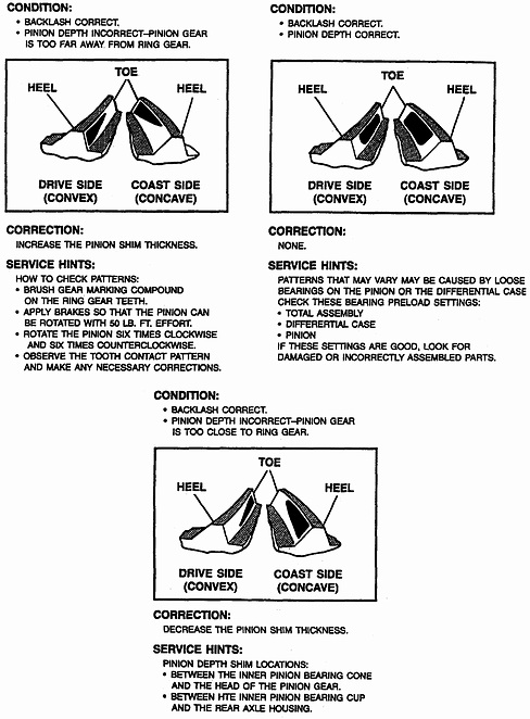

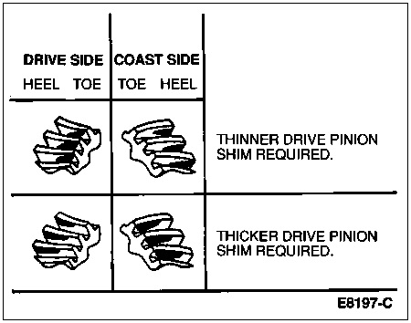

  9. Here's another view point,

    Thanks Vicky, I've been using those illustrations, as the ones in my book are a little limited. Any ideas for moving the coast side off the toe or am I stuck with that?

  11. Looking at your pics, its text book congruent and needing to increase the pinion shim thickness.
    Having a reamed set up bearing makes this a whole bunch easier,

    I do have a setup bearing otherwise I would have already thrown the damn thing through a window already! I'm going to try going up to a .025" shim. If I can happy up the drive side, I'll live with the coast where it is. You can see in the first pics, where the shim pack is too thick that the coast won't move.

    You really need to get the drive side pattern to move down. In order for that to happen the pinion needs to be "deeper into the ring gear" and that's done by adding shims.
    In your first set of pics, I see the back lash off, and the pinion being in the right zip code.
    This is a dance, and just like any other dance it's a series or repeated steps.
