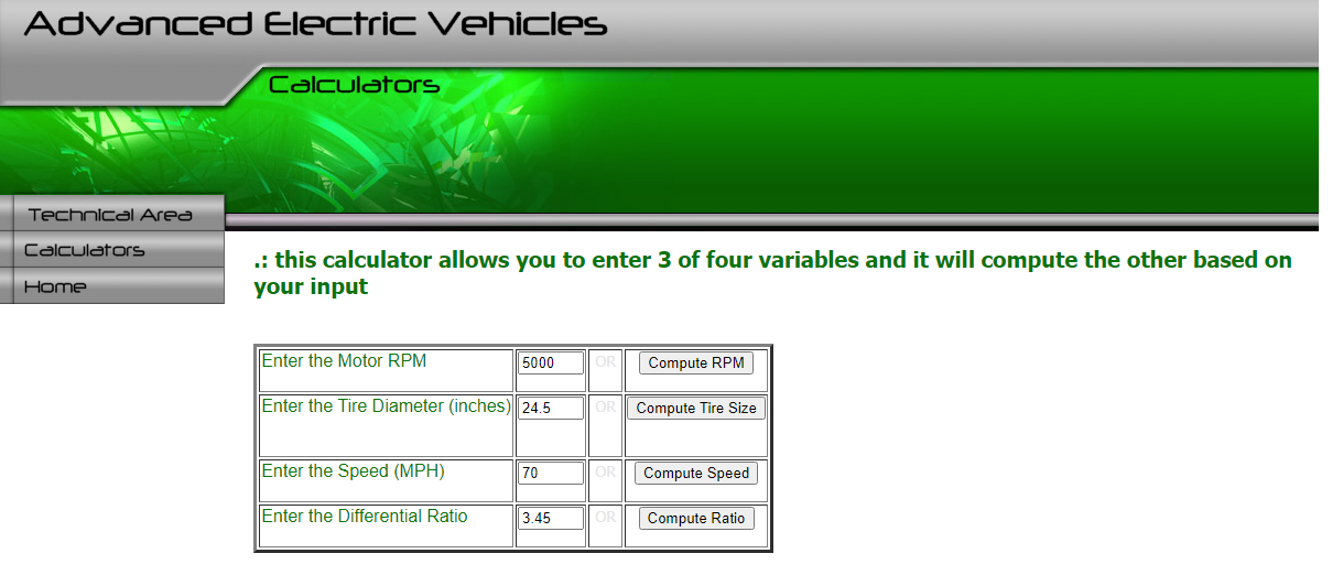

    I'd say that it may depend on how spirited you plan your "just around town" driving to be. Then how large of an area "just around town" encomp***es. Looking at the map you could be in the Cleveland metro area and still be 70 miles or better from the other side of "town". Guys in the LA metro area can be 160 miles from the other side of the LA area which is two states away if you are in New England.
    Still if most of your driving is within an hour of the house and you may or may not venture further once or twice a year what ever gears you feel will give you the around town poke you want are fine. I'd go 3.78 to give me a bit more friendly open road running than 4.11 though.
    Of all the tire size/ gear ratio/ Rpm /speed calculators on the net this electric vehicle one is one of the simplest to use as long as you don't have to stop and factor in an overdrive. For a flathead with a 39 box it is perfect. Tire Size, RPM, Speed, and Differential Ratio Calculator (advanced-ev.com) Plug in any three and get the fourth.
