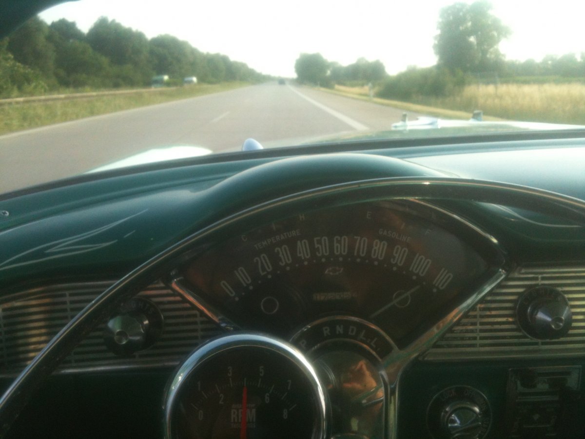

    I have 3.36 gears in my 56 Chevy with a 327, 11:1 cr and a 234/244° cam @ .050 lift with 110° lsr. No OD trans.It really likes to rev and is getting very good mpg between 2500 and 3200 rpm. It starts to wake up at 3500 rpm. That´s were it feels at home.Most likely a mild 283 will be very fuel efficient at around 2500-3000 rpm. Anything lower the vacuum signal is getting too weak and that kills your torque.I´d try to bump up the compression to about 10:1 and use a cam around 216-220° @ .050 lift with 110° lobe separation.A dual plane intake with small intake runners will help, or maybe even stay with the 2 bbl manifold and carb. Depending on your tire size I´d say 3.08 to 3.36 is the lowest gearing you may want to end up with...
  25. gimpyshotrods
    Joined: May 20, 2009
    Posts: 24,522
    gimpyshotrods
    Keep that up for long over here, and you will be doing a little prison time.
    Baumi likes this.
  26. Baumi
    Joined: Jan 28, 2003
    Posts: 3,362
    Baumi
    Hahaha,I know. I never really dared to try that when I was driving in the states, I only had underpowered rental cars, so Iguess I was pretty save...but free stretches of Autobahn without speed limits are getting rare here aswell. Plus as I´m getting older I find myself taking it easier lately,... but once in a while, when someone happens to tailgate me in his late model family sedan or newfangled BMW I allow myself to shift back and show what a warmed over 365 hp 327 can do, hahaha...
    ( sorry for hijacking this thread)
