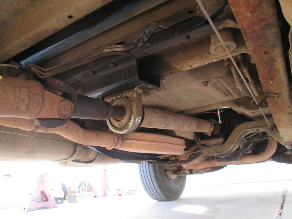

    Here are a few pictures. The driveshaft that is installed in the truck, is the 1980 C20 with the SM465 transmission. It has a spline in the center of the two piece shaft, and a center carrier bearing to support it. The loose transmission is an SM420 from a 1955 Chevy 1 ton, which has a prop shaft parking brake, and a flange on the end of the driveshaft. The loose single piece driveshaft is from a 1/2 ton 56 Chevy with a one piece driveshaft, with no transmission parking brake, and an SM420 transmission. It does not use a flange, and has a slip yoke which is at the front end of the driveshaft.

    I like the photos you posted, a big help! The second from last is what we usualy sees over here.
    When the cup and the needles is over the cross, there only thing holding em in place is grease, surface tension.
    When you mount the flange part, it locks them in place. Does that makes sence?
    The question was, removeing the ubolts result in a) propshaft drops or B) prop drops, and cups and needles fall to the ground?
    And give a numbers of spline and the diameter og the outgoing shaft, from my gearbox, and bam, I got the same joint in both end of my prop shaft?

    You can order splined transmission yokes, like in your picture, for many applications.
    When you remove the straps or U bolts that hold the U joint into the yoke, the driveshaft comes out, and the caps usually stay on the U joint. They sometimes can fall off, but if you are a little bit careful, they will stay in place. It's not a big problem.
