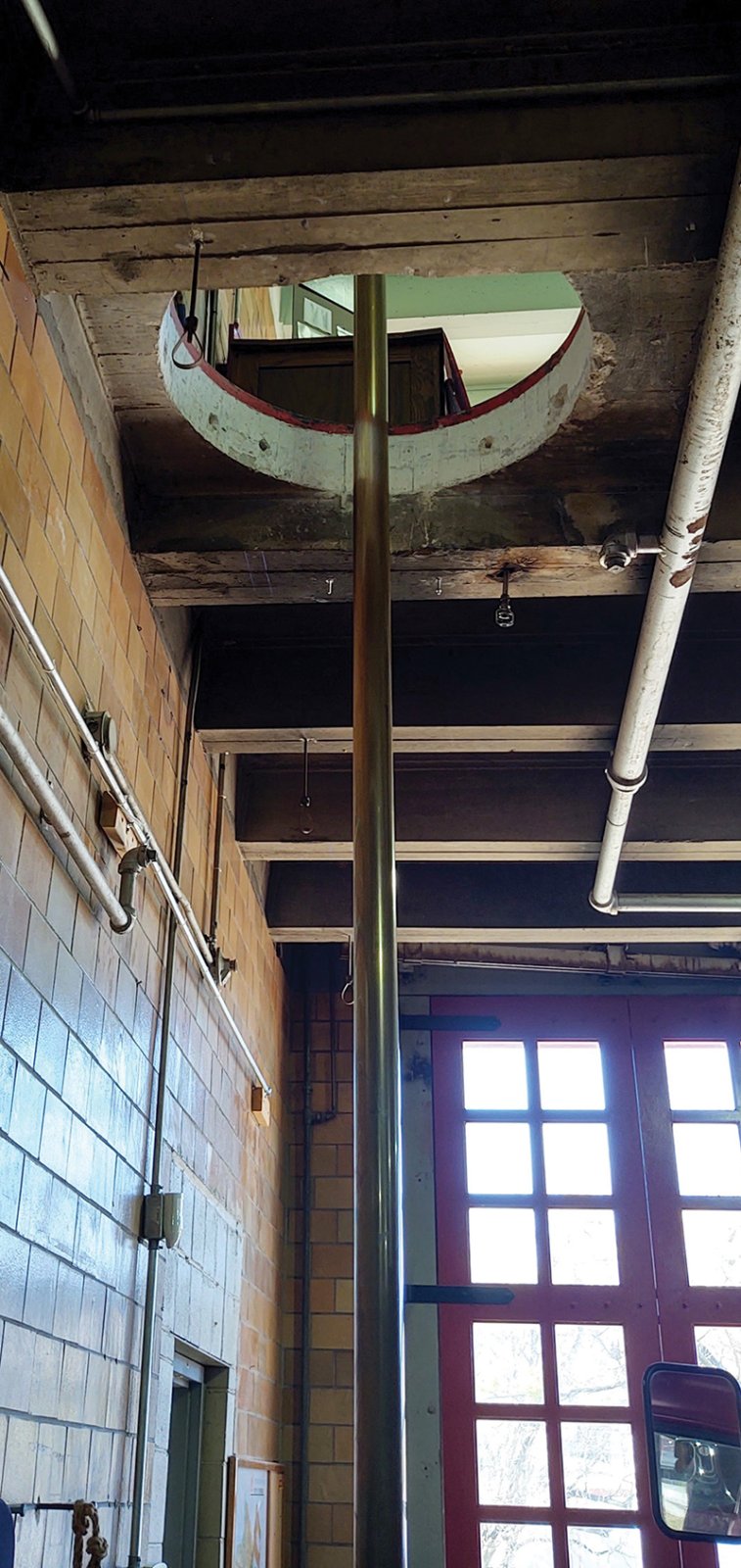

    Getting down from the loft of your shop is easy, just install a fireman's pole in it. FFAM-2022-JAN-FEB-16.jpg

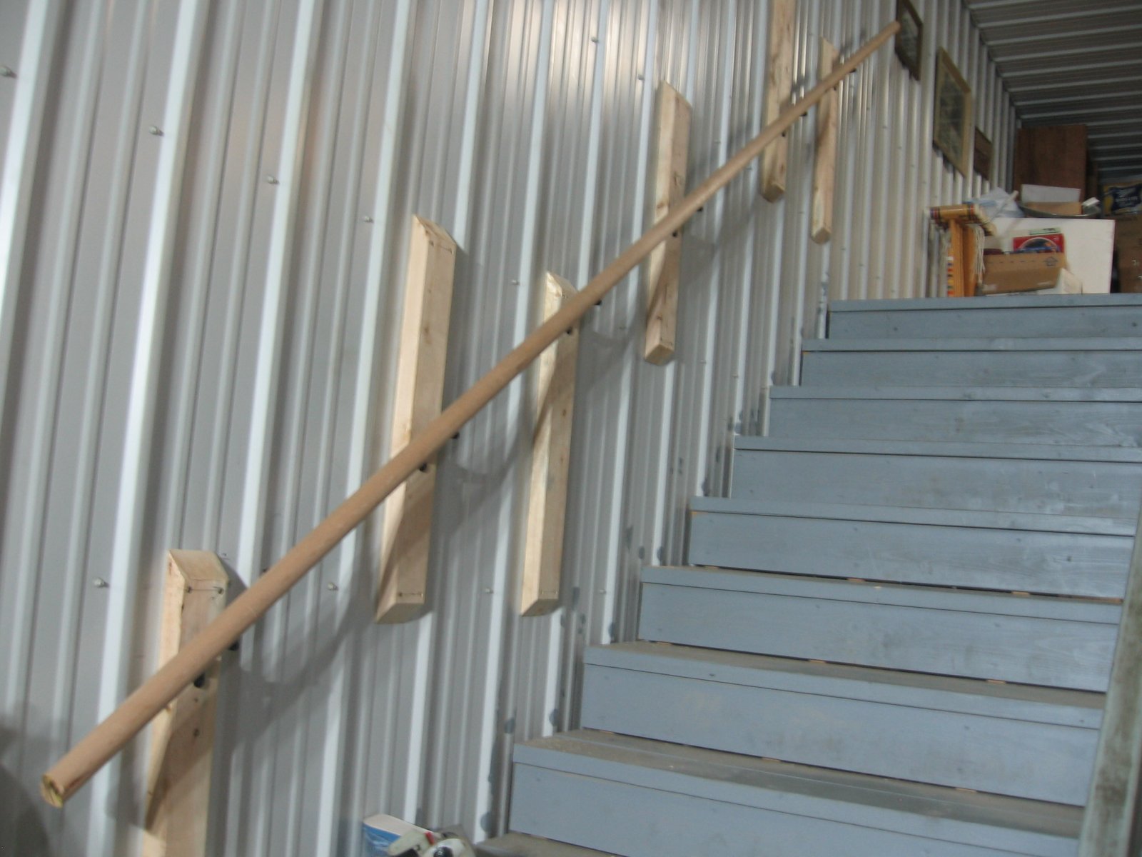

    It's funny, when I was a younger man I seldom paid any attention to handrails. Now that I am in my mid-seventies they are my friend.

    For those building stairs; a friend did his w/half-height treads. & made the stairs at least 4' wide(this also really helps). Since I got to help put in the 2nd floor & mezzanine(+ of course, the main floor in the 16'-walled pole bldg), I asked him why, after helping haul loads of stuff up those many treads. ;( . He said when he gets old(he was 60+ then), it'd be easier to go up than a std height step. & for those still able, it's easier when carrying a heavy load. All true, but he still eventually put in a small hoist to from main -> 2nd floor. Another friend who bought a timber-framed train-station depot(talk about room!!!), dis***embled it, moved & re***embled it on his property, had the std height stair treads, but kept the lift elevator(nice - ba*****t, 1st & 2nd floor use. But iirc, the attic had to be hand carried from 2nd floor).

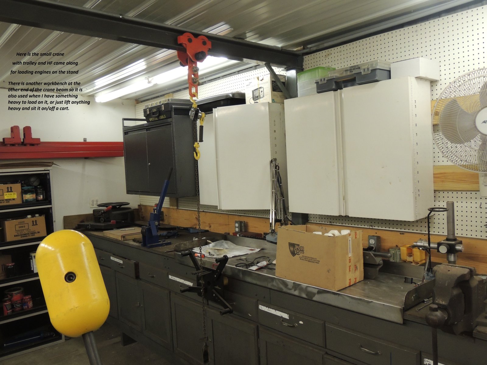

    For those that plan to keep on working on these old cars as long as possible.............
    If you want to be able to do that, remember that not only are you getting older and less able to do many tasks, but your friends are getting older as well and you often will have no one available to help you. While its hard to say "the two tools I couldn't live without are: NAME ANY TWO (Welder and Drill Press ??? or Bandsaw or Vice or Lathe or Mill......) But thinking about it, while I also need all those things, I need my overhead crane and my 2 post car lift.
    I say that because its difficult to get up and down constantly and there are sooooo many things I end up lifting that are far too heavy for me and my friends. Not just engines, but car bodies and frames. So it doesn't do me much good to have the other tools if I can't do the heavy lifting and the ability to get to all the things under the vehicle easily.
    Make/obtain those two items and you will find life much much easier as time goes by, and it will even help you a lot more when you are younger. You just would not believe how handy an overhead crane can be.......never heard of anyone not liking one and removing it. They can be pretty simple to construct and take up almost no room.
    You can also use the 2 post lift to help hold the crane rails if you get one with tall enough uprights......
    Here is picture of how we did my sons shop. He already had the lift. (click on picture so you can see it better)

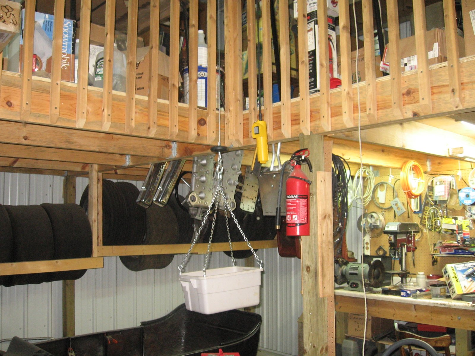

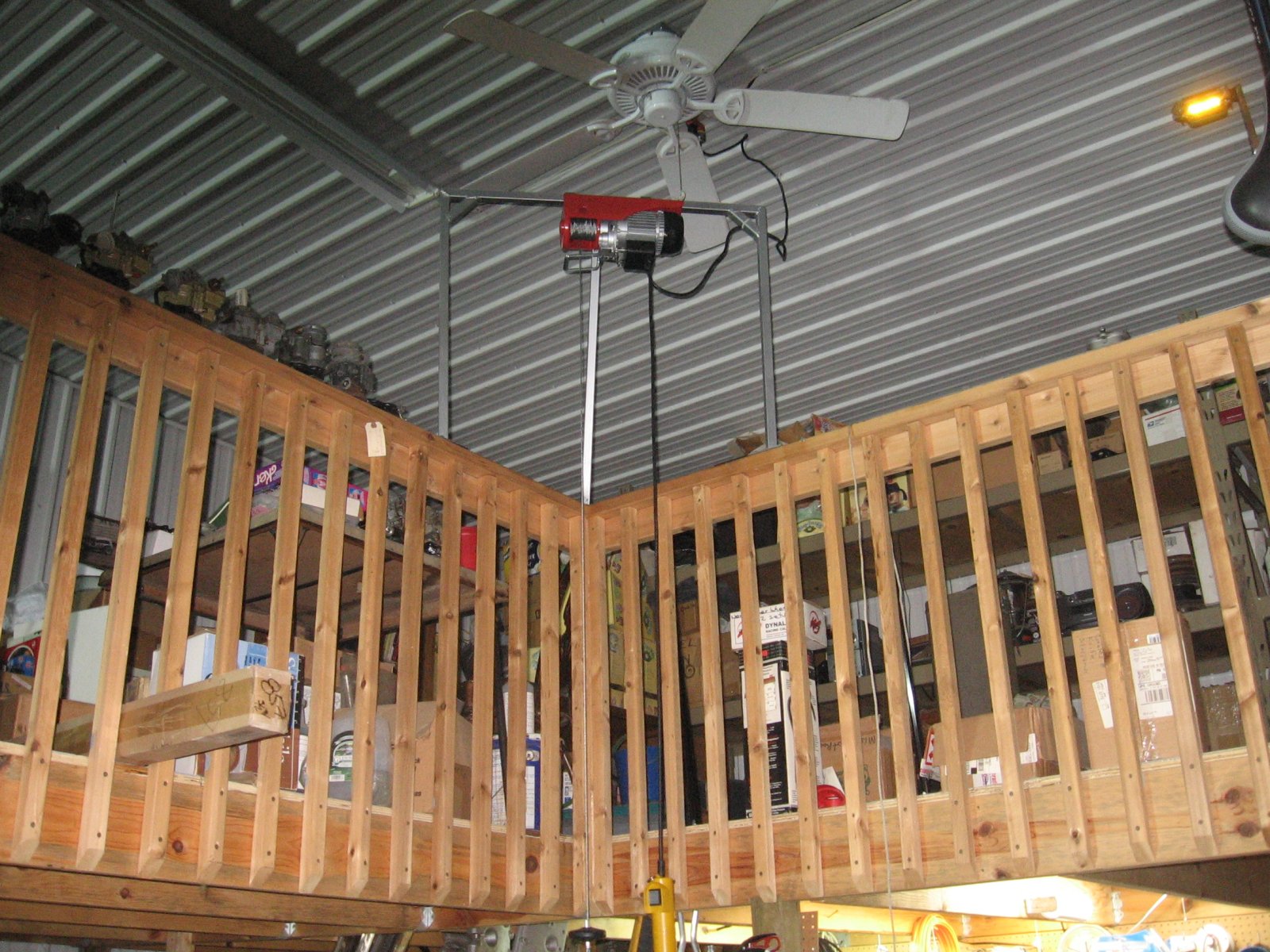

    About 30 years ago I had a friend who had that rail and hoist setup in his garage to raise and lower stuff from the second level and it worked pretty slick. He built it in when the shop was built though. He had built a setup that was more like a small metal pallet with a framework that had a ring that the hoist hooked to to lift or lower what ever fit in it up and down. He sold the place and moved out of the area a few years back though.

    I have the same electric winch from HF in my garage, tubman! It really helps!

    A four post lift and 2 welders...........hmmmm, probably be very easy to support a crane with a little adaption. What I like with the crane and lift set up, as it makes installing and removing engines (especially Hemis) easy. Lower the engine in with the crane and then lift it up to ****on up the underside. Up and down and never laying on the ground...easy peasy :)

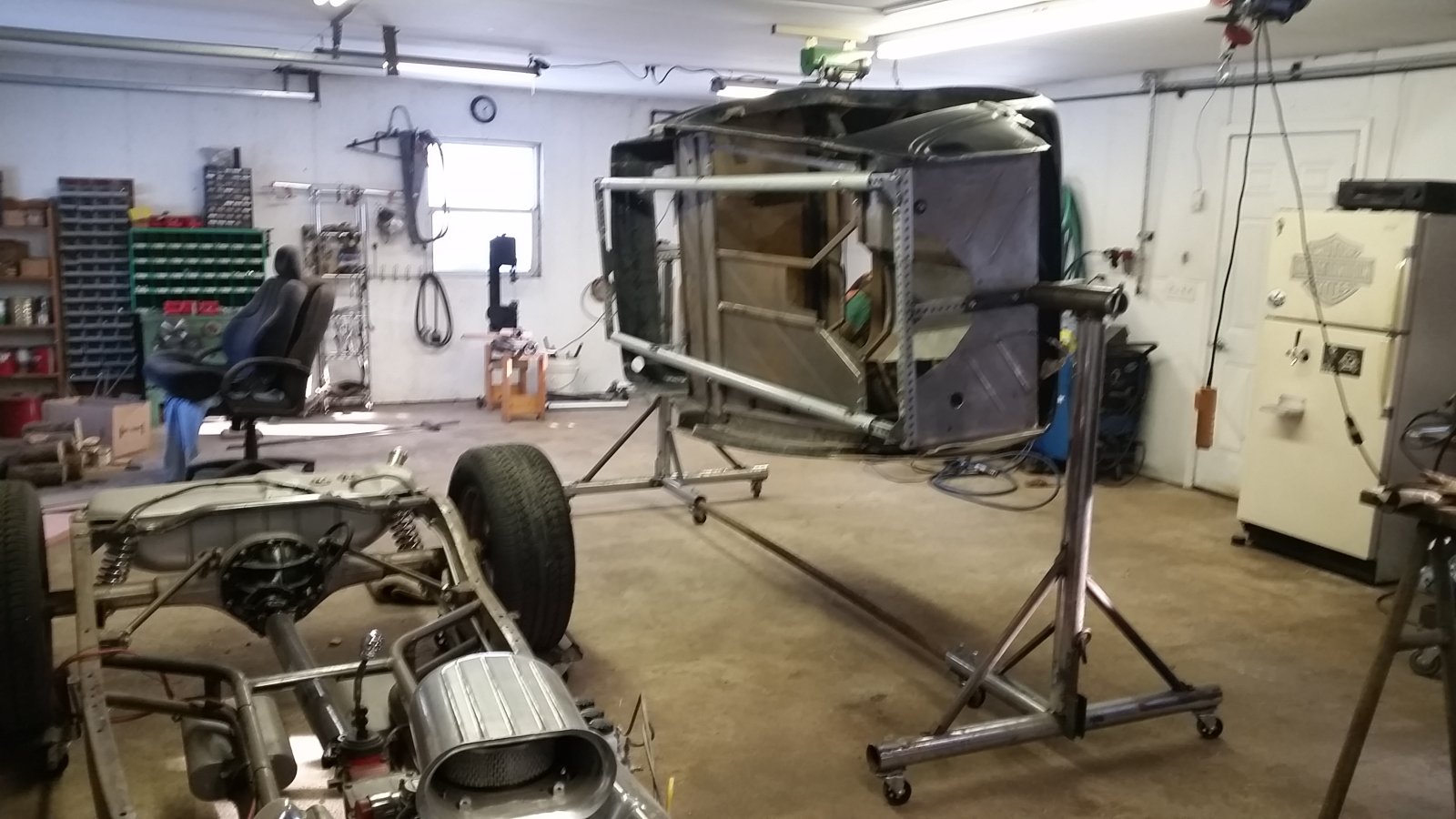

    Something to consider when building is that a taller building will be harder ($$$)to heat in the winter . Best to make a tall ceiling in an area where you want to have a lift (and hopefully a crane) and keep the rest of the building 12' or less. You need about 12.5' to raise many vehicles, other than that higher ceilings don't accomplish much. I'm also a fan of putting a "lean-to" addition on the back or side of a building. Its a less expensive way to add room and the typical 8' ceiling works well. This gives cheap working and storage. I put most of my larger tools on wheels, and roll them into the leanto when not needed. It really works well for keeping my shop somewhat uncluttered and easily usable. Going back to the "crane" thing and geezerizing my shop.........I have an old work bench I built eons ago thats 16' long. I have an old SS countertop over a small portion of it. Works great for dirty parts. Then I mounted an engine stand in it and a brace to support the stand. Again no lost floor space. Over that I added a smallish crane with a trolley. Again, no floor space lost. So now I can take engine blocks or transmissions off a cart and easily set them on the bench in the SS top. Its just a matter of watching for some decent buys on Facebook and cobbling stuff together to Geezerize well. I'm always looking for someway to make things work easier............
    click on picture to see it better

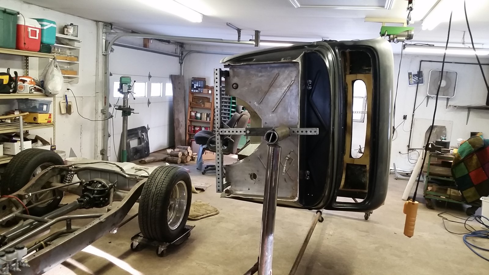

    Years ago I put in two of the harbor freight hoists to lift the bodies onto the rotisserie. Works great to lift the truck box off. I use them to lift frames up onto my taller saw horses. Hoist will be necessary one day but I think it will also be in the way when not being used.

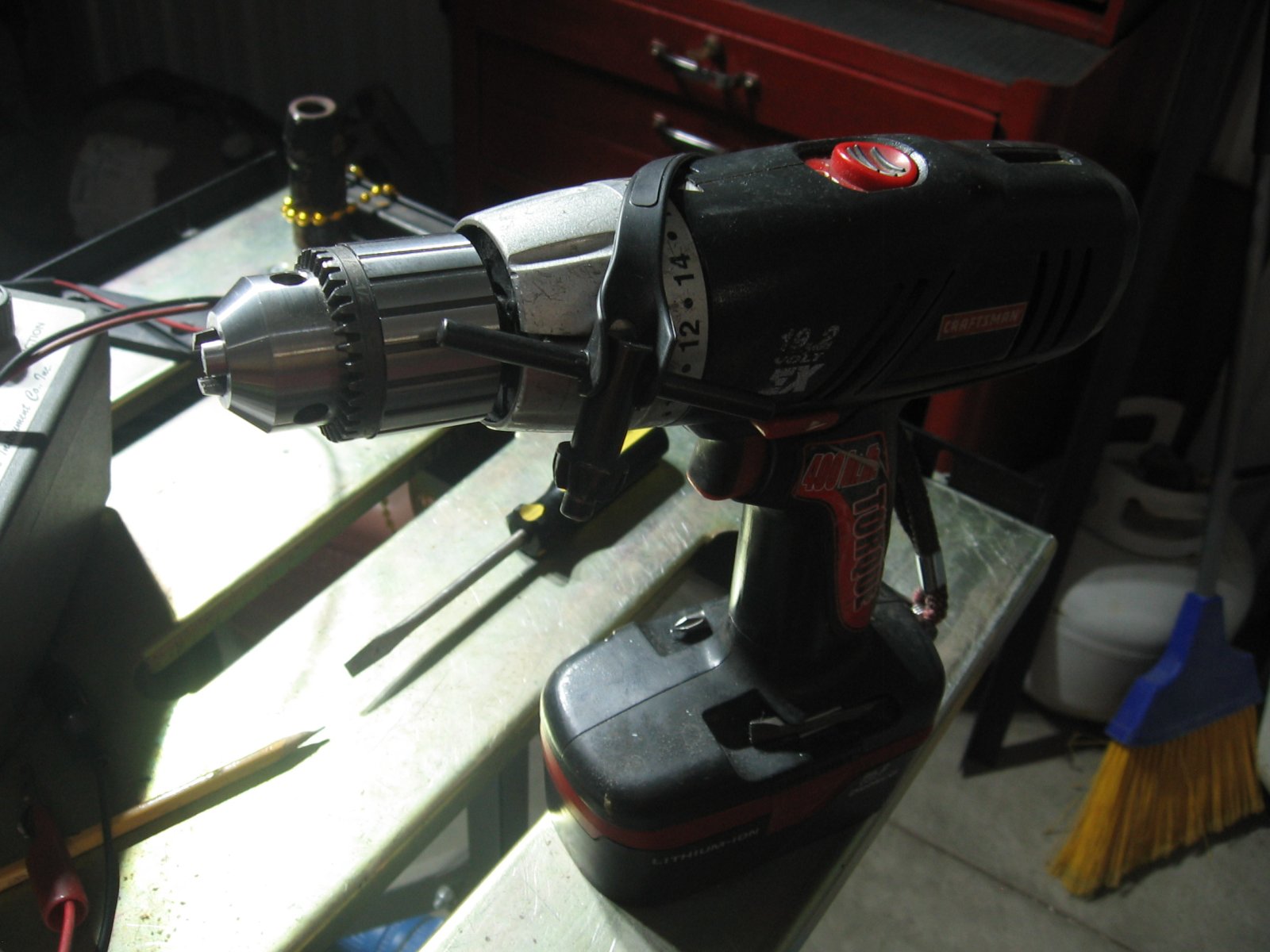

    There is a special place in Hell for the guys that developed keyless chucks, temporary spare tires, and hidden windshield wipers (especially in Minnesota in the winter). This goes way back, but I ain't too happy with the guy who decided to get rid of vent windows, either. (Chevrolet called it Astro-Ventilation on the '68 Corvette.)
