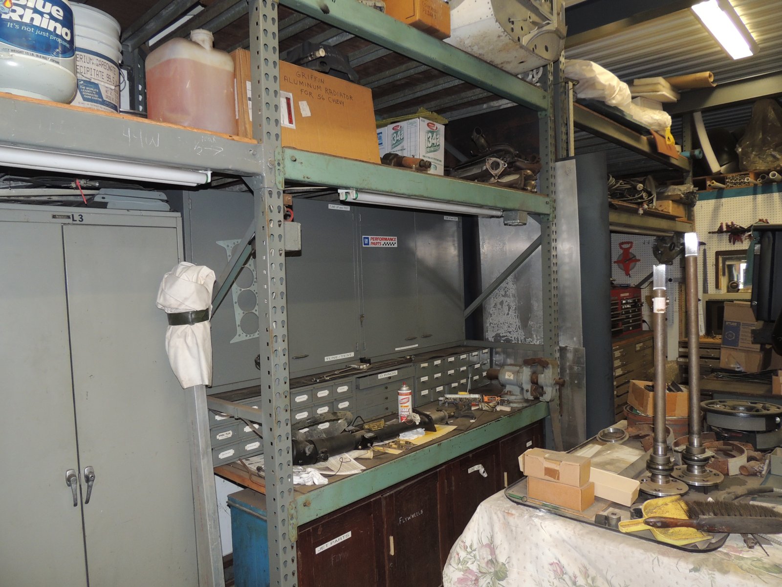

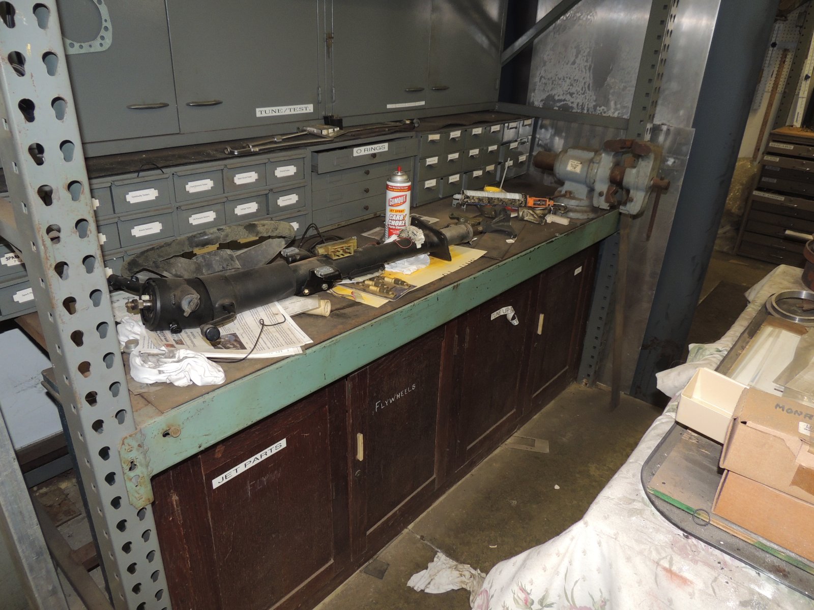

    Use the lowest rack for your workbench. Depending on the length of the Pallet Rack rail, you can make the bench anywhere from about 8' to 14'. Put some wood 2x on the rack and then a steel sheet on top of that and you have a great workbench. You can buy cheap heavy metal cabinets (usually $50) off Facebook. Paint em gray and mount them on the wall and workbench and a shoplight on the rack above. Makes a great workbench.
    I got the wooden cabinet sitting below it for $12 at a school auction. If you want to emulate this, just remember to get rails that are long enough to hold two cabinets or more. This worked out as I found some of those small parts cabinets that also fit well. I consider a little dirt in my shop to be more nostalgic............:)
    Notice also that at the right end of the rack, I can store sheets of steel between it and the next rack.

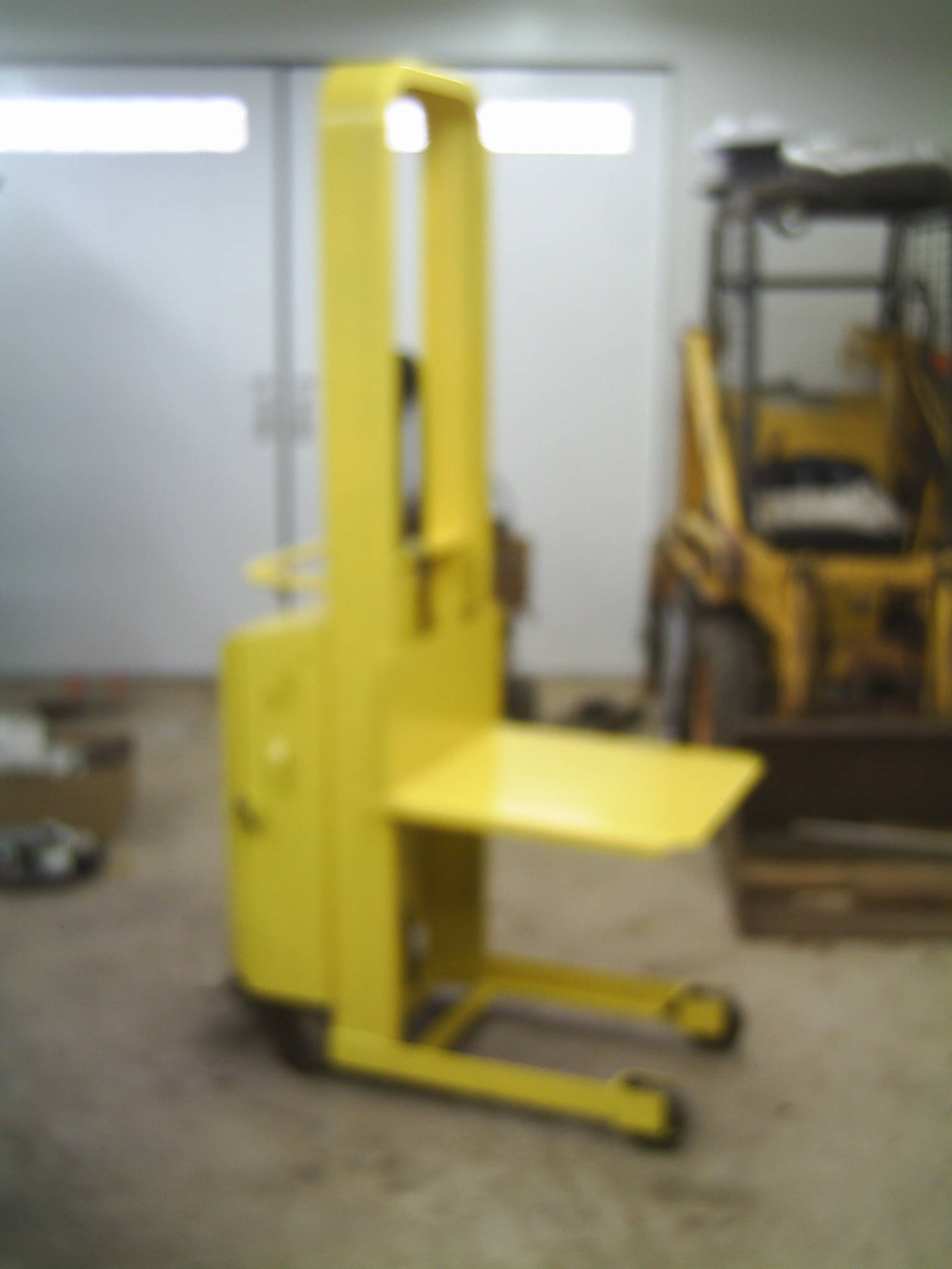

    Presto hyd roll around lift. Rated for 1000 lbs I think. Powered by 12v battery. About 5 ft height +/-. Used it in all kinds of lifting, from the walls of my garage addition build to person [me] lift for electric and hanging lights and other imagined uses. Heavy by itself and a little hard to maneuver but the price was right, Free.

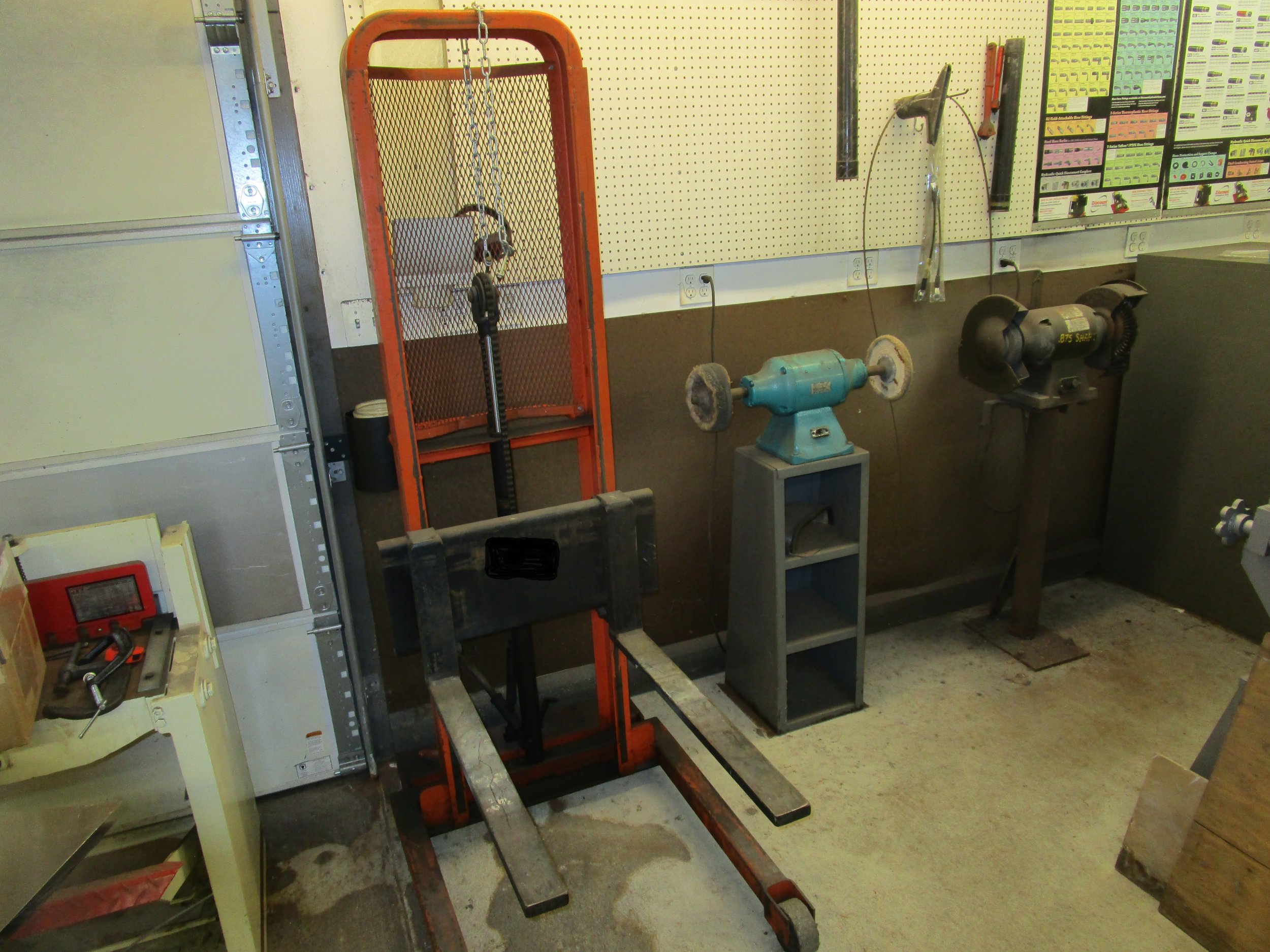

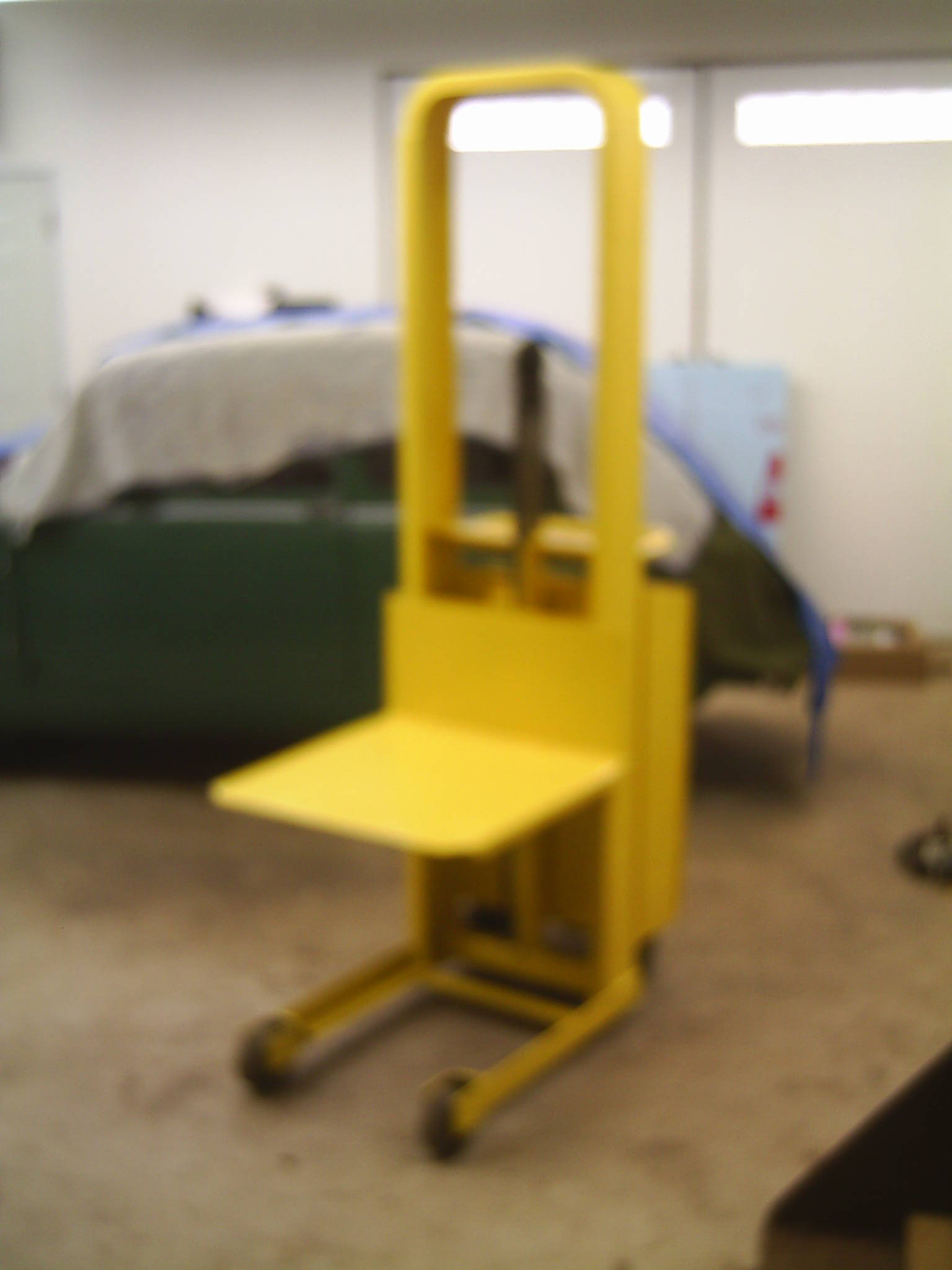

    I like this little manual forklift I have for loading and unloading things as well as holding things up in position (like a rear bumper). When all my other tables are full of "unfinished projects", I have a small (2'x4') tabletop that I sit on it and use it as an additional workbench. I can jack it up if I need to stand while doing something, or lower it and sit in a chair when my back is hurting. You see them come up on Facebook now and then. I like the manual roll-a-round and it has a hydraulic cylinder. That way, no battery to go bad and if the cylinder goes bad once in a lifetime, I can rebuild it pretty easily.
    Here it is with the table top which I can roll over to the shop "loveseat" and sit while doing some task. Its handy..... I just finished sorting and organizing a drawer full of Allen Wrenches that I picked up somewhere. Had to check sizes and sort them. One thing I found out was that they are not perfectly sized.......so when you get an allen wrench and it fits loosely....thats probably why. I decided I would organize them according to size......meaning the next larger size is in the next slot......whether its Metric or American. Then when I get a loose fit, I can see if the next size fits better. Makes it easier to determine if you are trying to remove a Metric or American Std set screw. Some of them are pretty close to the same size. Did you know there is a .030 Allen Wrench ? Its handy for cleaning finger nails..........:p

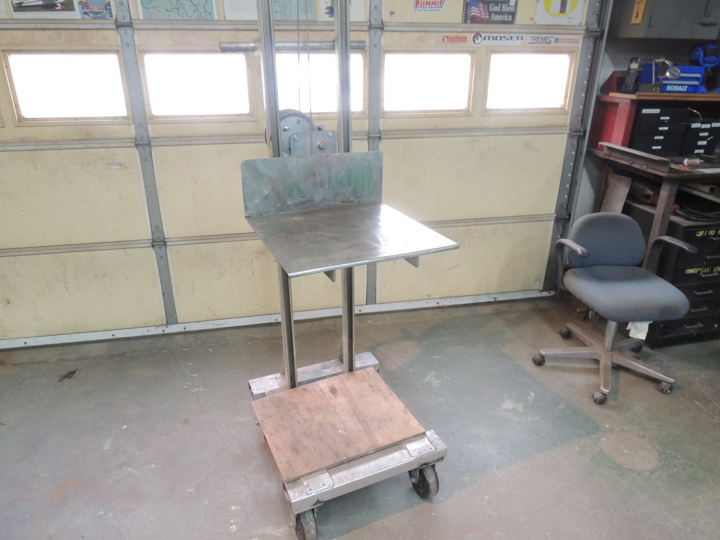

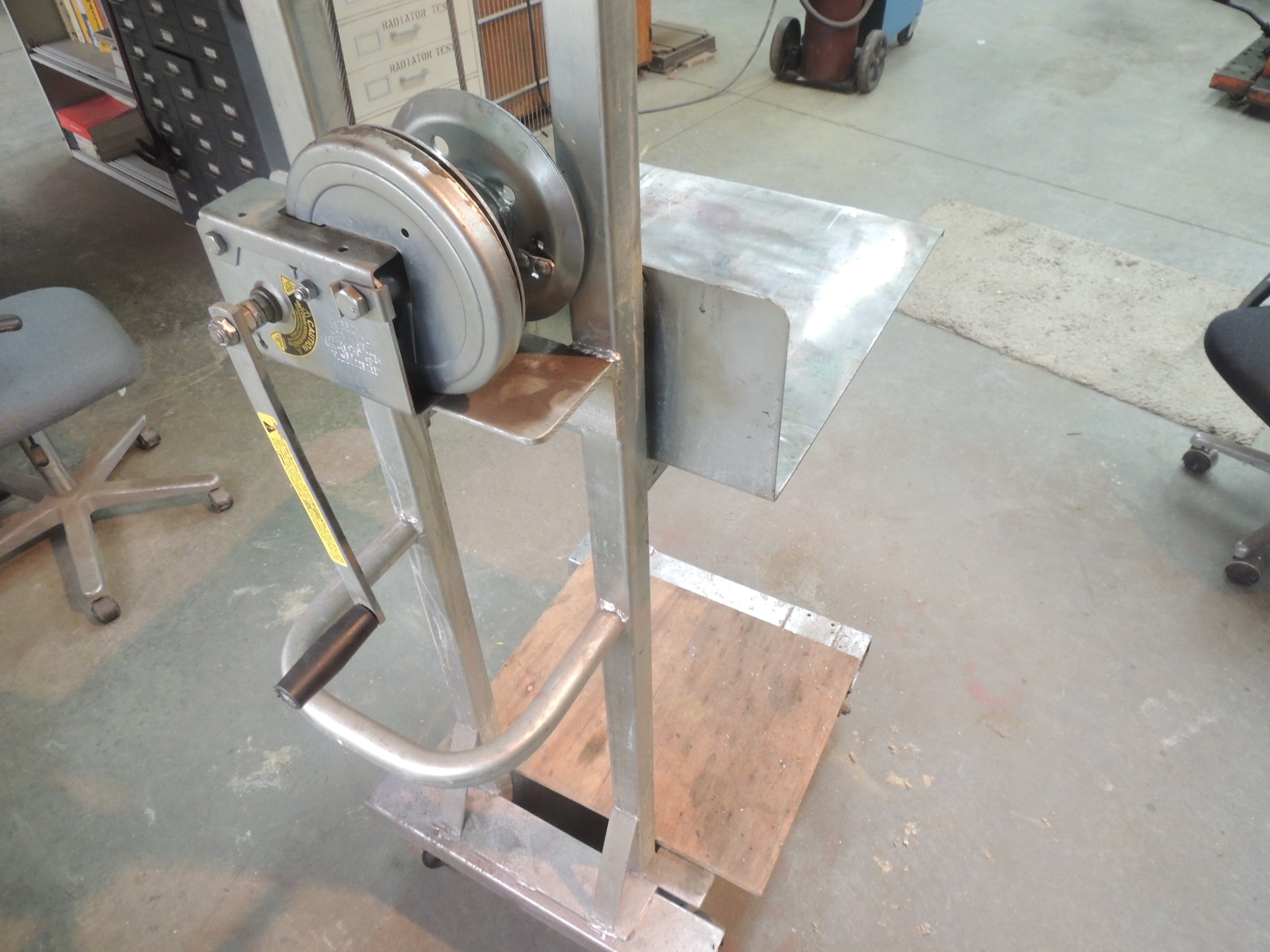

    Here is another lift I picked up at a school auction. It cranks up and down and again, can serve as a work table next to whatever I'm working on. Roll it up next to a vehicle when working under the hood and you have a place to sit all your wrenches.....at a perfect height for that vehicle. Holds a transmission pretty nicely. I'm telling you, these things just don't sit against the wall in my shop....they get used regularly. The trick is watching Facebook till a cheap one shows up.

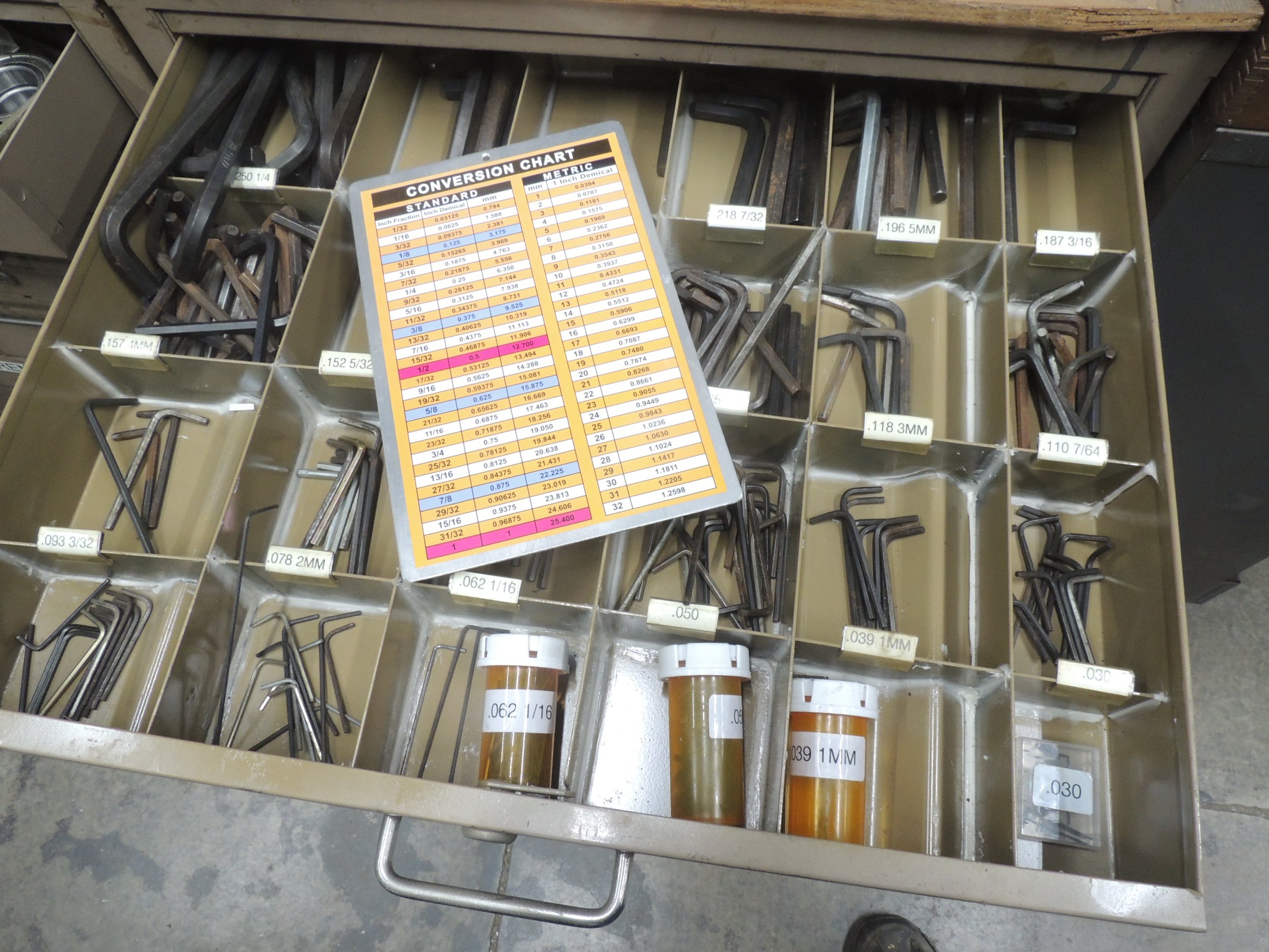

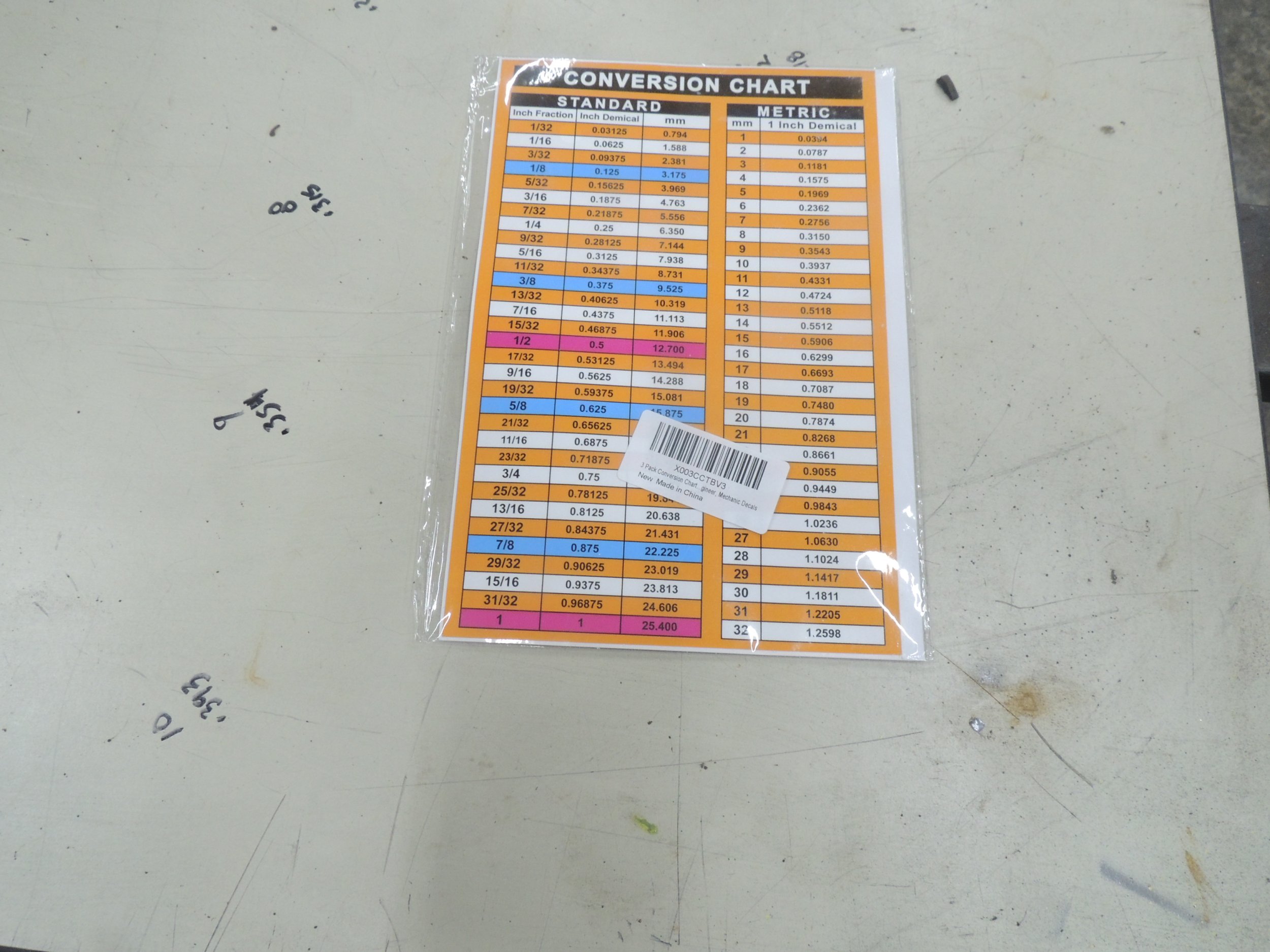

    Here are the Allen Wrenches....all sorted out. What I want to recommend here is that everyone go to Amazon and order a pack of these adhesive charts. They are cheap and you can stick them next to your drill press. I took one of them and put it on an aluminum plate and set it in the Allen Wrench Drawer. You can see when Metric and Standard are close and choose one from your Allen Wrench holder. Good next to your drill press as well.

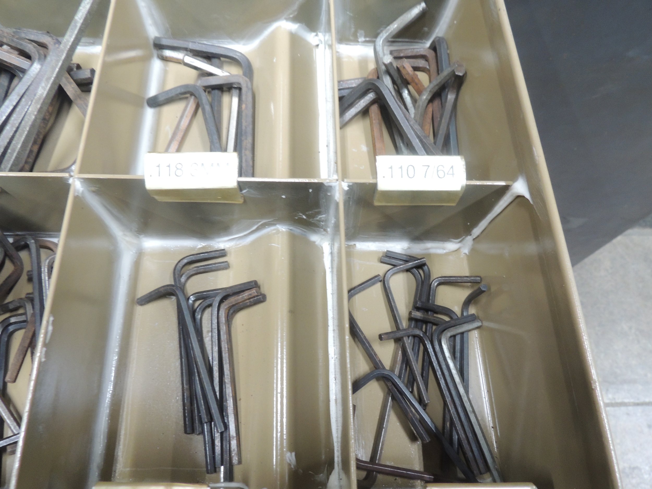

    Little hard to read, but this shows a Metric next to an American Std and there is only .008 difference. Given that they all are generally on the undersize side of what they are labeled, that 3 MM (.118) may fit better that the 7/64 (110) you are using.
