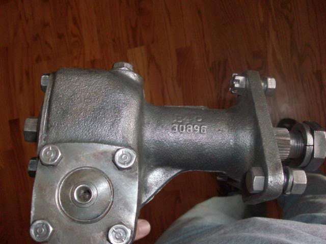

    hi every one , I think I may have found a steering box that will work for me ,here is my question I can only find one set of numbers ,they are 30896 ,I googled it and can't find much out it looks simuler to a 57 f100 box but a smaller mounting flange ,so what is it can a guy tell by the numbers ,thanks fella's

    That's a F-1 box!

    I have to agree , that is an F1 box

    f1 box is as good as an f100 as far as driving goes, but your original light switch will be very near dragging on the road if you plan to use it. f1 sector shaft is above the steering shaft, f100 sector is below, putting the switch right behind the frame rail, not below it. model a build, right?
