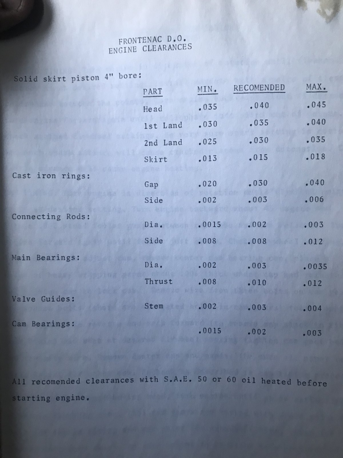

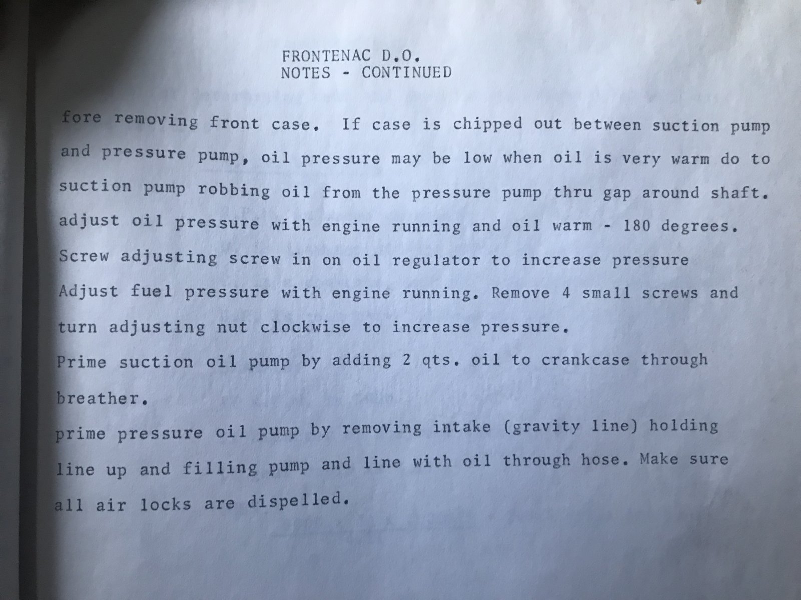

    A85FBE11-2B33-42B0-BB40-CEDBF92B3758.jpeg 0A36AEBB-33D0-43DA-A3DE-F1CE996F7A71.jpeg A8361DA9-7E64-44AF-985B-1AF56CA33FA9.jpeg ECD087F2-6E97-420C-BAF9-8340929BF105.jpeg 4BE58F30-B900-4518-9411-C67BF979F953.jpeg 1F7F8FCA-4AC1-4417-84BF-EA4649830D32.jpeg 27D994F0-A04F-45BF-979E-B234FD4F1B02.jpeg 8BEA73E1-36DF-403A-BDE0-C92067B73AA9.jpeg 81BCFA6F-92B6-456C-9BBA-3CABC8DAF422.jpeg 88C60F2E-DE66-4F6D-8C3E-995B9BC9D1E9.jpeg 1D841327-DB97-497F-AB0F-4D7EC84F32D6.jpeg 24D49B3D-1F59-494C-BC25-AB478908AA4B.jpeg I’ve cherished some personal effects of Joe Gemsa for many years and I’d like to share this rare info with the interested. Have a great weekend!

    Thanks immensely for this HudsonJoe, not many men in this world no how to set up the cams on a Stagger valve.
