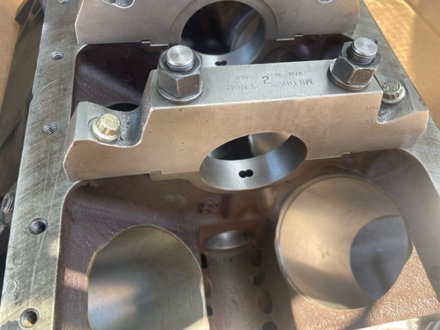

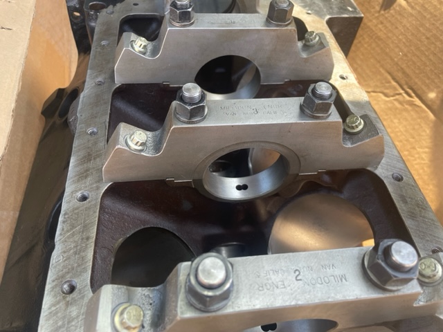

    For the early Hemi tech gurus. Just wondering if there’s any information on Gene Evans. I just picked up a race prep’d 354 that was suppose to be one of seven blocks he prep’d for alcohol top fuel. Just wondering if there some background out there on his work.
    Gene Adams

    Here’s a couple of pics of the block
