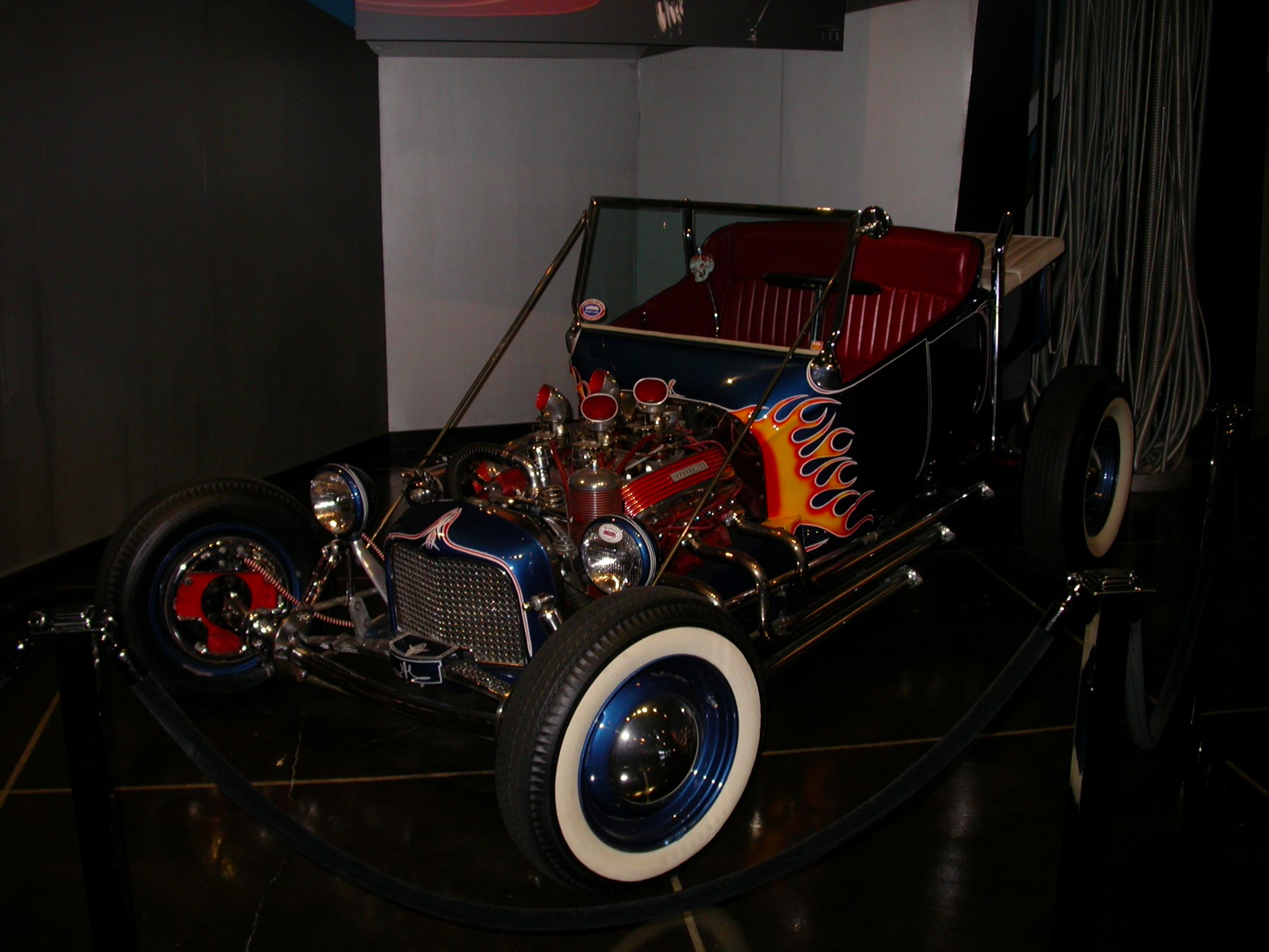

    Thanks for posting those ANDEREGG. I always enjoy looking at traditional rides and I have had trouble finding all the thread.
    I couldnt agree more the info has been really good and educational on this history of Gene Chans car and really of the rods of that time.

    The stacks on the carbs on Gene's car was a special top plate sold for the Stromberg 97 carb called a Scott top. To be honest with you, if your going to stick with the small block four barrel keep it simple thing, I don't think that I would go after the stacks kinda deal, and look instead for a cool old style scoop (Ivo scoop?) or a cool air cleaner instead. The stacks just won't translate to the four barrel that well. Start looking now for 97s, and pick them up when you see them and can afford them (I have three right now That I picked up at the ruins of an old gas station in Franklin, AZ. Between them I can make two usable 97s) Then when you have enough to put an induction system together, start looking for a manifold to take as many as you have or want. Unless you have unlimited money, this stuff gets done in baby steps.

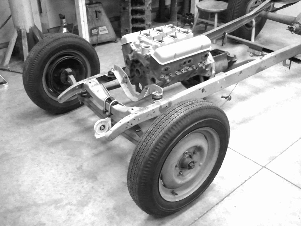

    Again I can't stress swaps enough. Friend of mine just bought an unused fibergl*** T body with turtle deck at a swap for a couple hundred dollars. T bucket stuff is plentiful at swaps and they are a great learning tool. You can't be around the stuff without learning a lot. **** I'm almost 70 and I still learn something at every swap I go to. Just google auto swaps in your area.
    Some inspiration.

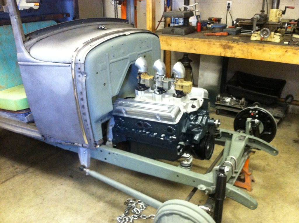

    Kinda look like Strombergs with Scott tops on them.

    283's are cool. I have one. Here it is with 2 different intakes, a Fenton 3x2 and an Offenhauser 6x2. Put a cool one together and sell it one day to finance the hemi.
    I would pick a good looking rear axle though. Whoever said it will be on display out back is right, will stick out like a sore thumb. I know it's your first build and the S10 rear would be an easy solution but you can't take easy street the whole build, lol. How about an early bronco 9"? Would handle the hemi power too.
