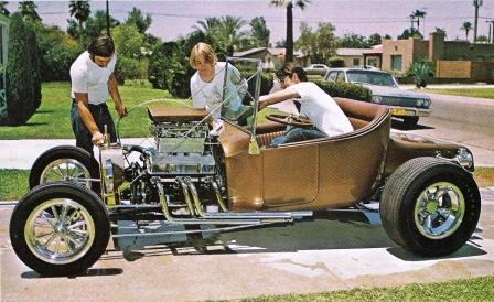

    here's another you might like! This was always one of my favorites.

    That is one I have saved in my photo files and it is one that I do like and really like the look. I say that is late 60s early 70s.
    Great looking Bucket got any info on it?

    That belonged to my late friend Mark Niver, and the dark haired guy at the front is my buddy Dave Hill. Even more ironically that picture was shot about 500 feet from where I'm writing this now in my neighborhood.

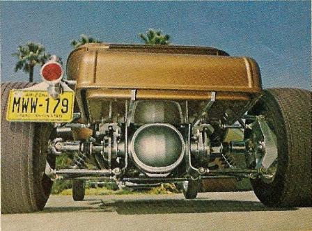

    Mark was a master machinist and thinker beyond the relm of comprehension. I honestly didn't know him super well, as he was always away running his Top Alcohol dragster, (the same one that unfortunately killed him about two years ago). This car was absolutely hand built from scratch by Dave (who has been a buddy fro about thirty years now) and Mark in a small rented one stall shop about a mile from my house in '72 and '73. Of the many cool things on this car, one that wouldn't be considered H.A.M.B. friendly would have to be the hand built I.R.S. based off of a Ford 9" center section. It wasn't done to be trick, it was done to be cheap! The car one best engineered at L.A.R.S. in '74, and the picture of him getting his award is a regular who's who of my buddies and mentors in this deal. He sold the car locally in '76, and the subsequent owner painted it in a neat yellow/orange fade and called it "Tequilla Sunrise", and it was featured in Street Rodder in '78 or '79 or so. It still exists around town.

    that cool rear!

    Very cool and I would love to build a rear like that if I had the skill.
    Louvers thanks for sharing that story and sorry to hear of your friend. Would love to know more and that is a great looking car. I saved that one to my file a long time ago it's really good pic and great looking bucket.
    What color was it originally?
    It really is I would love to know how he did that with a 9" rear? Makes ya think what could you do with other rear ends if you have the know how to do it.

    You could do basically the same trick with any rear that you wanted too. The thing is you better have a pretty well tooled machine shop at your disposal, as paying someone to do this would get expensive very quickly. Mark had wanted a Jag rear end, as that was what was hot at the time in T-Buckets, but couldn't afford one. He narrowed a 9" down until it was just the center section and two axle bearing flanges, took two tapered big car axles and cut them down to fit the housing, machined most of the flanges off the ends to accept a U-joint, built what amounts to two drive shafts, built bearing carriers and cut two more axles for outer drive hubs. Easy? let's just call it and advanced machinist operation!

    Yeah something I wouldnt be able to do lol but it looks really great. Did any other guys back in the day do this or attempt it?
    I really like the jag rears in T's myself. I found one with a 350/350 chevy in it but the guy was asking far to much.
    That rear looks super clean and very cool.
