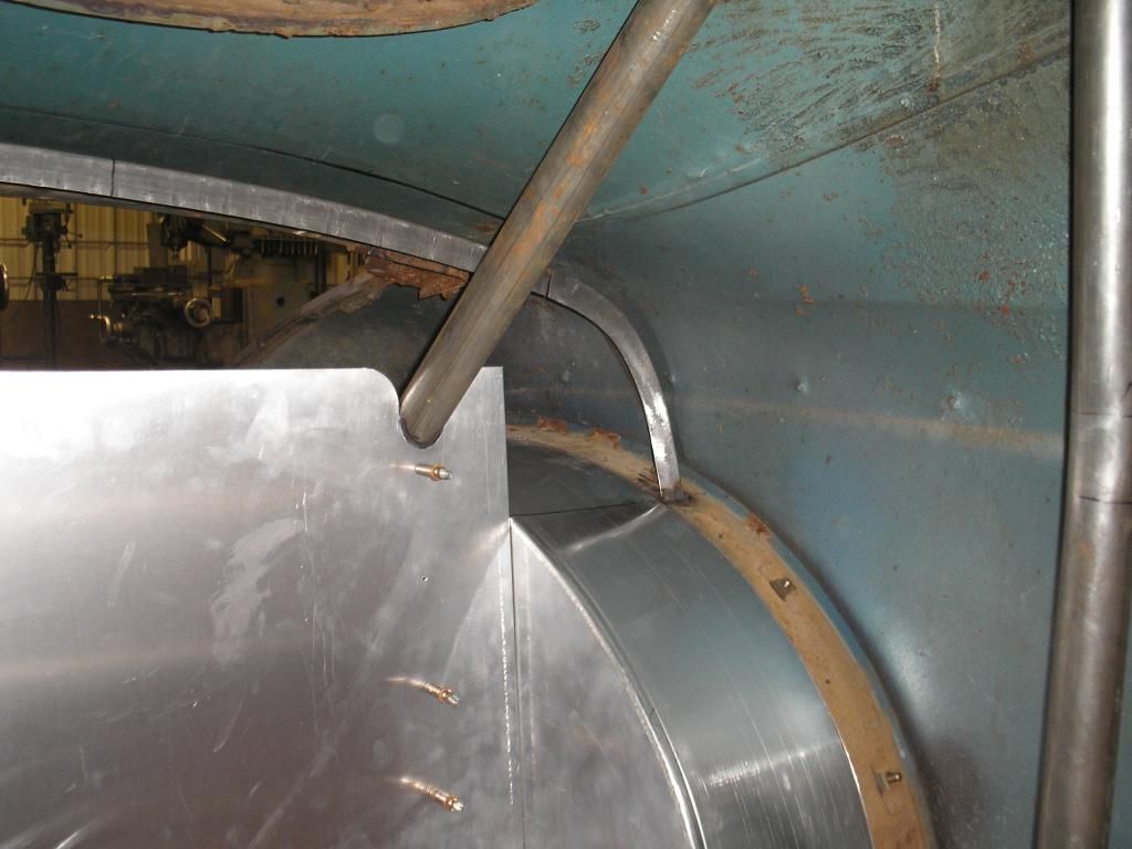

    I had to make a new panel for the alumn. trunk pan to bolt to the old one had been cut out. It's welded to the lower rear panel I rounded it like the rear panel and then turned a 5/16 lip down for strength. It's hard to see in the pic just look for the new metal. You can also see the old dzus fastener tabs that held the trunk lid down.[​IMG]
    Mtn Goat and kidcampbell71 like this.

    The new alumn. trunk pans are ruffed in. The old original rivet holes were in the frame rails that was the clue that I needed to make the trunk pans just like they were when the car was built in 1963. The brakes are in the same places and the same angles. The battery box is the original and sticks up through the trunk pan just like before. I did weld some threaded bushing to the side of the box for battery hold downs.[​IMG]

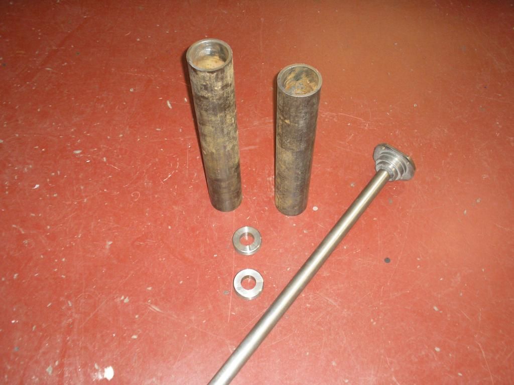

    To install the axle tubes straight I have an old third member with alumn. bushings in place of the side carrier bearings with a 1 1/2" hole through the middle. A lot of ya'll know how to do this sort of stuff so if I'm getting into to much detail let me know. I left this part of the build off of my willys build thread so here it is for the ones that care.[​IMG]
    Mtn Goat likes this.
  26. Quain Stott
    Joined: Nov 21, 2006
    Posts: 2,068
    Quain Stott
    The shaft, bushings, and new axle tubes they are 3 1/2 by 1/4 wall seamless tubing should hold anything that ford engine can give it.[​IMG]
  27. Quain Stott
    Posts: 2,068
    Quain Stott
    The bushing go in each end of the tube then the 1 1/2 bar slides through them then into the bushings that are in the third member that's 4 points it's got to be straight now.[​IMG]

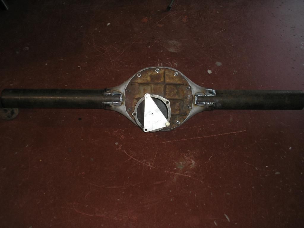

    Now you can see what the notch is for I run the tube as close as I can to the side carrier bearing there will also be more bracing inside the housing to the end of the tube. This is the area where the stock housing flexes the most.[​IMG]
  29. Quain Stott
    Posts: 2,068
    Quain Stott
    All welded up always tack it good in several places then take the bushings and bar out the welding will warp it a little and the bar won't come out then it's all junk. leave the third member bolted in so it don't warp in this area.[​IMG]

    The back side, I may fill the notch with weld then grind it down so you can't tell anything has been done to the housing. Remember the best ch***is in the world is no good with out a good rear end housing.[​IMG]
